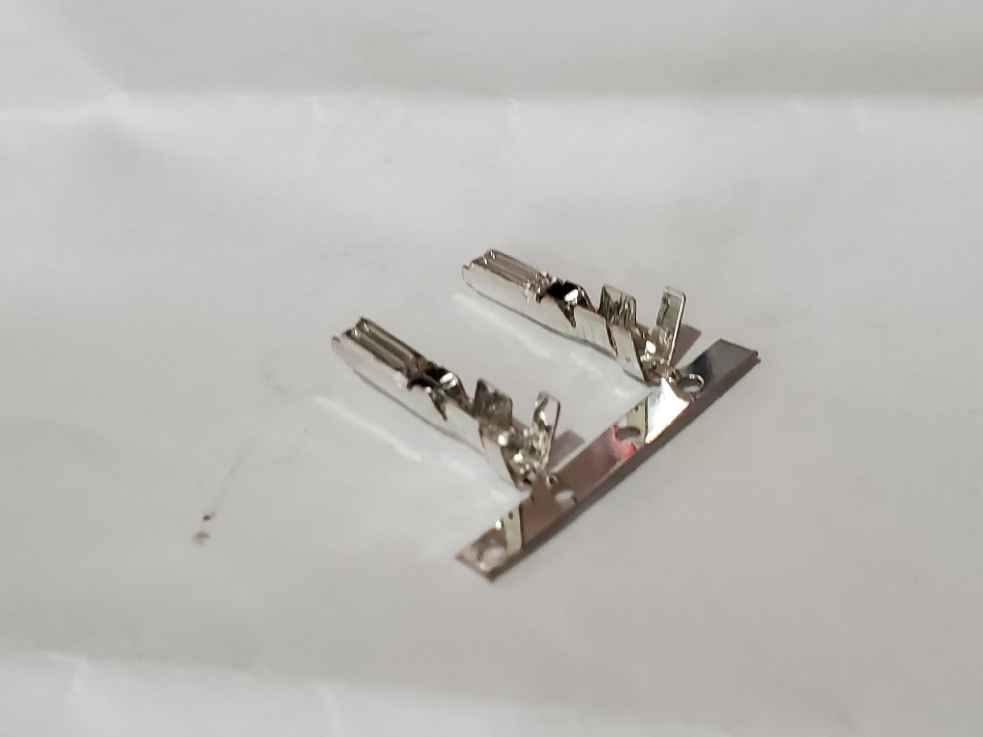

I'm installing the turn signal relocation kit on my '17 FXDB and I need to crimp some connectors. I've never had any luck with this style of pin so I'm looking for some help. What type of crimper do I need? Is this a Molex pin? Can you guess a size off the pic with the beer can? This is for the 3 wire turn signal connectors.

pretty sure its a molex. as for everything else not so sure sorry. good luck!

Yup, those are Molex.

Check out this post by mud for his home made crimping tool...

Actually, those look to be AMP / Tyco / TE Connectivity "Multilock" Connector Terminals ... Not Molex (Brand)
Can i use the same kind of crimper?

Granted this is only turn signals, but I would solder them.

It`s a crimp connector, obviously it is designed to be crimped. Solder is not the way to install this connector.
You will never see a solder joint on an OEM connector. A proper crimp is the best way to install a terminal to a wire.

I’m making some harnesses, and bought this on Amazon, and it works well. I’d use this rather than any other option that will scru it up, There’s a reason Harley selected Molex, which are the best you can get. Don’t scru up your reliability by cheaping out for $20,
IWISS Open Barrel Terminal Crimper Plier Tool for Molex Style DELPHI AMP TYCO Terminals Crimper Open Barrel 24-14 AWG

BTW, if I was to buy a used car or motorcycle and saw that someone made hack job electrical modifications, I’d stay clear.

If I was wiring every day I would want that $35 one.
That $17 one looks like it works fine.
