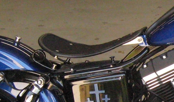

Mounted somewhat high in front to some but slopes nicely to the middle and about as low with springs as some seats mounted with spacers.
With a pull of a push pin I can also access the wiring harness under seat.

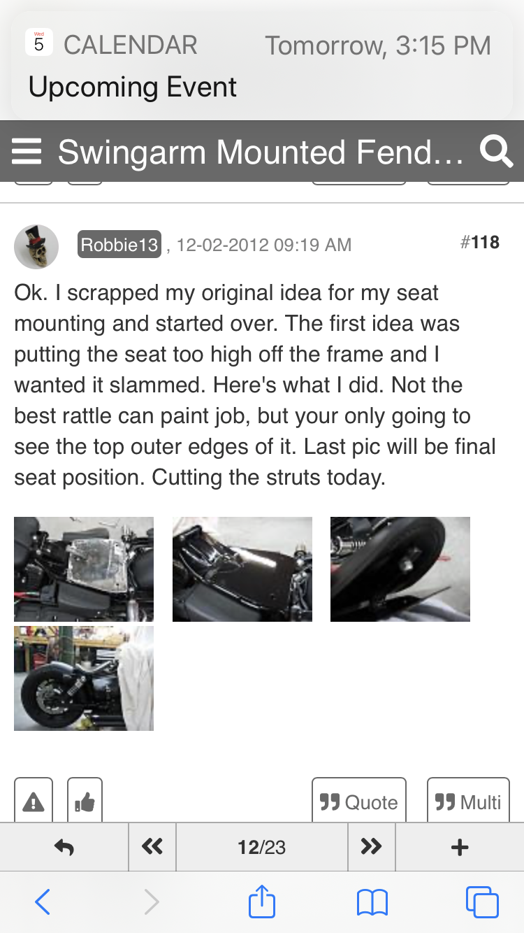

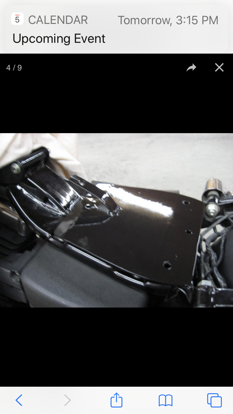

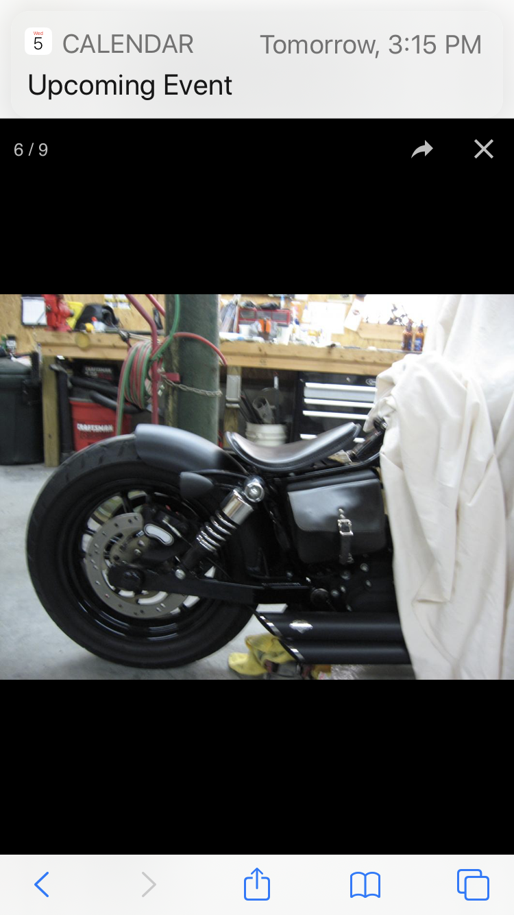

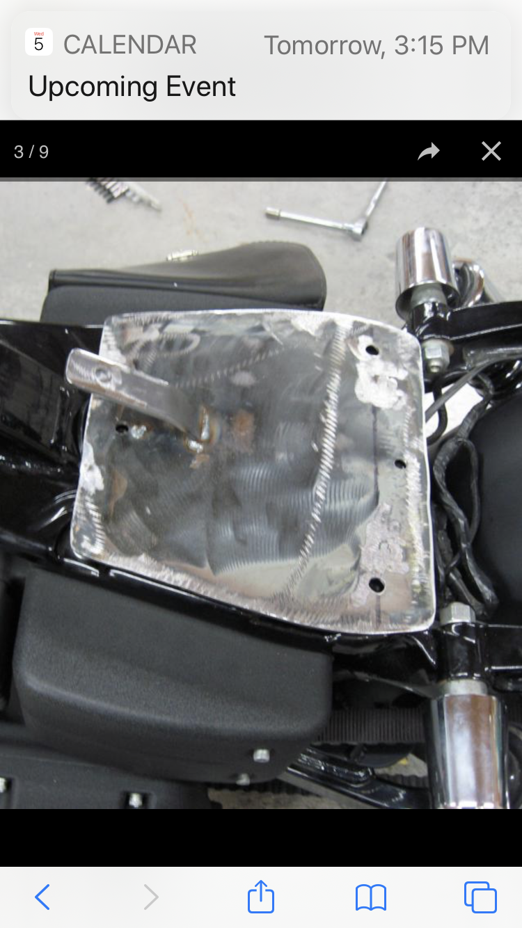

Ran across a very old thread (2012 I think) , a member (Robbie13), fabbed a very cool base plate and mounted his seat directly to the frame without any springs. I'd like to know how the rear of the seat was attached to the frame, or if it was attached at all. What do you think?

Probably just screws from underneath. Looks like there is room to to get them in and out.
The seat looks like a Redtail...probably the 12" Plain. Same one I have/had but with the standard mounts. I had custom mounts made.

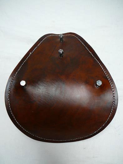

So you think I'd be able to run bolts up through the base plate into the bottom of the seat?
Use 2 of those 3 holes to run the bolts up through from underneath?

That's my best guess without having measurements.
I know Chris at Redtail is real good about answering emails and taking custom orders. I don't know what his fastener locations are but I'm certain he would tell you. Hell, he may even have mounting ideas or setups already in place.
