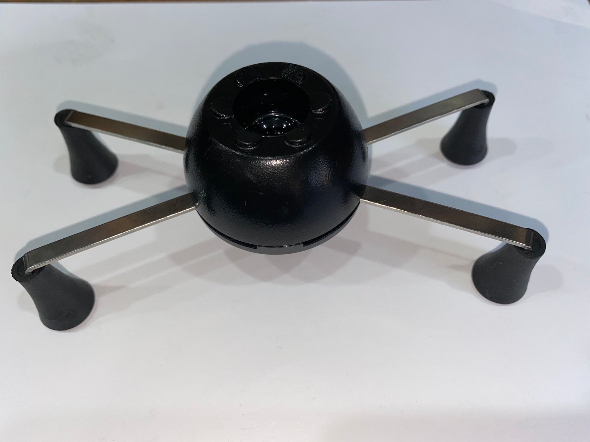

First, part of the Ram Mount I am using:

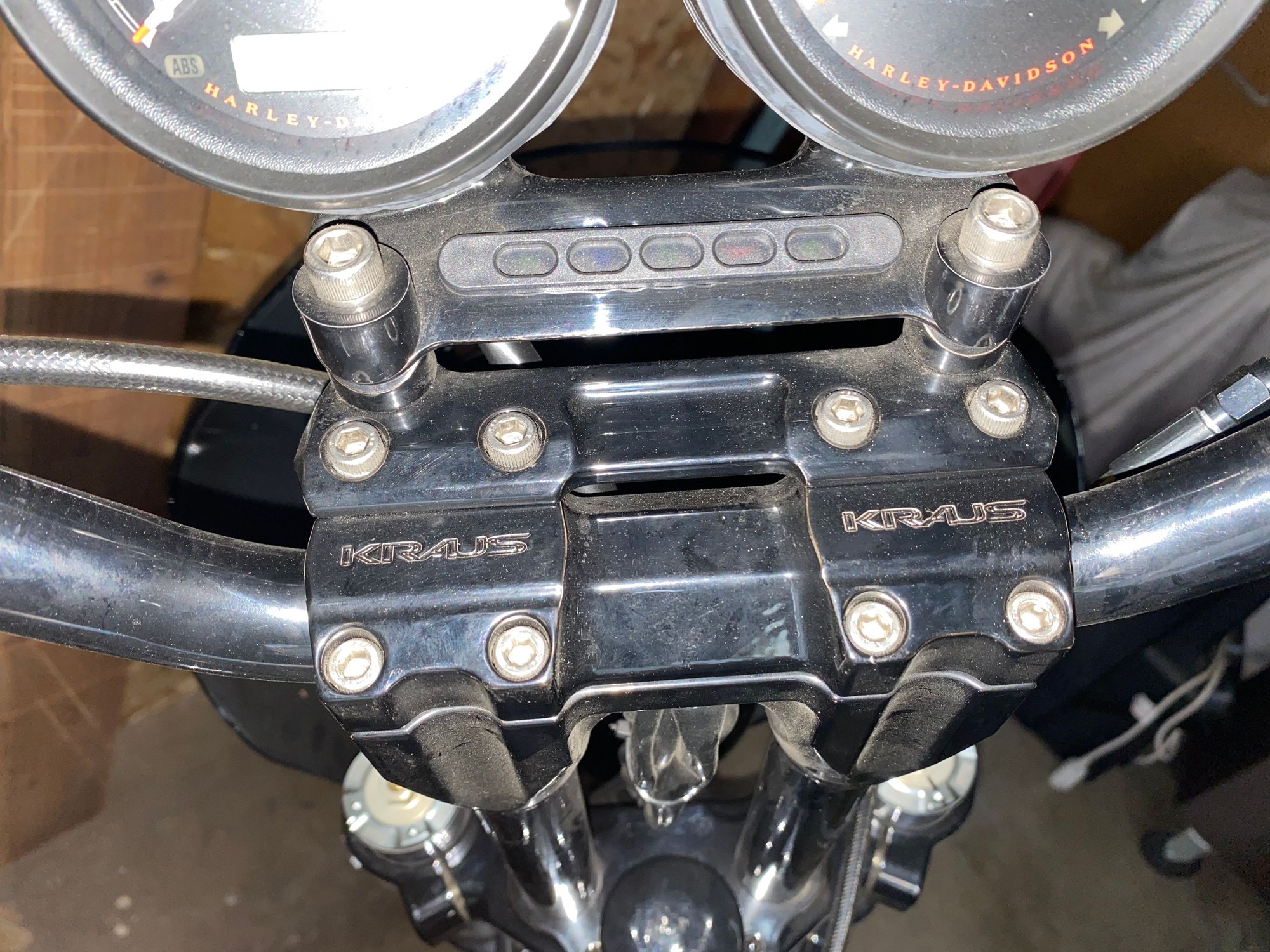

Second, the bracket is to use the top two bolts holding the gauge mounts:

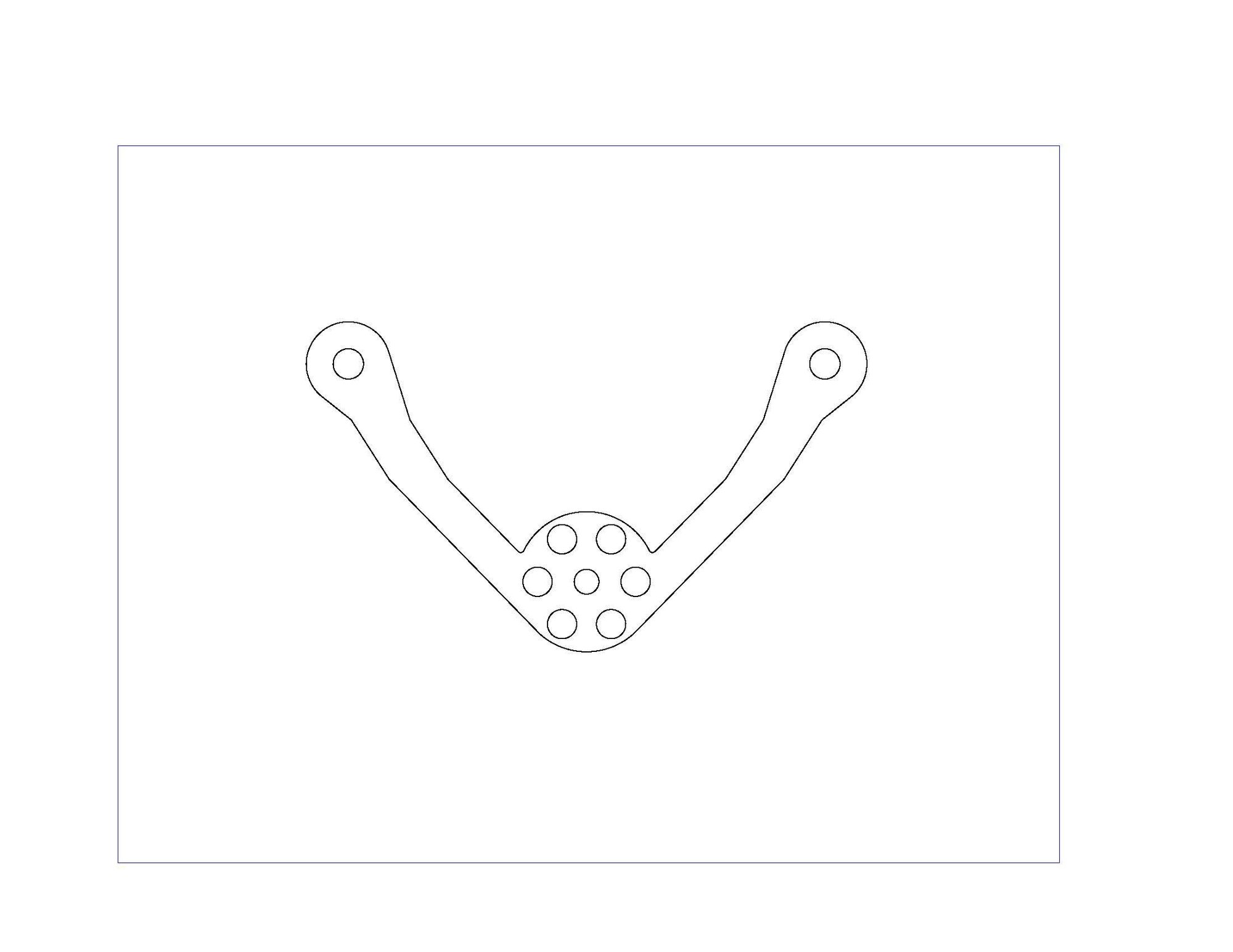

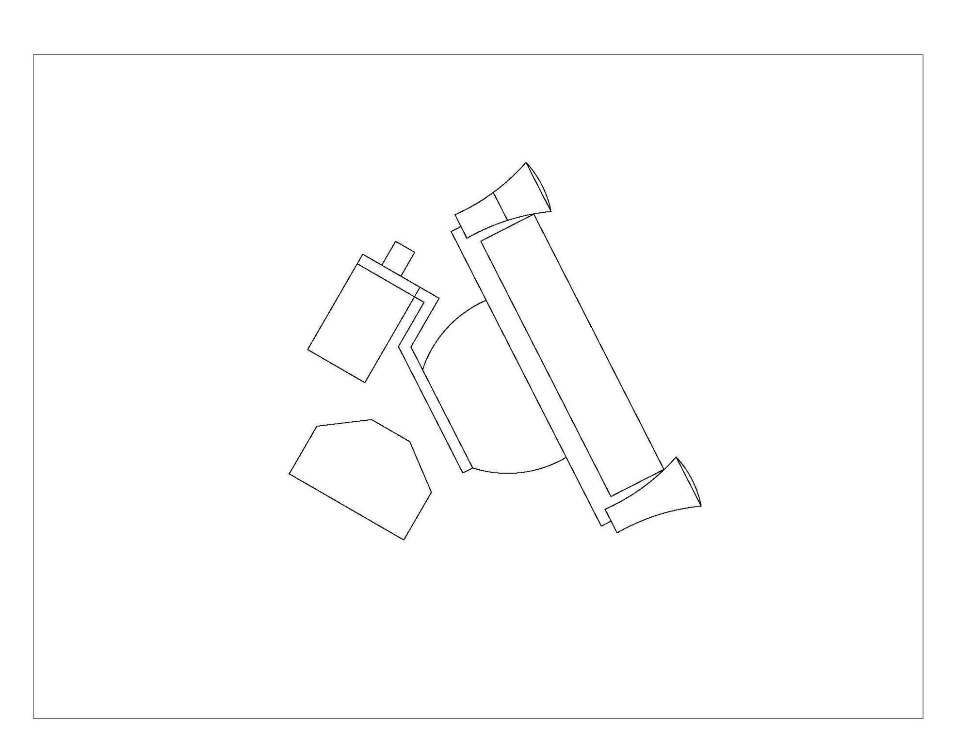

Third, a side view drawing of the bracket:
Fourth, a pattern for laser cutting:

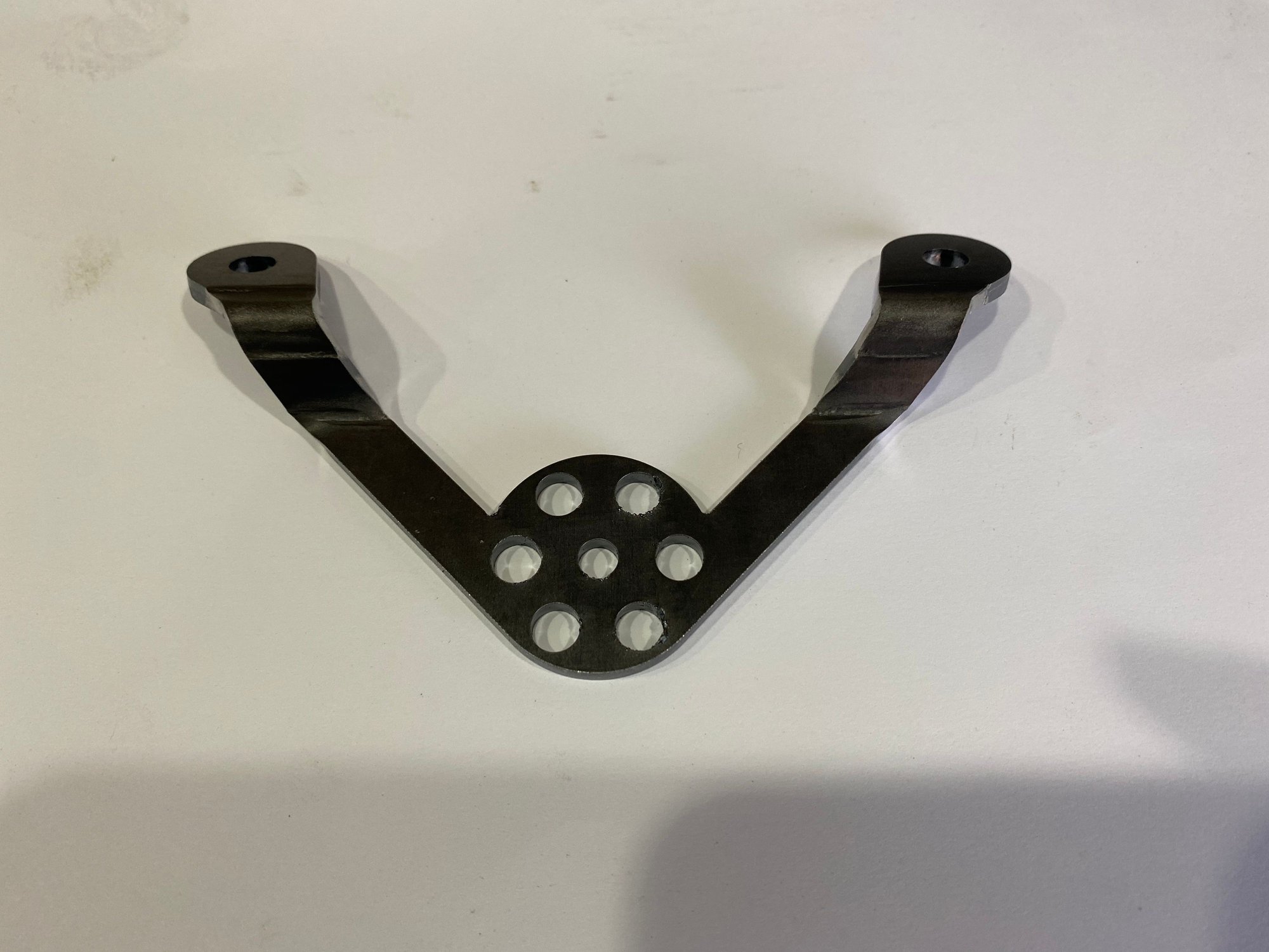

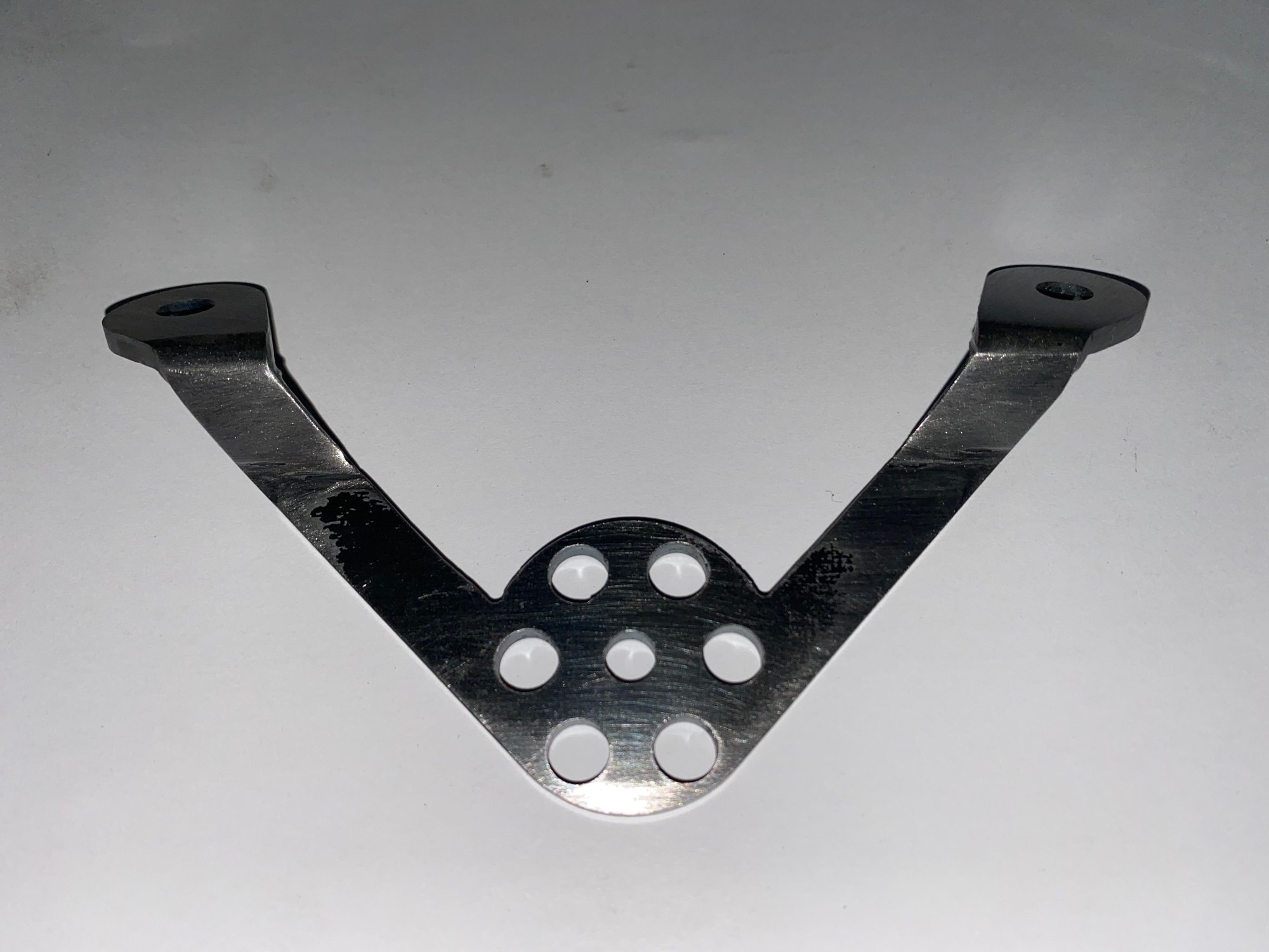

Laser cut and bend bracket. It is interesting to note that bending the piece, while the two bends where parallel, it caused the bolt holes to draw in closer to each other by an 1/8-inch. I clamped one side in a vice and heated the other side of the bracket red hot where it was bend and used a punch put thru the hole to stretch the metal back to 4-1/4" center line from bolt hole to bolt hole. I did that about 4 times alternating sides. I wanted a tight radius bend, so I used a 1/2-inch wide bottom die, but it left die marks in the metal.
Stretched and hand filed and sanded bracket three hours later. No more die marks:

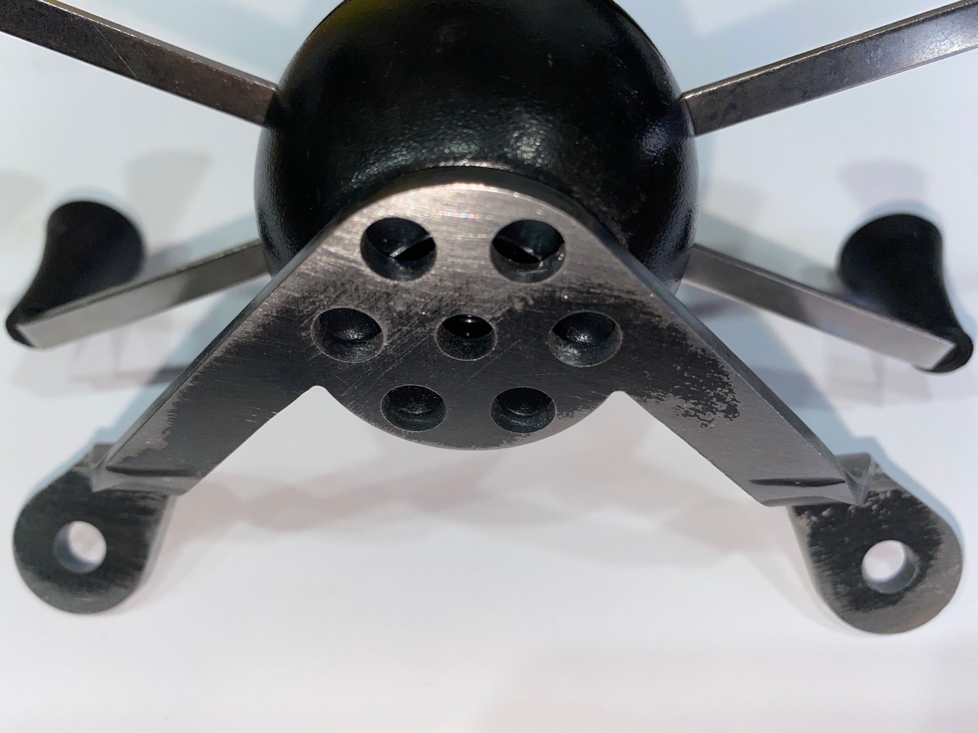

Dogs in back of plastic Ram Mount lined up with holes in the bracket:
Ram Mount and bracket bolted to bike:

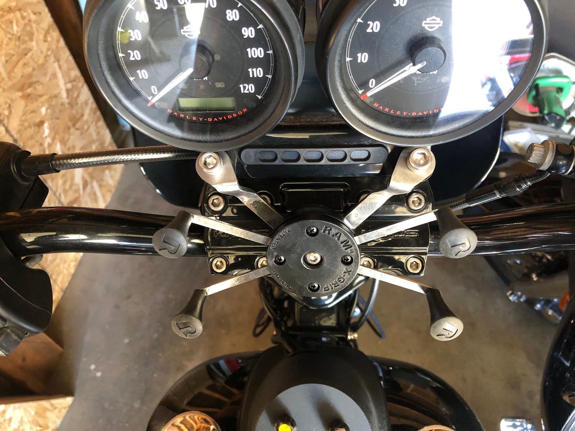

View of phone as riding:
I am going to get the bracket powder coated to match the rest of the handlebar assembly and it will be done. As you can see in the pic, it is in the perfect spot. I like with the gauges how I barely need to glance down from the road to view them, and now just a little lower to see the phone. I need to have Waze on at all times to keep track of the local po-po.

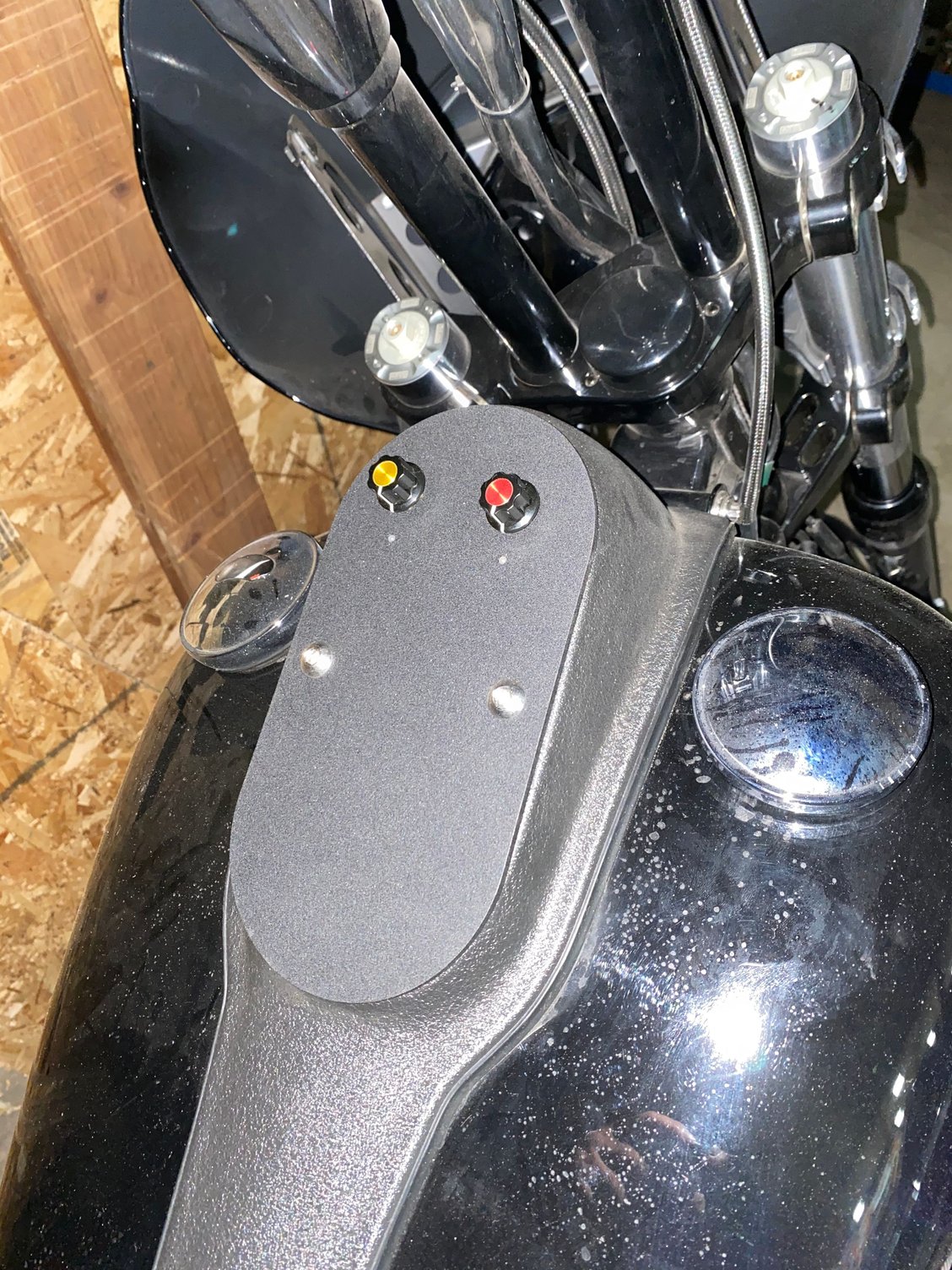

I don't know what I'm seeing in the place where your speedo was on your gas tank, are there lights there?

The heated gear temp controls:
I am going to eventually have six ***** there. Four for the rider and two for the passenger. Just need some more $$$$.
