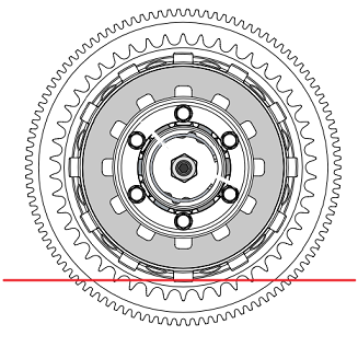

Don`t go looking for 99887-84 Primary Chain Case Lubricant. Long gone...Replaced by Formula +
Another view of the primary lube level:

Thanks for the visual there multihddr, For HD Donk, do have the small plug in the bottom of your case? If so, if you screw it in too far you could start making small cracks around the hole.
