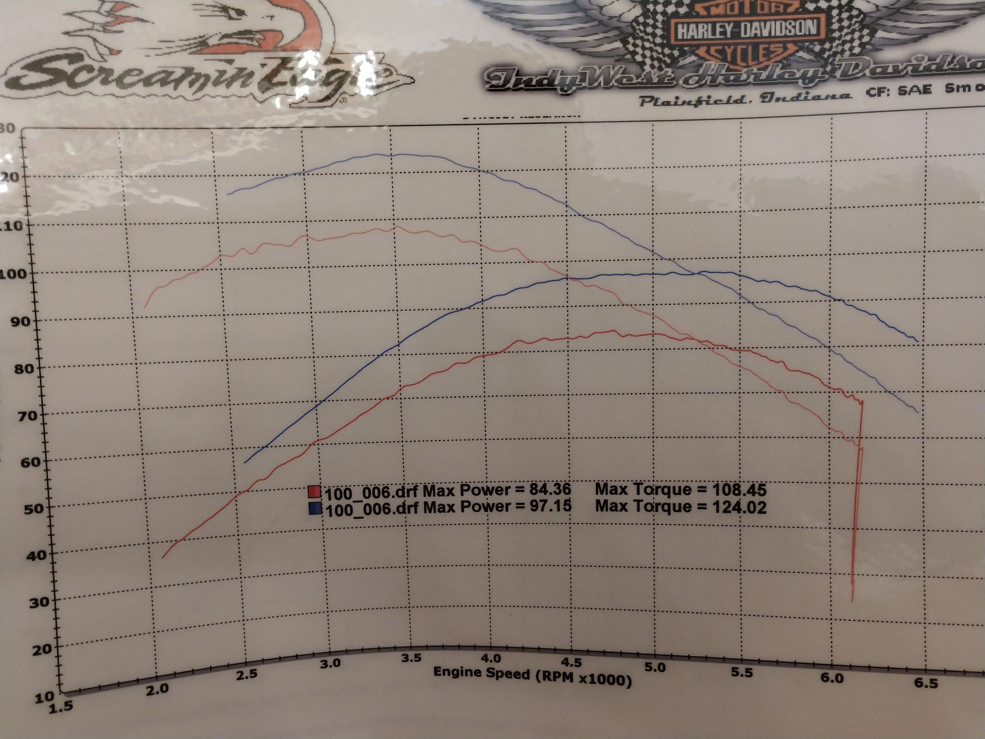

Don't forget the dyna vibes around 2500 rpms...you go changing the gearing to drop into 6th at 60mph and I bet it puts you right into the vibes range....I'm with the guy that said don't worry about 6th until north of 70...the 48h in my stock compression 103 is amazing...I know that's not your 96 comparison but it's close....I also did Moco cnc heads and I got great numbers...this bike is truly a blast to ride...gimme a sec and I'll post up my Dyno sheet...

The lower numbers are stage 1...heavy breather intake and big radius 2-2 exhaust....the higher numbers I added the heads and the cams...Dyno tuned both times...I did put in forged flat top pistons so it still has stock compression....
