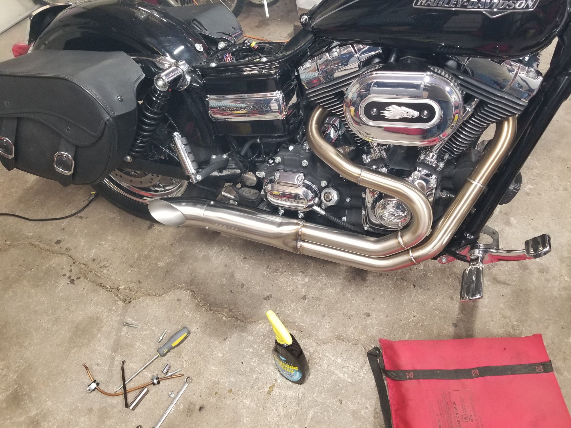

This is what we are working with. Baffle is 2.5" and head pipes are stepped.

There is a lot of potential with the 555 with headwork. I got all the torque I wanted and am not straining the motor too much. Your short pipes are another big difference with mine. I wanted the pipe as far behind my ears as it could be and Fuelmoto tuned the plates in the pipe to my parts combo.
