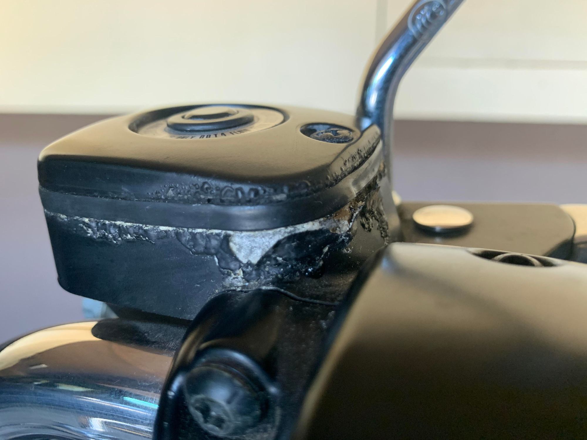

Just purchased my first Harley and I'm loving her. 2011 Super Glide Custom. It's almost perfect, with the exception of the front brake master being pretty badly corroded from a small slow fluid leak while it sat for a long time. Wondering if I should replace it with a used OEM master or if this is a common thing and I should go with aftermarket. I did just drop a ton of money on her, so I'm a little strapped for cash... But the issue does need to be resolved.

Welcome to the forum, personally I would replace with OEM as its a critical brake component and I just trust OEM more than some aftermarket piece unless its a real high quality brand. Anyways, brake fluid can leak from there if there is too much fluid when the cap is installed or if that rubber gasket is compromised or installed incorrectly. I would go ahead and flush the brakes when changing the master cylinder and be sure that gasket is installed correctly on the new one.

Take it apart, strip or sand off the bad paint, clean it out, and repaint it.
Install new cartridge, new cover kit, your parts will cost about $50.
To replace would cost about $150.
As suggested by shodown220, flush the old fluid out (use DOT4).
Torque the cover screws following the service manual instructions, one of the big reasons these things leak is because the screws are too tight.

Thanks guys!!! I'll try to fix this one and if I can't, I'll go OEM. Appreciate the advice.

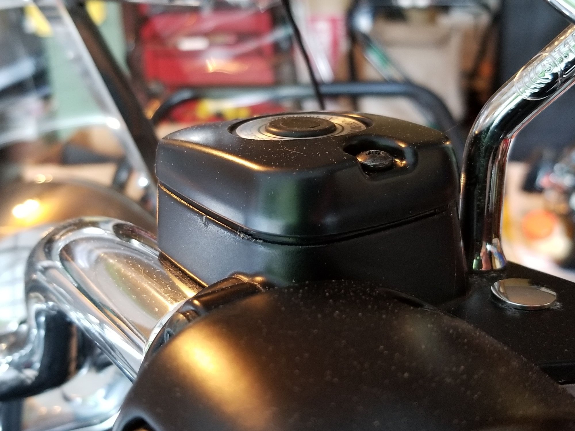

I have a similar problem on my '14 Fatboy. I bought an OEM replacement cover ($39.99 + tax) and installed it by myself just a few days ago (see picture). The original cover is very close to yours. The new one has a different design. I filled fluid leaving 1/4" of space in the reservoir. In a 30 minutes ride, fluid leaked at the corner near by the side mirror. I took off some fluid (say, 3/8" of space), and fluid still leaks to a less degree. I'm thinking to sand or file the cylinder contact surface to clean it (some corrosion and bad old rubber on it now). The manual says the screw torque is 6 to 8 in-lb. That's a very small torque, and my smallest torque wrench starts with 20 in-lb. I don't feel like buying another torque wrench and relaying on my manual method for now. Any tip is appreciated to end this issue.

Just snug up the screws. They should be tight but don't crank down on them. It doesn't take much force to make the seal work.
