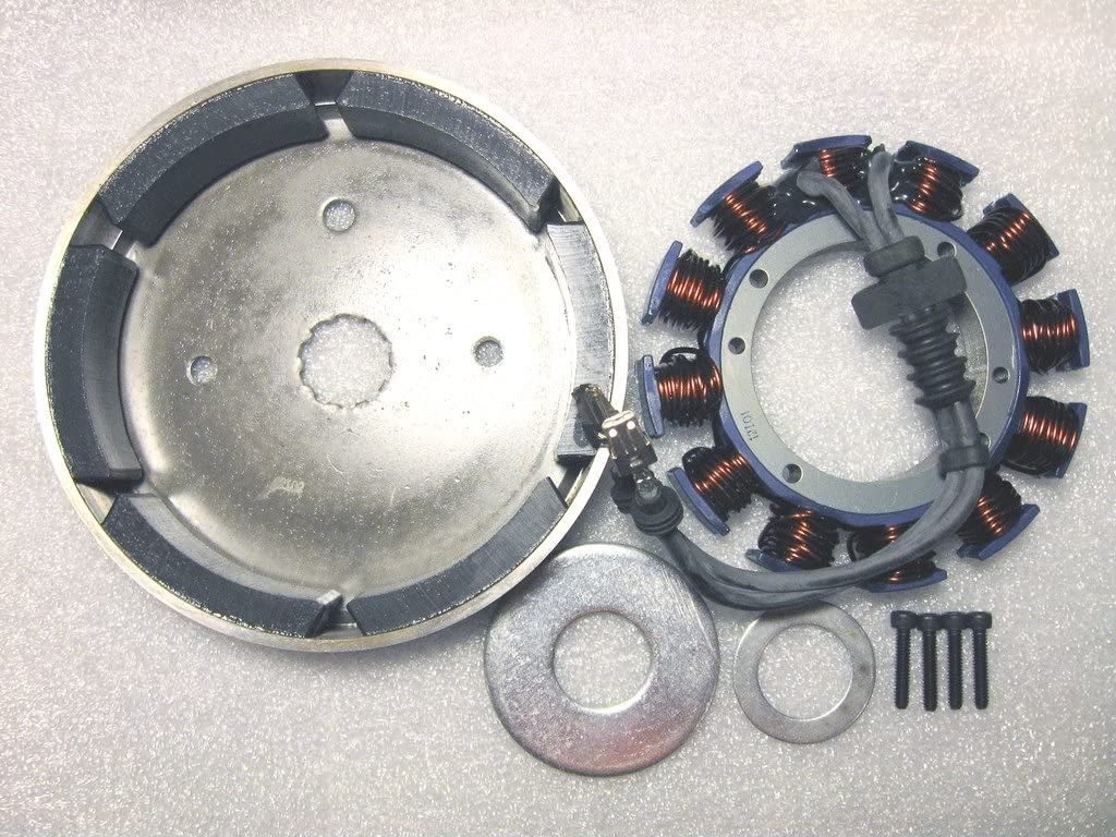

Originally Posted by tom1tina
I have a Dyna Wide Glide 2006 and want to see if people have had problem with their primary case bearing. The Harley manual says to change the primary case bearing at 15K miles. Please let me know if anyone knows the stories on the primary case bearing.
The only thing I would watch is the stator and rotor. If you have any voltage irregularities, those are a known issue. The bolts on the rotor back out over time and chew up your stator. 07 plus parts are fine. Or you can take it apart and weld them. It will go eventually and make a mess. It happened to me about 50 miles from home.
Do you mean the bolts that hold the stator on the engine back out? How many miles did you have when this failure occurred?
It's a 2 piece rotor/stator design like below. Mine went at 28k roughly. Its not a matter of if, it's when. It is an easy fix for the most part.
