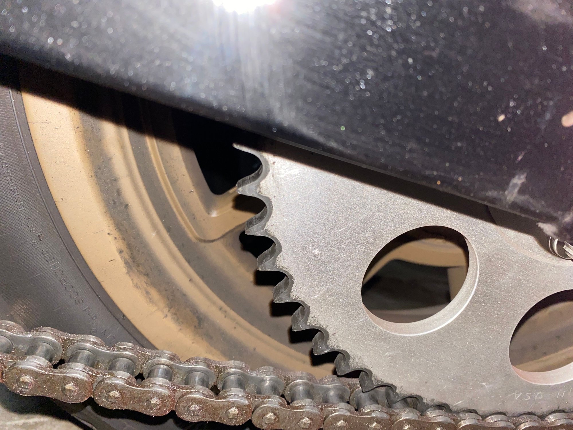

TOE_CUTTER's Avatar
TOE_CUTTER
Joined: Oct 2017
Posts: 815
Likes: 292
From: Uptown Bay Area, Cali
Not a cheap *** aluminum sprocket, see the USA, with over a 140 ft of torque rolling thru it. PBI is the way to go.
Yes, my bike is filthy. To be cleaned soon.
Dave
