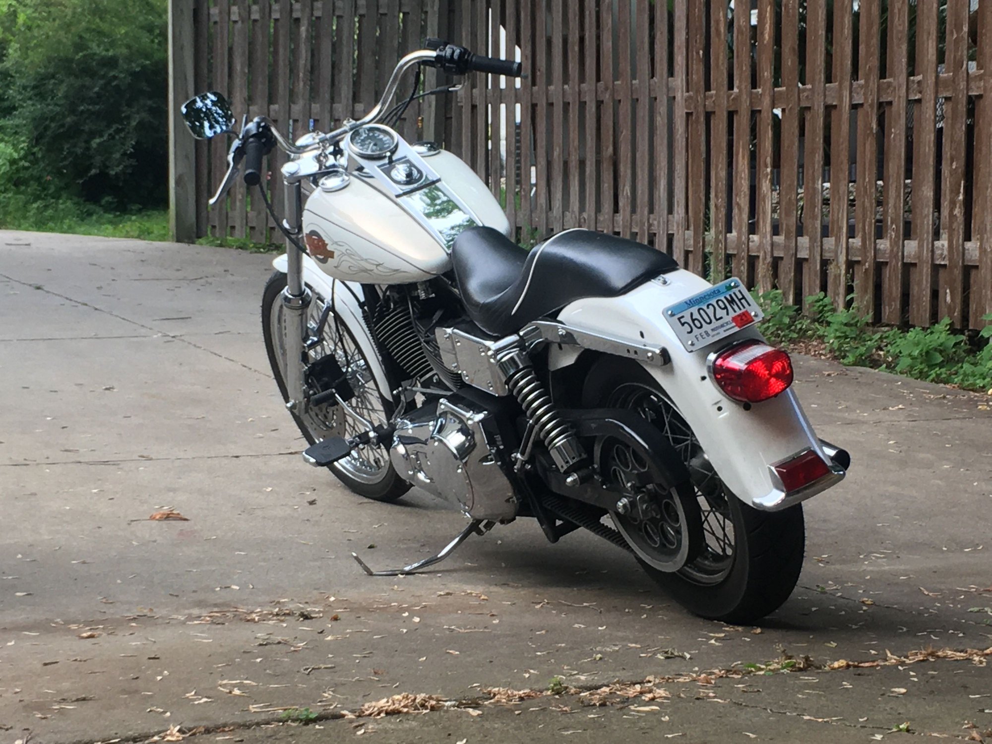

I did the same to my 2000 WG. It's not a direct swap, you'll have to drill some holes to get it to line up right. I'd try to find an FL fender from the same year as your Wideglide since I'd think it'd at least be the same width.
Here's mine:

ya i think your right . the softail from that year is about a half an inch to big . i havent measured a road king yet . your bike looks almost perfect . just what im going for . and maybe a 26x3.5 front tire. thanks--

Yep, that fender is off a 2000 RK I believe. Plan is to patch the holes and repaint the tins. Good luck man!
