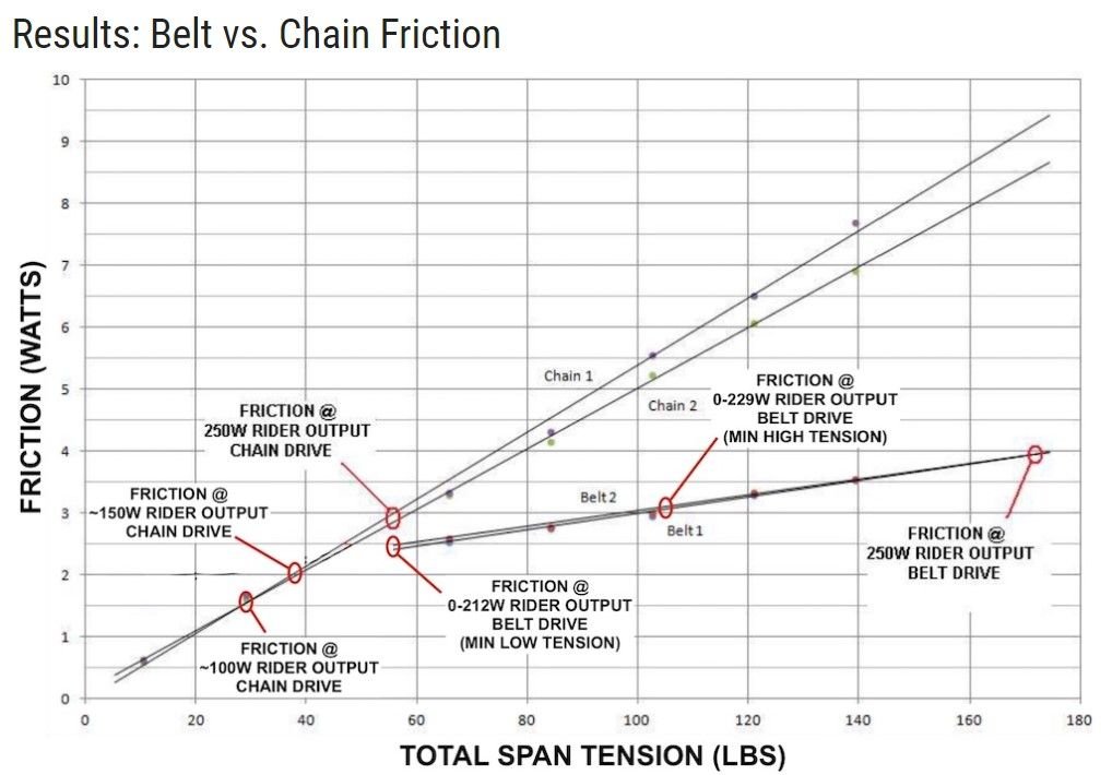

Originally Posted by Bob_fxdb
that’s good for you!
Rhetorical question(I don’t have interest in knowing your answer, no disrespect):
What is hard miles for you? Do you think you put enough stress on the belt on your riding style?
A perfectly healthy belt is good and strong, no doubt, but a small tear could end its life.
You need to take in mind that belts are made out of reinforced rubber, and rubber flex. Power loss right there. It’s just a shame if one are upgrading their engine for power and lose the gains right there. The throttle response is better also.
Im not hating on belts and I like the maintenance free aspect of them. If belts could be near as strong and has the performance of chain and super easy to replace on the dyna(primary) I for sure gonna switch back to belt.
I'll give you throttle response. No argument here.
Power loss from belt flex is (in an industrial setting) roughly 9% at peak torque. For a chain, it's about 3%. I'm sorry, but there's no way you notice the difference between the two on the road. Plus if you ride a lot, you can't argue for cost savings because like Chris said, you'll be replacing your chain and sprockets every 15-20k miles.
Basically what this is saying is that because of resistance caused by the pre-tension on the belt from the get go, a chain is more efficient in the time before the resistance of the two become equal.
