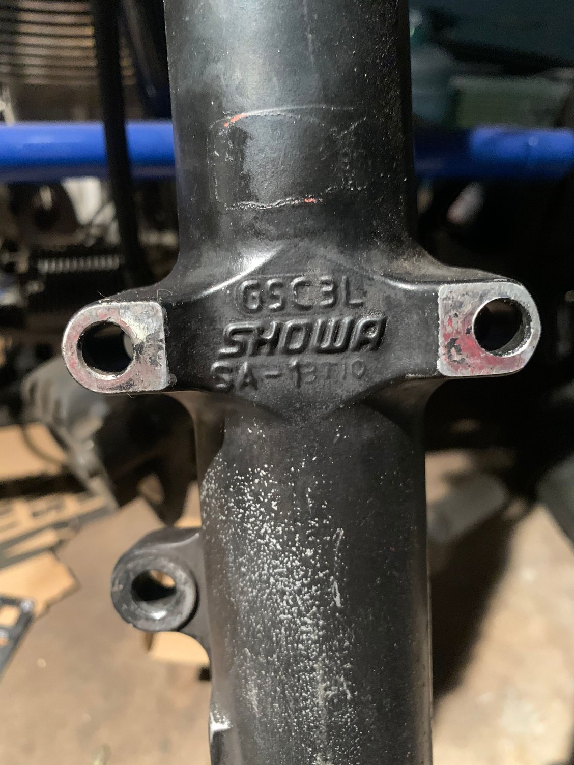

What’s up guys, I posted this in the suspension forum as well but maybe you guys can help me out faster. I’m trying to identify if these are actually fxdx forks and if so what year so I can get the right axle and see if I gotta modify my mags. They’re definitely 39mm and they’re going onto a FXR build actually. I attached as many photos as I can, thanks guys.

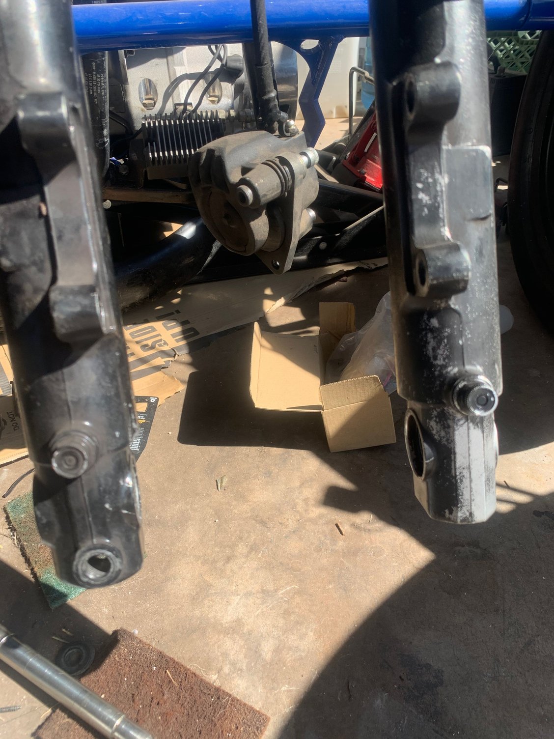

You have some mismatched parts there ... unfortunately you probably won't find a Std axle (Not custom) that will work for you
It looks like the Calipers and 3/4" bearing 13-spoke Front wheel are 99-earlier ... calipers won't mount up and wheel won't fit those 04-05 FXDX sliders that use a 1" axle
There are a couple ways to get to your target ... just depends on how you want to do it

So these are 04-05 sliders? This is what I really needed to know, I know there’s work to make these wheels and calipers work but I needed somewhere to start so thank you so much
