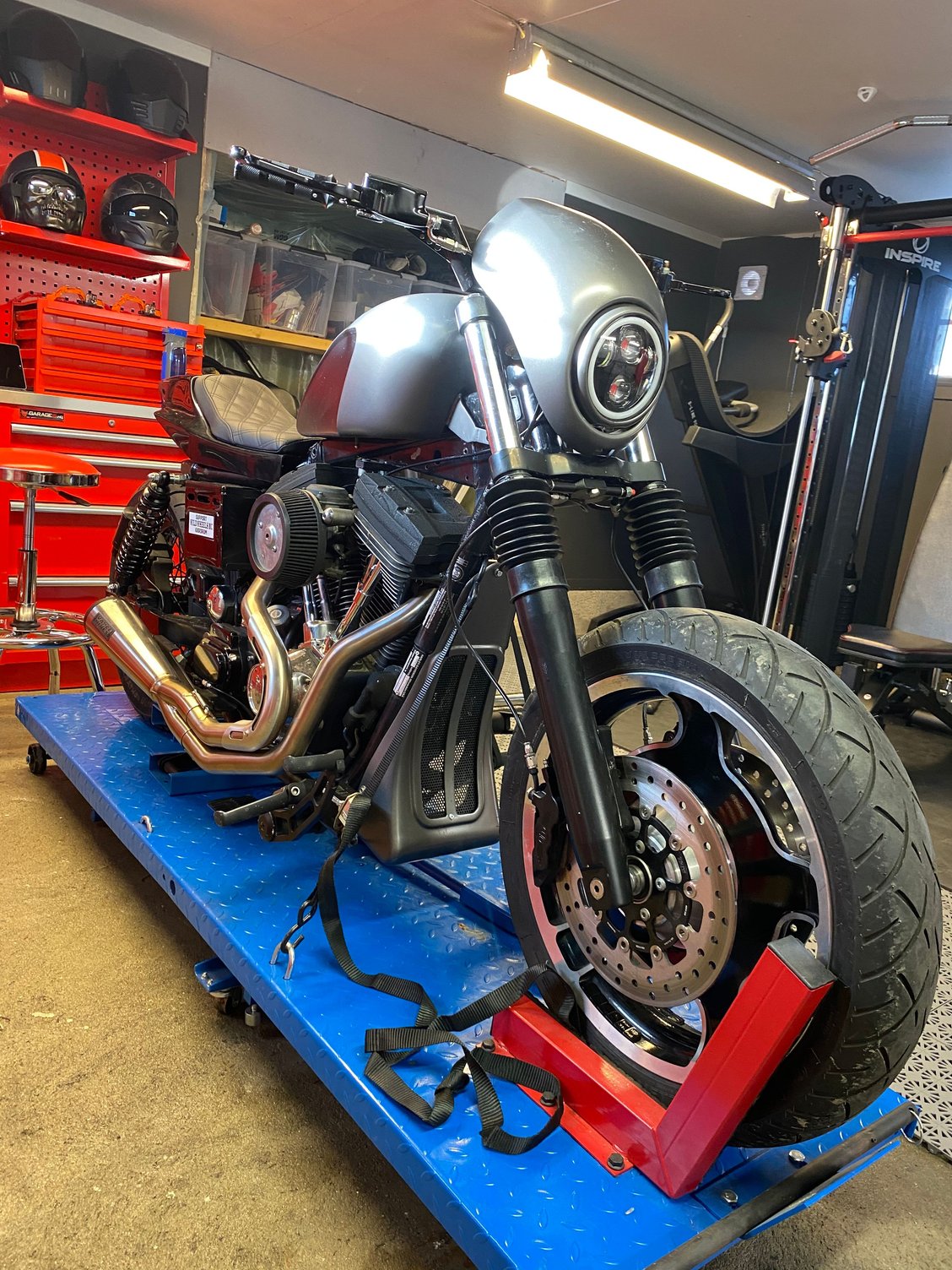

Post a pic of your Frontend
Old Nov 22, 2020 | 02:26 PM
TimJ2110's Avatar
TimJ2110
Joined: Nov 2019
Posts: 109
Likes: 76
From: Norway
Here you go😊
