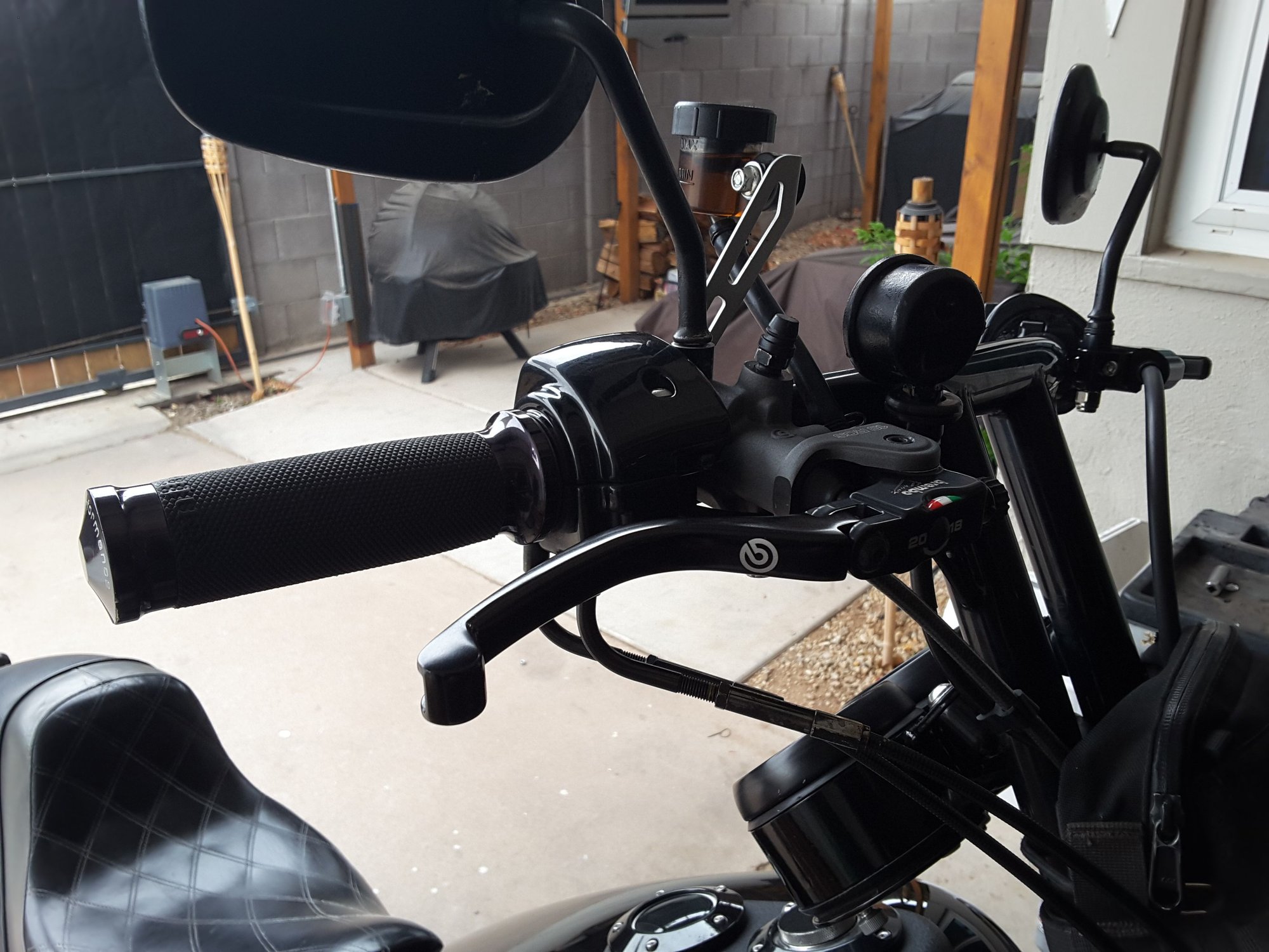

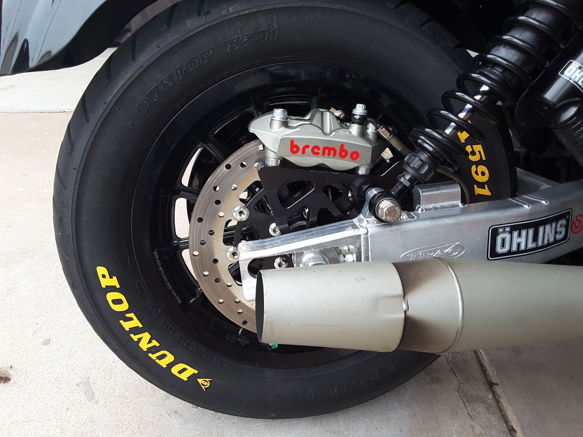

Sure Dave. Brembo monoblock radial brake caliper. TC Bros caliper mount. MC is brembo. I forget what model. Had to weld mounts on to frame for MC and make my own brake lever rod out of a push rod. Brakes work 100% better then stock. A little touchy but I got used to it. I also run all aftermarket up front if your interested

11mm bore on piston of MC

I would say it's a perfect match. There definitely more touchy then before but feels perfect now. I've let one person ride my bike and had to warn him about them. I have the same set up in front with the 19

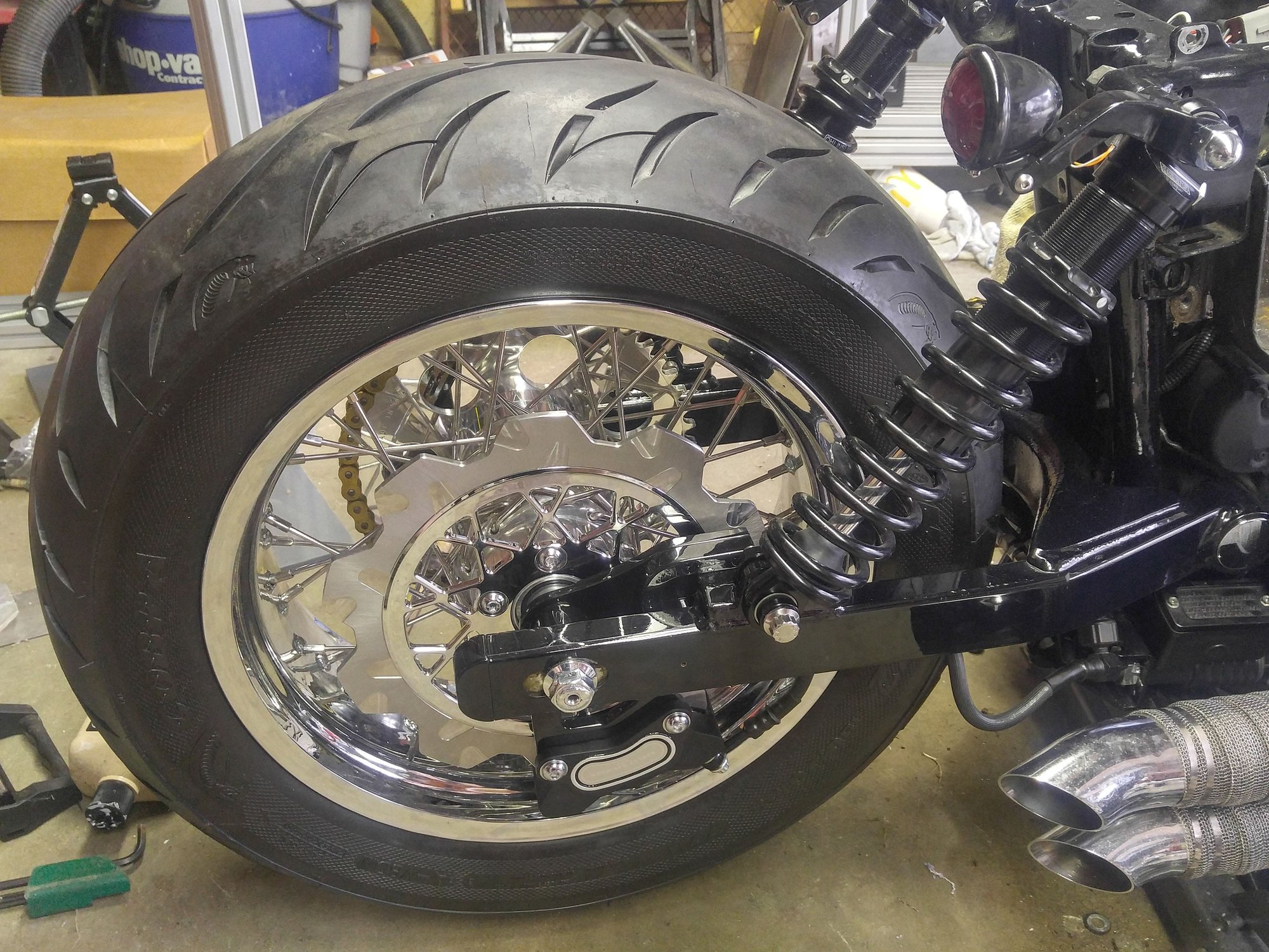

99 with stock master, Wilwood GP310 caliper, matching low-mount bracket, and Lyndall floating rotor. The bracket and caliper are custom finished to better match the stock fronts but mechanically unchanged.
With Lyndall Extreme pads (to match the dual fronts), I think the rear brake is a bit too aggressive (too easy to lock up) so I want to try their lower grade(s) once I get to the next stage of the build.
Left is the customized Wilwood (upside down from installed orientation). Right is a stock 08+ rear
