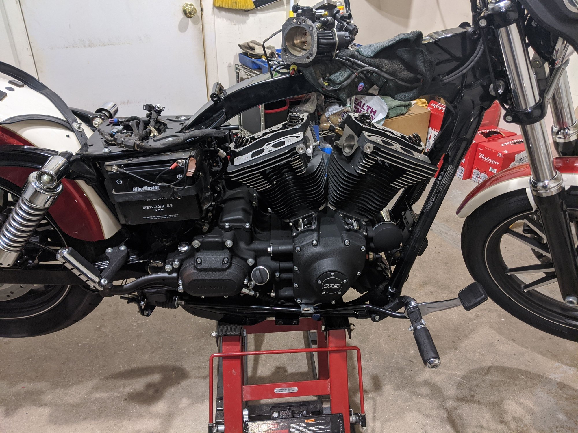

Okay so tonight I got a little bit done.. I was able to get the cylinders back on and torque them down so I could figure out my piston height in the cylinder. The dial indicator shows top dead center on the piston and I was able to measure .004" on the rear and almost identical on the front The front might have been .0035".. So just so you know that when I've always used .005" in calculating compressions etc, I was pretty close... So I think I'll stick with that number for pre determining my calculations..
After getting my piston deck clearance, I put on the .030" head gaskets and cylinder heads. I did lower the bike to the ground just to stabilize it so I could properly torque the cylinder heads to the cylinders. Yes I did use lube on the studs and on the bottoms of the heads of the head bolts.. It's the only way to get a truly accurate torque number and that's all for tonight... I did torque them to Cometic's specification ending in 42 Ft lbs....

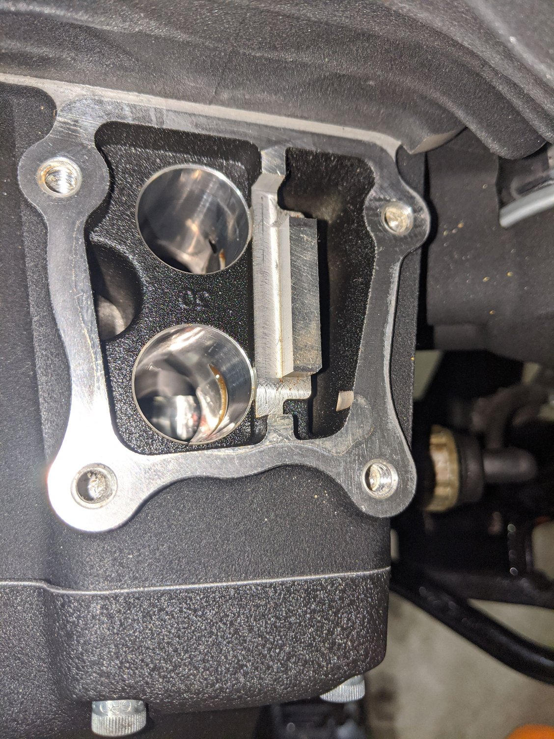

This pic is the front lifter bore's..Quick question about the positioning of the lifters. With the oiling port on the outboard side of the lifter boars, Do I match the lifter port to the boars. In other words are they directional? I should have paid more attention but I can't seem to remember..Thanks

multihdrdr's Avatar
multihdrdr
Joined: Oct 2011
Posts: 11,175
Likes: 2,483
From: Nor Cal
Old Jan 20, 2021 | 07:15 PM
98hotrodfatboy's Avatar
98hotrodfatboy
Posts: 21,117
Likes: 7,643
From: Poolville
So the lifter goes in opposite the oiling ports in the bores... Thanks..
