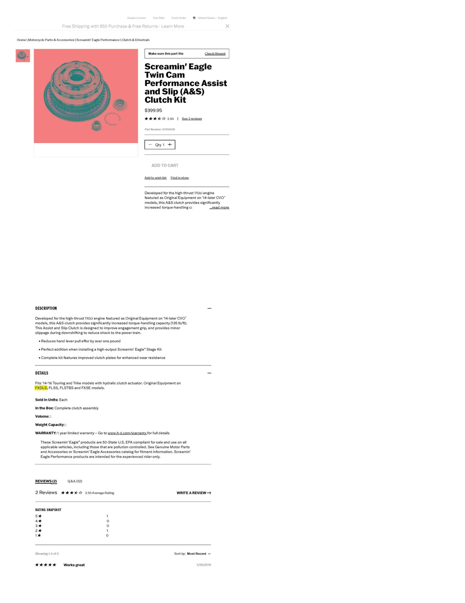

Originally Posted by TOE_CUTTER
Although there is guys I'm sure that swear by a solid motor sprocket, he explained very well why one should not go to one. I like how he explained also about changing the primary ratio is also a bad idea.
When building up my motor, I did speak to my builder about all these things, and even with 150 hp, he recommended staying with all the stock components and just adding the AIM VP-SDR to the clutch. Mind you, the Low Rider S came with the SE A&S (3 Studs Style) clutch, instead of the Non Slipper (6 stud style) clutch found on the rest of the Dyna line. You can still get the upgraded SE A&S clutch from Harley for $400 bucks. It's rated to 135 ft lbs and adding the AIM, it's holding 145 lbs with a 124" (with a stock basket) on mine.
While some guys may have grenaded the stock clutch basket, clutch, etc., I have seen where individuals removing the stock parts damaged them upon disassembly by not using the correct tools and methods, and then those parts failing later.
Dave
Did it really? My book says PN#37817-11 for a FXDLS clutch. Which is the regular 6 stud style clutch.
