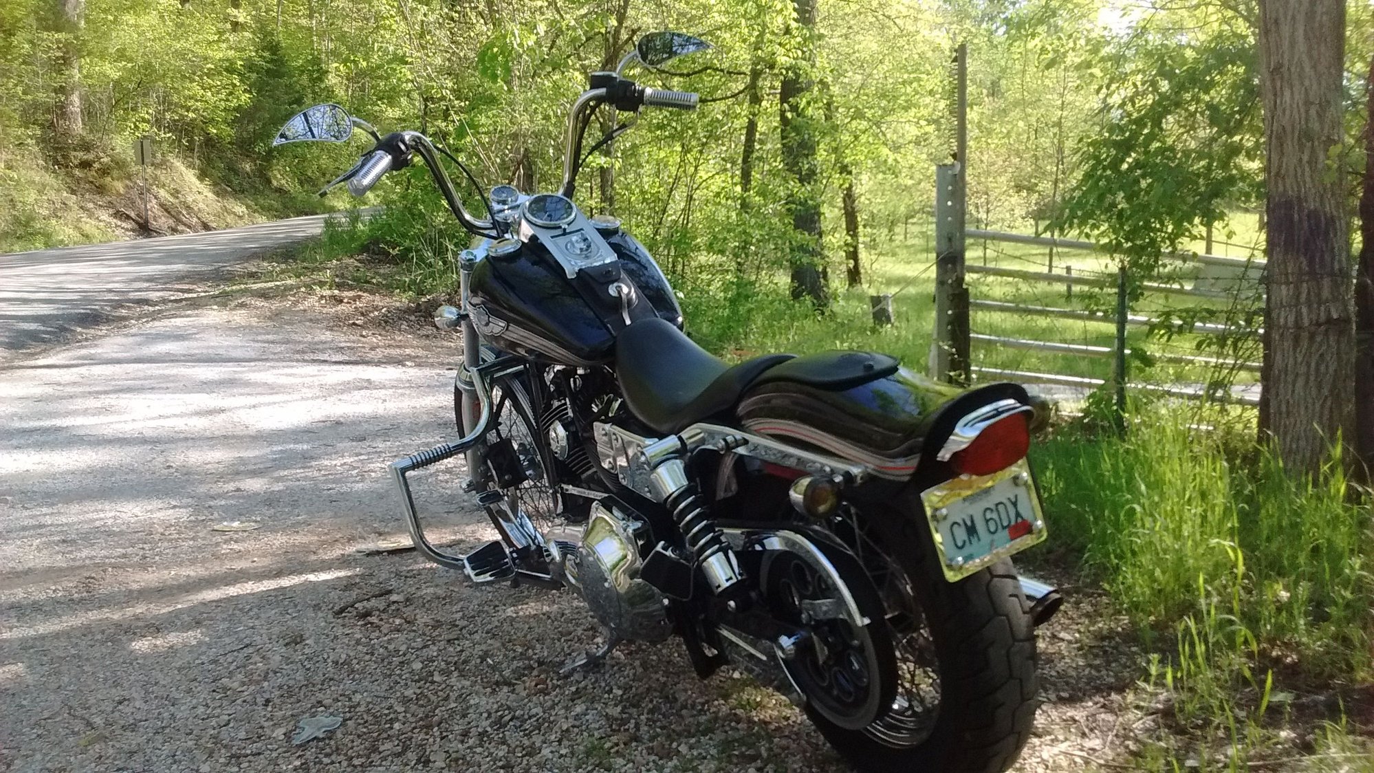

Like Steve said... Most are made to fit. This one is a Saddlemen,, It fits the previous holes..

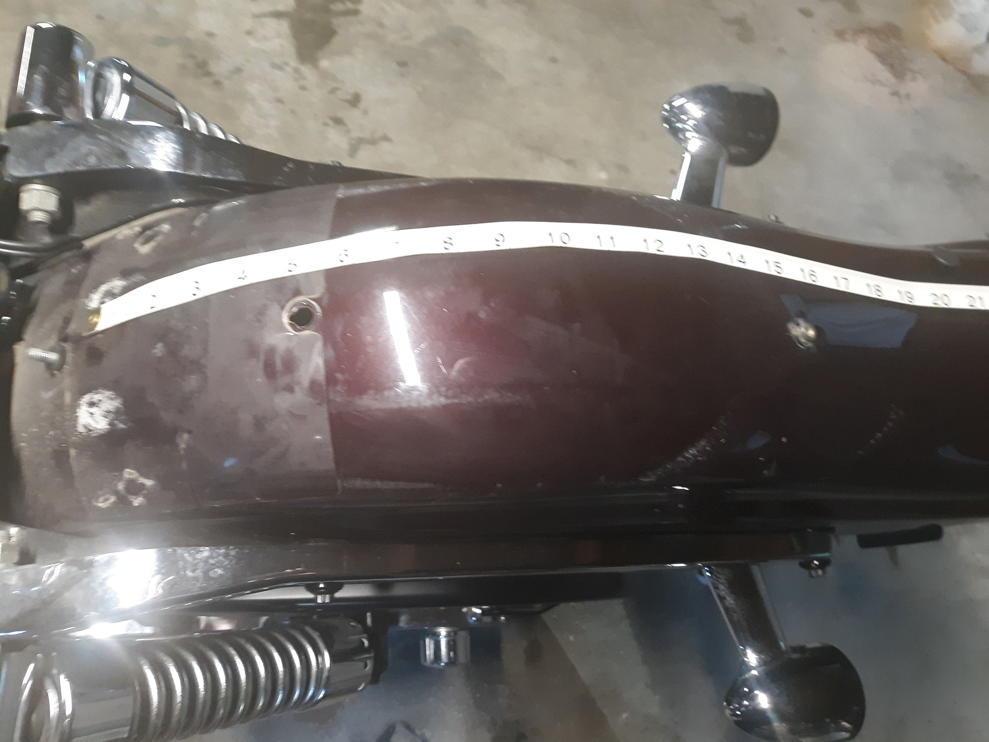

I took a few pics, there is one screw facing up and 2 holes, the hole closest to the tail light is the one my current 2up seat fastens to.
Which hole will the solo seat attach to?
I changed seats from 2 up to solo using HD solo seat and bib on my 2010 FXDC. No drilling. The hole close to 5" shown on your tape is the solo seat and forward bib attaching point. The rear bib attaching point is at your 2 up seat attaching point.
