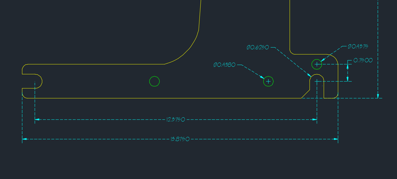

OK, side plates are a different story, the spacing between the mounting bolts are different. There were some differences in width, but that doesn't change the side plate.
Most 96-05 Dynas can use the same side plate, you can check the bolt spacing, for 96-05 should be 12.375 center to center, picture is from my old CAD files when I was building custom mounts.
You should be able to find something on ebay.

In fact, I may have a set of bare side plates in the garage somewhere, check your center to center on the mounting bolts and let me know if it is 12.375
