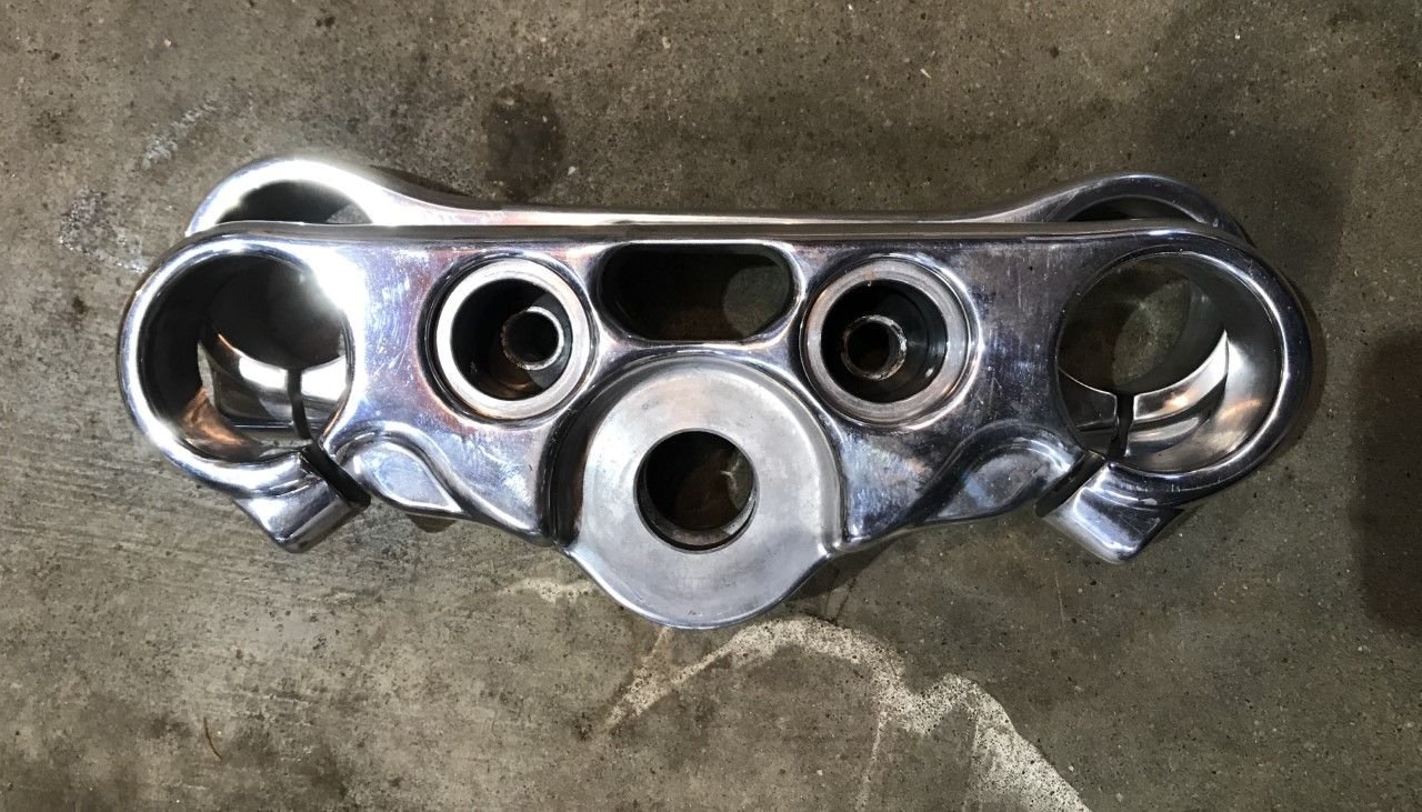

Not what this thread is about, but you're partially correct. All '06+ Dyna frames except the Wide Glide are 29 deg. The Fat Bob is a different frame (rear fender struts are wider, like the Wide Glide) but the head tube is still 29 deg. But the Fat Bob uses -1.5 deg rake trees, and the Low Rider uses 1.5 deg trees. I haven't been able to find anything concrete, but I believe the Low Rider S used the same 1.5 deg rake trees, as I found a few articles referencing the S model having 30.5 deg rake (29 + 1.5). Street Bob and Super Glide/Super Glide Custom have 0 deg trees. The Wide Glide (34 deg rake frame) uses 3 deg rake trees with 2" longer fork tubes.
Here is a FXDL upper tree on top of a FXDC upper tree. While the 1.5 deg rake is certainly not visible from this photo, the reduced offset to keep the trail measurement in check is.
As I mentioned earlier, the Fat Bob actually has negative rake in the trees. I assume this is to make it handle a little quicker, and possibly counteract the extra weight/stability of the fat front wheel & tire.
