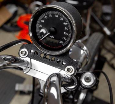

Got one more question haha, the speedometer on my bike is part of the top clamp for the stock bar risers. Do you know of any aftermarket brands that are for sure compatible with the speedometer. I'm having trouble finding information on that. Would like to go with 6.5 to 7inch pull backs if that helps. Or if there's a relocation kit.

I think you can buy the speedo housing for a Sportster or Super Glide like this one and just put your speedo inside it... There are also relocation kits to mount it to the triple tree or the upper fork. Clicky the linky... dyna speedometer relocation - Google Search
