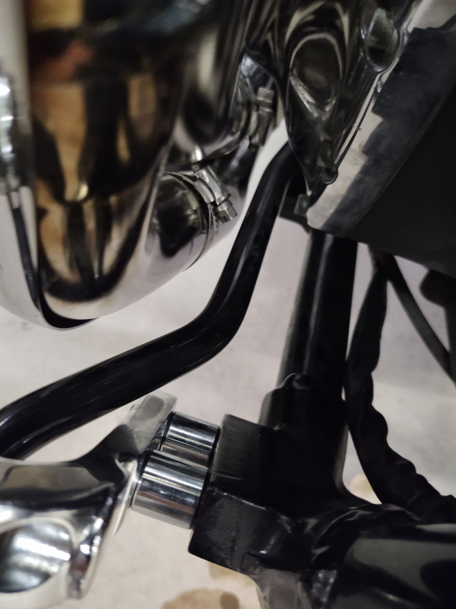

I bought chromed 5/8" spacers and longer bolts from the hardware store. This worked to space out the controls on both sides. Double check fitment of your brake actuator rod with your pipe, this may be a -$20 solution for your problem.
thanks i will do just that. looks like the answer to my problem. its apreciated.
