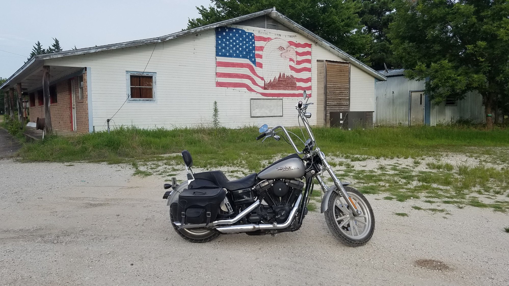

Here she is with the 16" apes. Forward controls and windshield brackets in the mail. My daughter is named after the '85 model. I do have a slight problem. After riding the road, and comung to a stop, she is idled up. What causes this, and how can i fix it? Other than that, she rides great, besides the wind. Lol.
