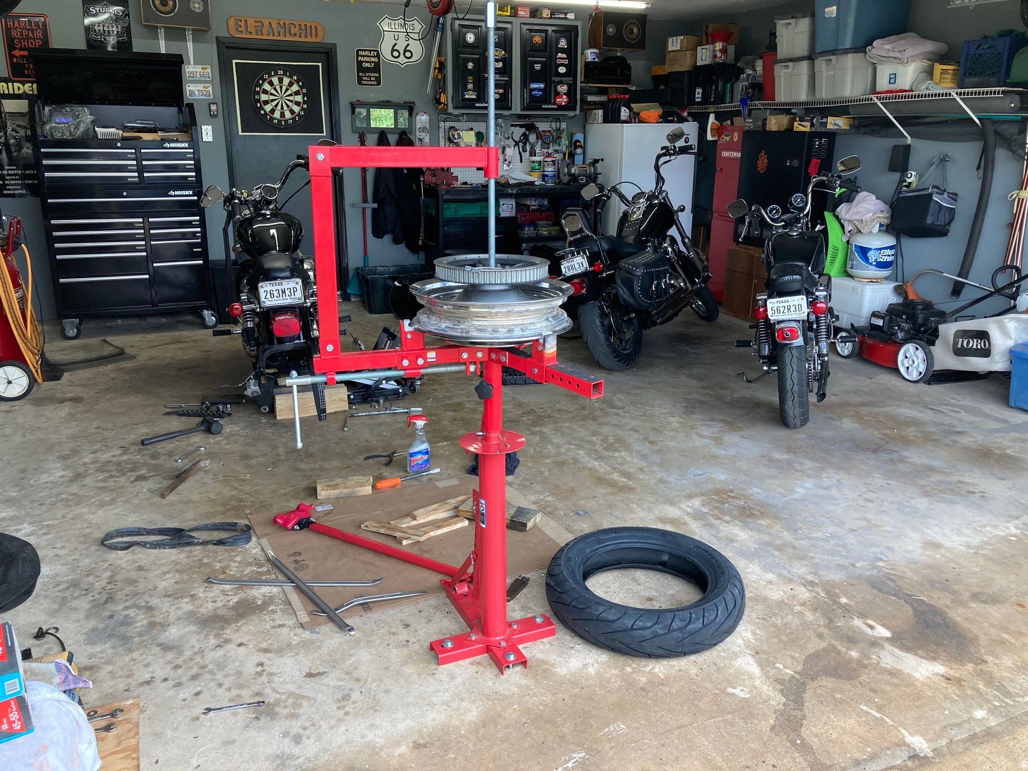

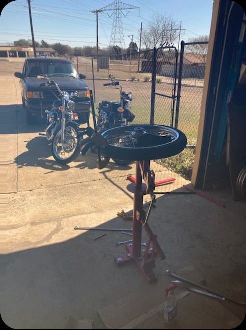

That's a very good reason to change yer own tires. I've been doing that for years. 07 Dyna 104,000, 04 XLH 40,000, 77 XLH 4,000. Average mileage per tire - rear - 10,000, front -15,000. Worth the investment of a tire changing tool.

I like that setup you have in the garage!
