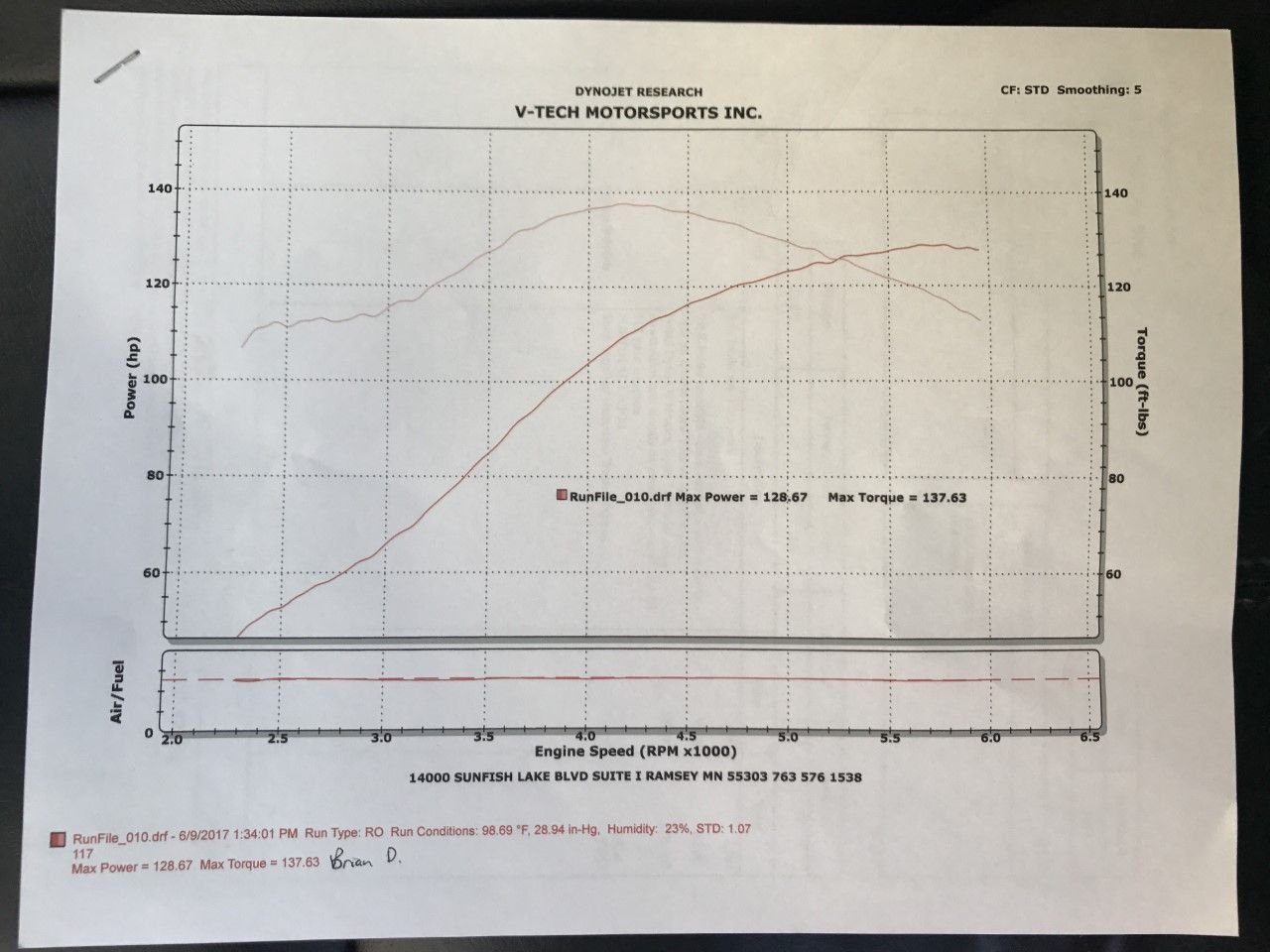

Old Oct 26, 2021 | 10:27 AM
Reindeer's Avatar
Reindeer
Joined: Dec 2010
Posts: 4,074
Likes: 854
I'm running S&S 585 cams in my 117", more than happy with them. I'm at somewhere around 10.75:1 compression, ported heads with oversized valves, 58mm throttle body. When I was reasearching my build a lot of knowledgeable dudes (including the guy who did my heads) recommended the 585s for my goal of solid midrange torque and still having a decent top end.
