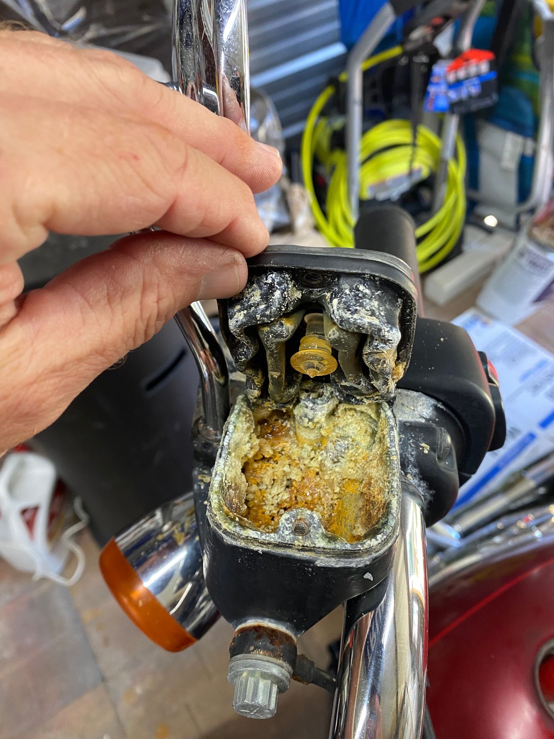

Recently bought this bike that has been sitting since 2012, what is the best way to clean it or should I replace it? I did buy a rebuild kit before I open it

replace!!!!
Replace brake hoses and look in your calipers for the same thing.
Whats the rest of the bike look like?

You need to replace the whole brake system. Master, lines, calipers etc.
