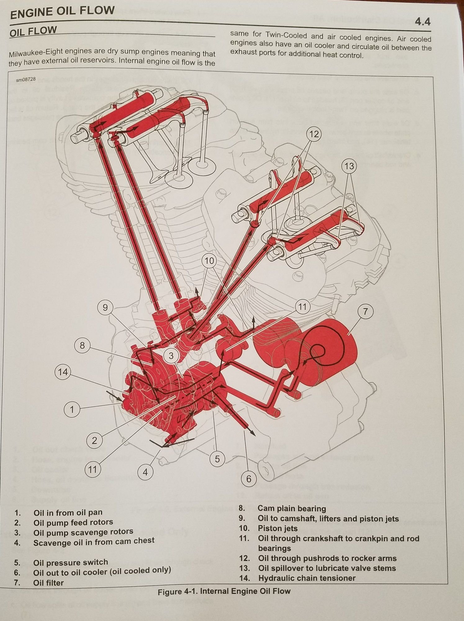

When you pull out your old lifters, you will see a drilled hole coming from the motor and going into the cam chest.
The hole will cut through the side of the lifter hole perpendicularly about half way down, that's how the lifter gets its oil.
For the front cylinder, the hole cuts through the lifter hole in the front and in the rear cylinder it cuts through in the back.
You want to put the oil holes for the lifters in a position to cross that hole every time they move up or down past it.
So, for the front cylinder, you should have the lifter oil holes facing front.
And for the rear cylinder, you should have the lifter oil holes facing back.
Don't think this is the exact right pic for you but close enough.
Grab a copy of the pic and zoom in you can see the oil path for the front and rear lifters.

Its already squared away, and I did locate those oil ports. I appreciate your post a bunch, thank you!
