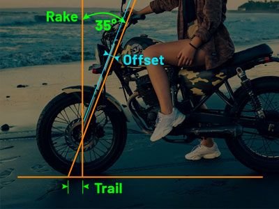

Of course longer shocks will change the rake. As per the photo, rake angle is the determined by the line formed by the fork tubes (usually parallel with the neck of the frame) and a true vertical line, assuming the bike is on level ground. Longer rear shocks raise the rear of the frame, decreasing the angle, hence the rake. Shorter rear shocks lower the rear of the frame, increasing the rake.

Wrong. Try building a few sidecar rigs it You looking at it wrong the rake is in the neck and the tree. the rake angle is not changed if you raise the rear .

A different way to put it: The rake is going to be determined by the frame and triple trees. Raising or lowering at the rear of the bike will affect the trail. At the end of the matter, what you’re mostly concerned about is the trail. Keep in mind the offset of the triple trees also affects the trail.

No, you're wrong, basic high school trigonometry (the study of angles) is your friend. Rake angle, as measured in degrees can be altered by simply increasing rear end height. Your theory is contrictardictory to logic.

btw- increase in rear height does change rake "angle" and trail "angle" (however in this case is subtle). Rake "angle" is the combination of rake, offset and trail and measured off vertical. Any change in any of the angles affects all since they all combine for 90.
