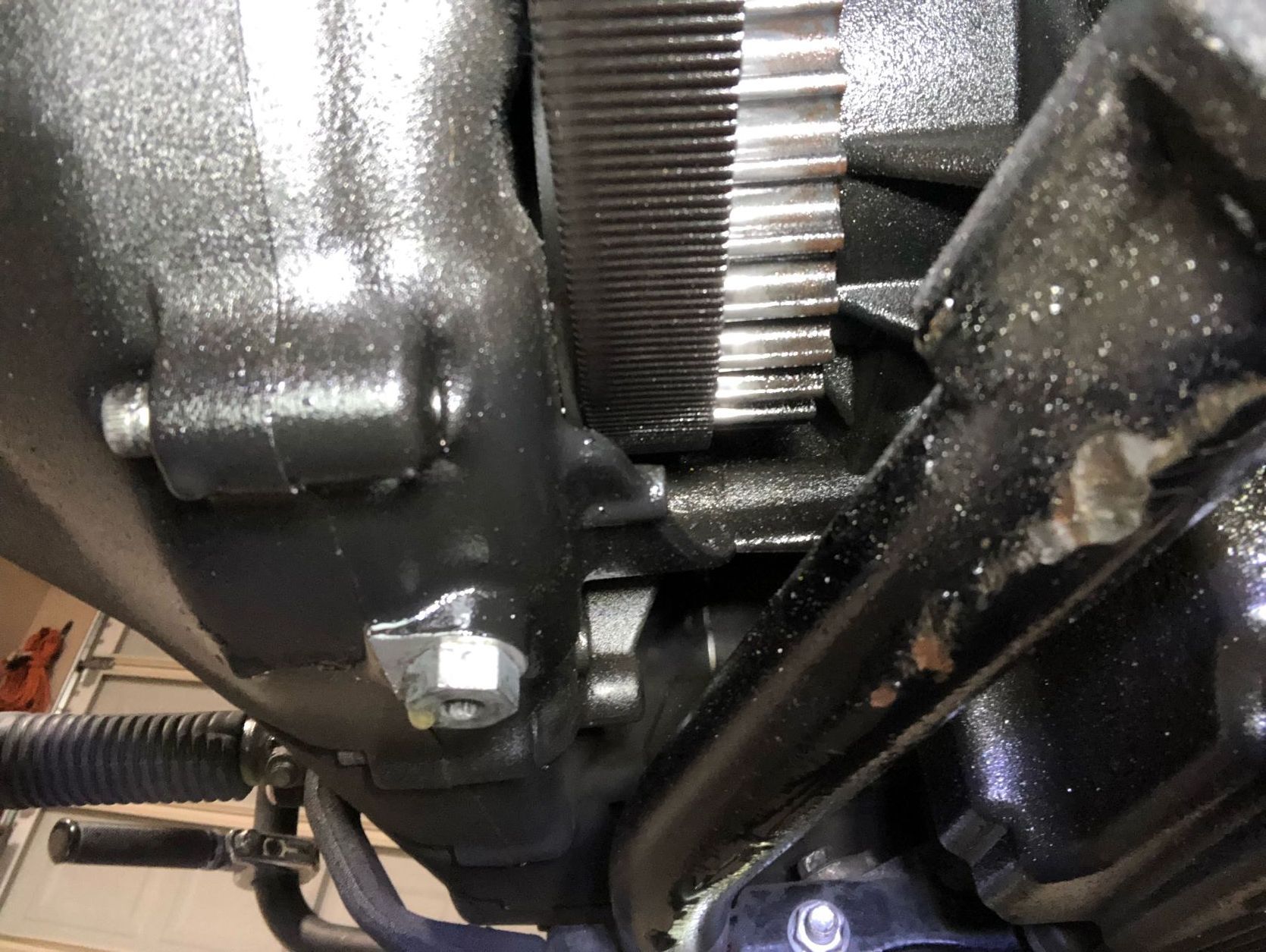

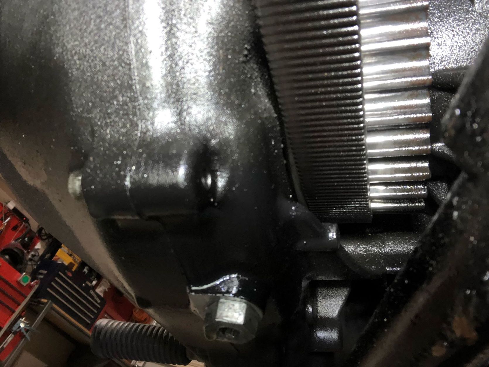

not yet. I ordered a new inner primary seal, derby cover gasket, primary gasket kit, and a new shift shaft seal. I am going to wash the crap out of it, run it to the bar and back so I can get a trace of where is comes out from and then change everything. like I said before though, I have gotten it to stop but as soon as I run it hard across state lines it starts all over again. the trans bearing is back ordered and must come from china because there is no eta on when they are going to be able to fill that order. (I placed the order for the bearing over a month ago)

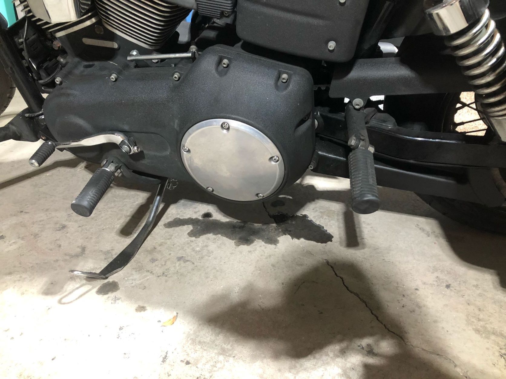

sorry about the size. the oil spot under the bike is 24 hours of sitting

It's difficult to trace exactly where it's coming from. Had a leak like that twice myself (2007 DYNA FXD) and both times it was the shift shaft seal. Have you replaced that seal before, yourself. It's not difficult, just have to remove a lot of **** to get in there. I bought the tool that seats the seal. I also wrapped the shift shaft with electrical tape so as I slipped the seal over the shaft it would not tear on the splines. Did this because I read that the slightest tear will cause it to leak.
Good luck, will be watching to see how replacing all those seals deals with the problem.
