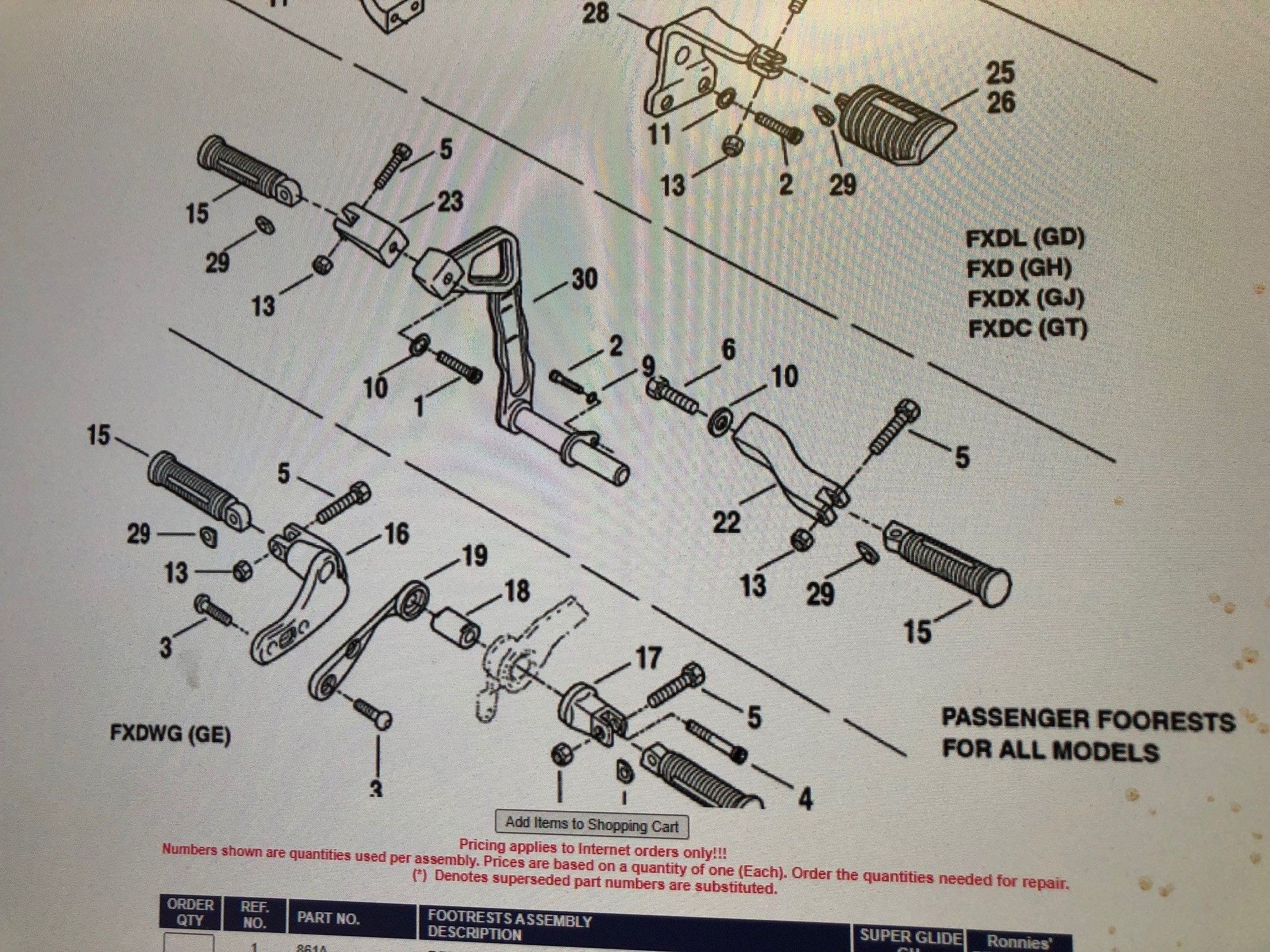

Don`t know the answer but here`s how it bolted up

Yeah thanks, ive been looking at the sketch and i wanna remove #22 and #30. The bracket #30 is just one screw i think and i dont think there is any part on the other side or under that is affected. It is just if the bracket itself is useful for something as being a belt guard or such.

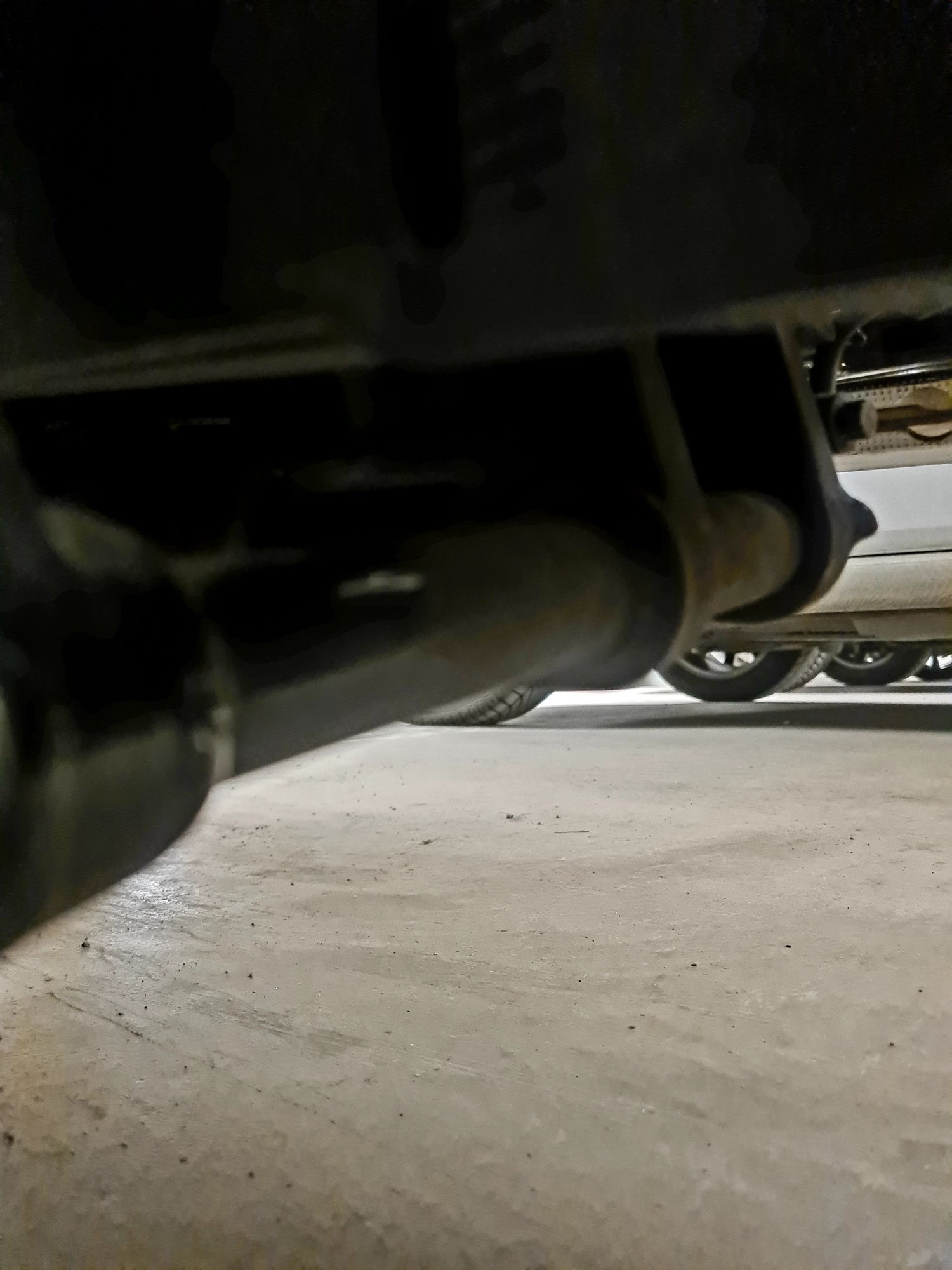

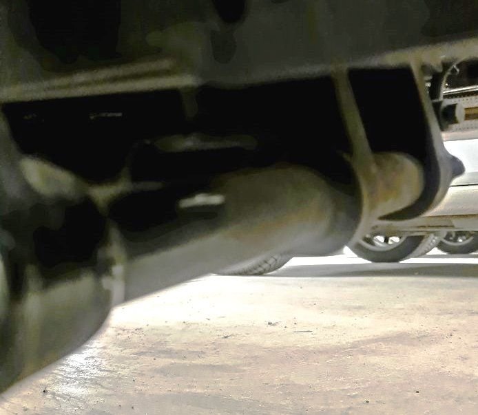

Thanks but where do this go? As I understand this piece is to secure the upper belt guard to the frame or such?
Removing the bracket underneath does not affect the upper belt guard on my bike when i look?
​​​Here is a pic taken underneath

I can't really tell what is what in your pictures. So you may not have the issue I had when I removed my rear peg but that may be why the bracket is only needed for the 06 and up. On the 06 the upper belt guard mounted to the back of the passenger peg but looking in to it I see on the 05 it didn't. Here's a thread about your specific application though. https://www.hdforums.com/forum/dyna-...ide-glide.html

That bracket is for a 2006 and later. 2005 looks like the belt guard bracket is welded on, not bolted on to the swing arm: https://shop.suburbanharley.com/oem-...e99ffc10d56c/y
