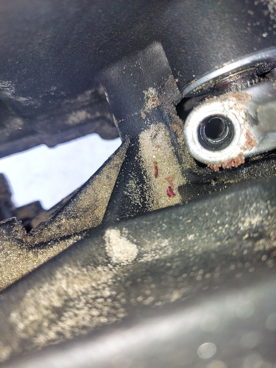

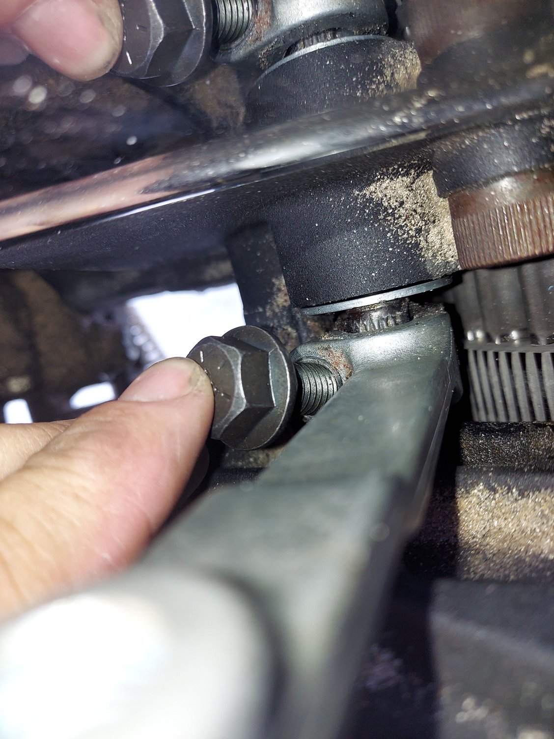

Has anyone had success getting a lock nut underneath the lever? I looked under and didn't see a way. Mine is currently stripped. Thanks.

Put the bolt in yer pocket. Now go to the closest hardware store. Look at the nuts & bolts. Take out yer bolt and find a longer one, the find a lock nut to match.

So. I haven't attempted yet but considering that I can't seem to get the nut on from below, I should be able to get it on from the side? Thanks again.

That's living down a dirt road.

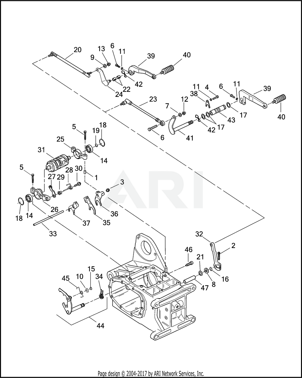

You need to get an Allen head bolt so it will fit in there for part #6 If that does not work, buy a new part # 39, $62.00
Or are you talking about part #32?

You mean 32? I'll probably end up tapping the linkage first. Next will be removing the primary. Just looking for a quick fix if at all possible.

Looks like adding a nut "might" hit the primary cover when down shifting. Below quote is from another thread = no need to remove the primary. Maybe remove the lever, and if it has enough material you can repair the threads with a Heli coil, Keensert, or whatever.
Originally Posted by Frozen Crome
I then loosened the trans shifter arm and with a 90 degree screwdriver I was able to pry the splines open a little bit. I tipped the top of the shifter arm towards the engine and there was enough clearance to sneak it out. The new shifter arm was never compressed so I did not have to pry it at all I just put it down in there at an angel and it slid right on no problem and I did not have to force anything it went right together about an hour and a half.
Harley-Davidson® >> 2002 >> DYNA >> FXDWG 1GEV DYNA WIDE GLIDE (2002) >> GEAR SHIFTER
https://shop.suburbanharley.com/oem-...fe4b2870b085/y
Ref: 32
33849-97
LEVER SHIFTER ROD
Ref: 2
856A
SCREW 5/16-24 X 1 SOCKET HD. (GRADE 8)

Couple of questions:
Is the bolt hole stripped or the part of the linkage that goes around the splined shaft?
How did that bolt get stripped?
Why are you showing a flanged bolt and not the original bolt?
