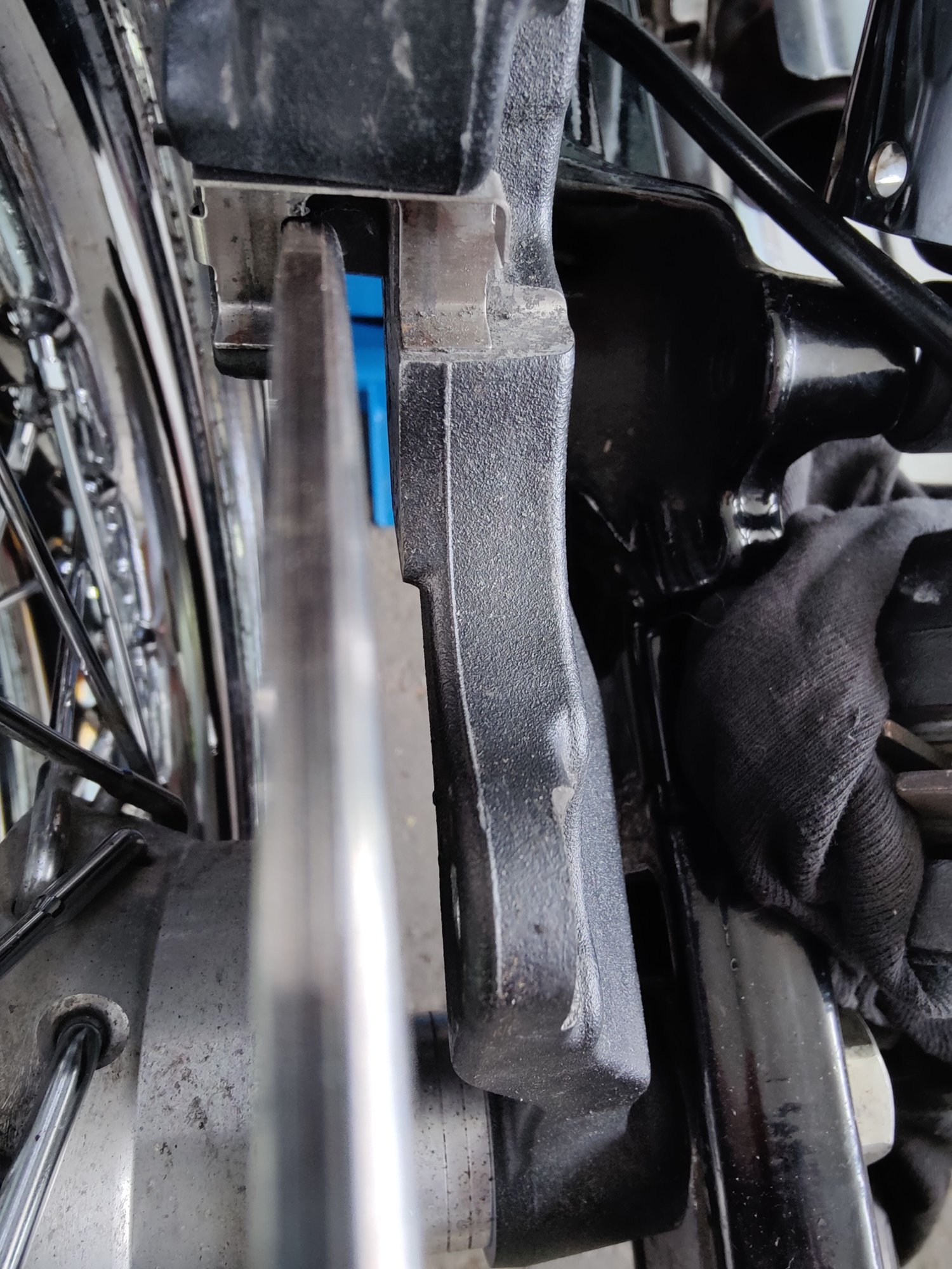

Yes, you need to be careful with heat. Just heat gun.
Here are few pics from rotor side.

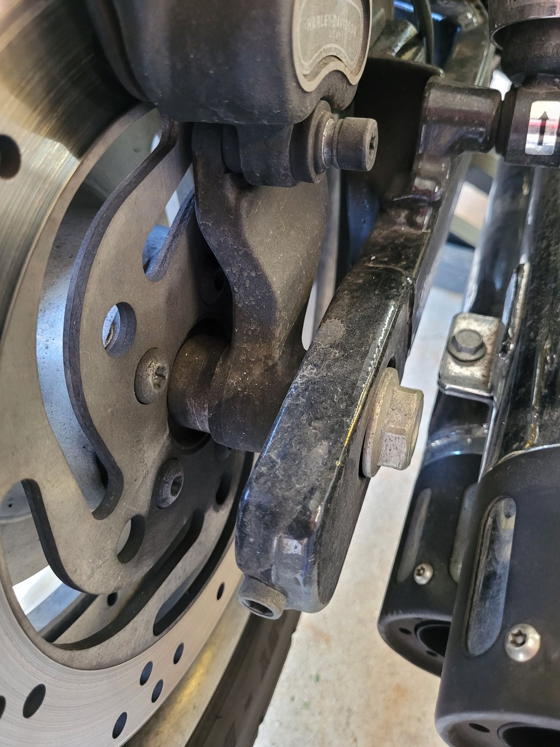

Here's a pic on my 08 Fat Bob before I removed my wheel and you can clearly see the bearing is not flush, it's deeper into the hub

This is a blown up pick of my 2015 street bob when I got it. It sure looks like the bearing was further in as well.
