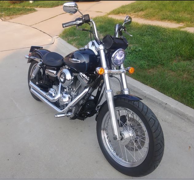

A month or so ago I did exactly what you're planning.
Make sure you get the dimpled bars if you're using factory controls. The wires need to tuck up into the dimple.
I didn't have to extend any cables or wiring, I just had to crack the brakeline loose and adjust the angle (hopefully that makes sense)
. I even added a 1" spacer under my risers.

Which handlebars did you use? Your Bike pic is exactly what I want mine to be like.

I used the TC Bros. 1" Narrow Mini Apes Handlebars 8" Chrome Dimpled.
I bought them from TC Bro's ebay store.

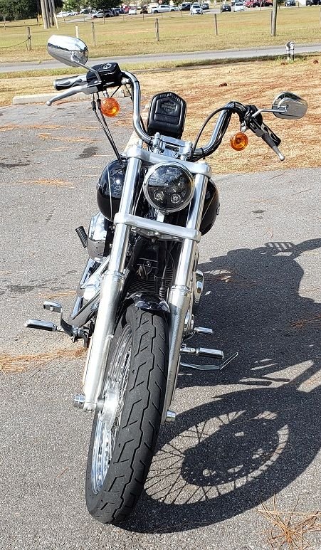

Old Oct 17, 2022 | 02:59 PM
Nailz's Avatar
Nailz
Joined: Oct 2005
Posts: 376
Likes: 138
From: HEADLAND, ALABAMA
Got them installed. This is a big improvement to the Buckhorn style for me. I didn't like the buckhorn bars at all. Stock cables and brake line. Easy fit. I love them!
