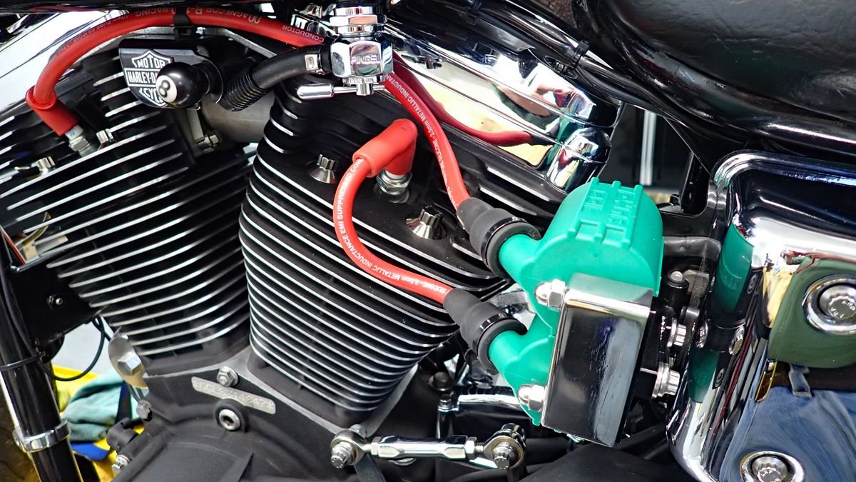

Originally Posted by StanC
For a 2000 Dyna Wide Glide
@DK Custom has some nice Spark plug wires.
I replaced my worn out wires a few months ago on my 09 Ultra, the connecters in the boots were getting pretty weak.
The DK wires were a bit too long, so I looped them at the coil. See pic.
When these are installed onto the spark plug, there is satisfying click, unlike the worn out OEM wires.
If I had it to do over again, I would get the Universal Kit so the wires could be trimmed to the exact length of the OEM wires.
Or, you could just go to the dealer and get an OEM set.

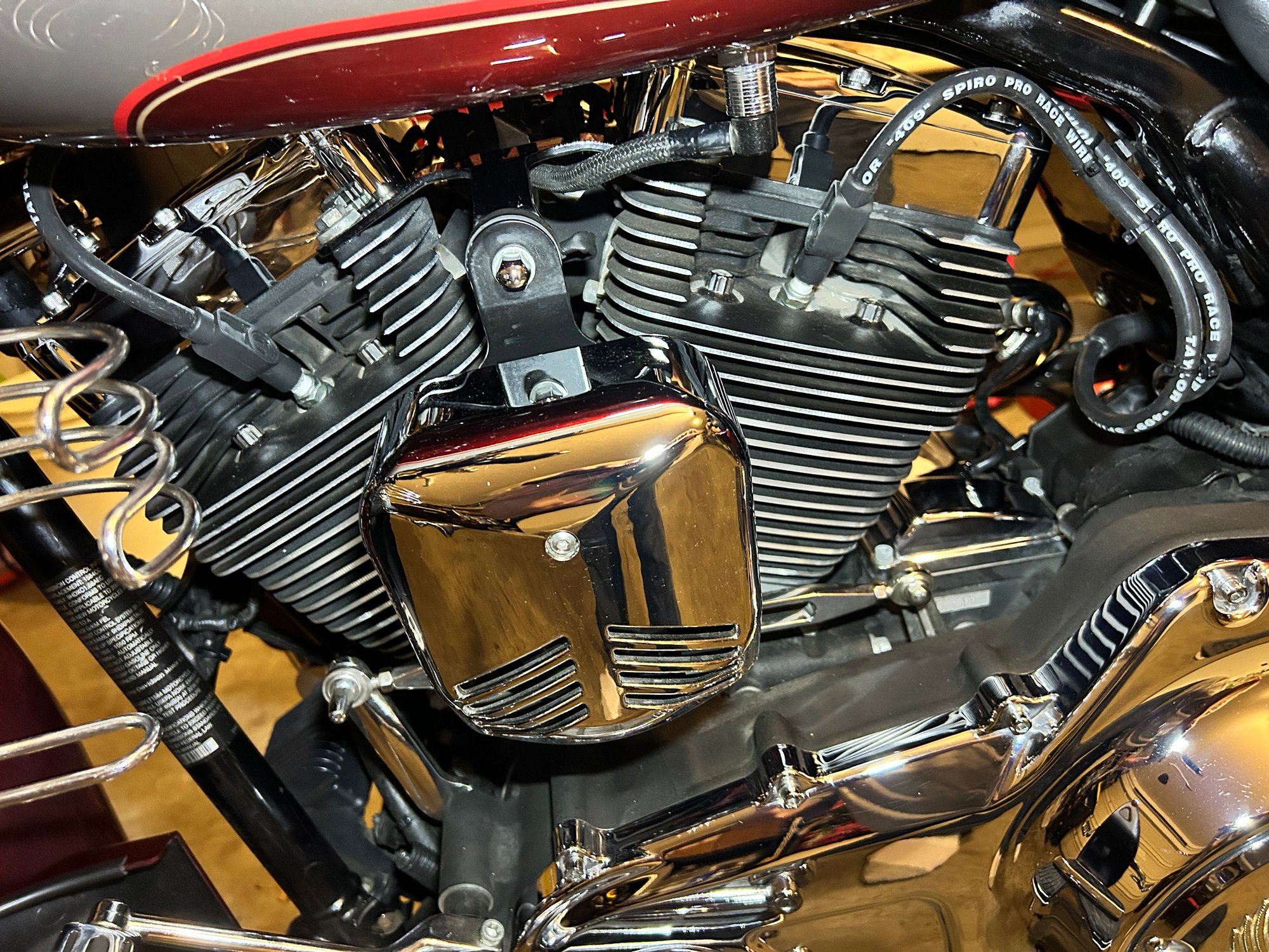

I had Magnecor make this set for me a couple of years ago when I changed coils, there was a set of SE 10mm on there when I bought the bike and they did not fit very well with the new coils.
There were routing issues with the SE wires as well so one had a pretty good chaffe in it. It's a bit hard to see in the photo but I replaced the washer on the top engine mount with one I made that acts as a standoff, it extends out from the head and has a hole drilled in it for a push mount ty-wrap.
This gives me the clearance I need so that nothing touches the wires when the motor is vibrating, rubber mount after all.
