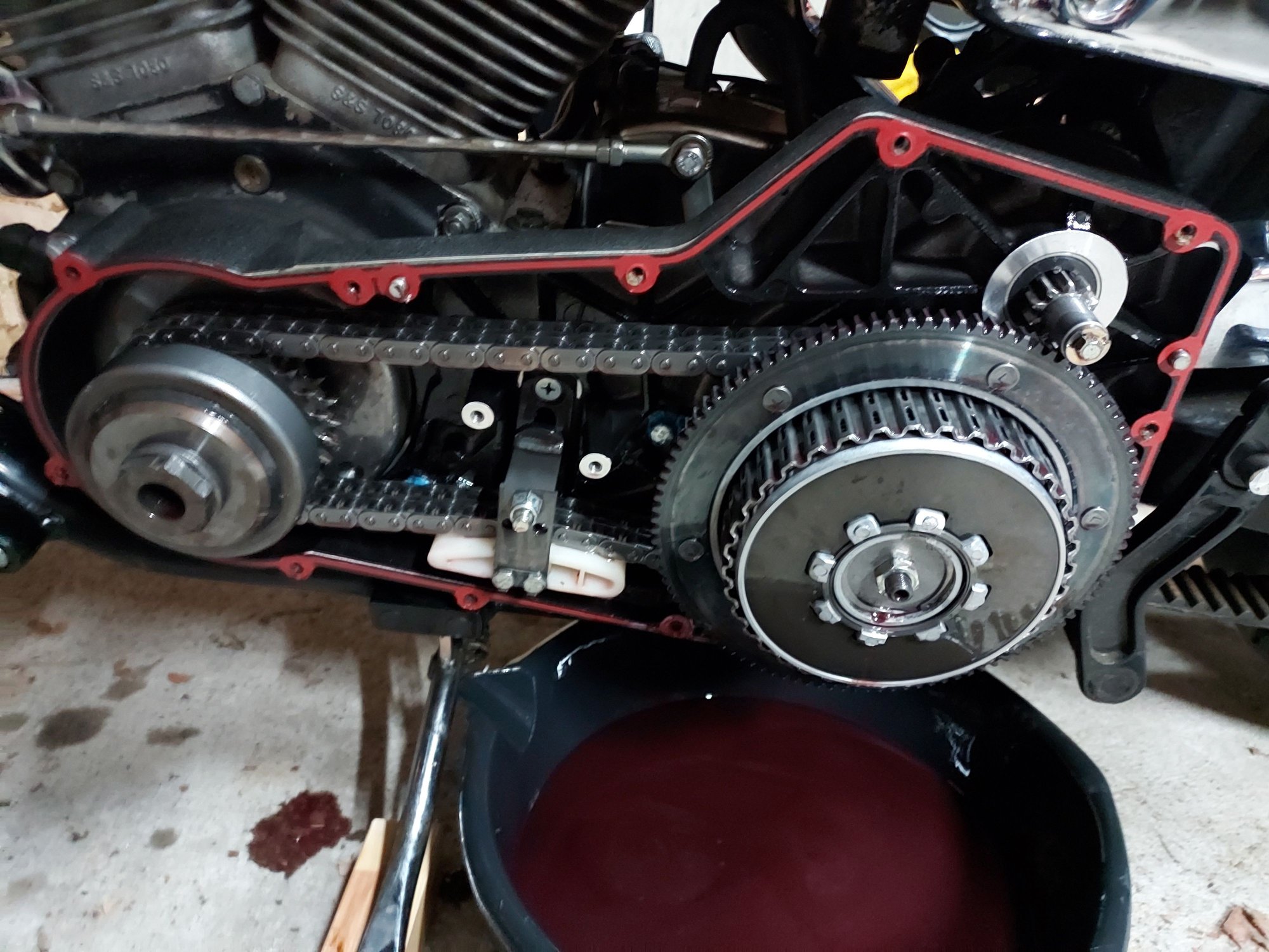

this doesn't look like the clutch in my flh...
So, what should I do next in search of this terrible noise, pull the clutch and chain?

Disassemble and inspect the clutch pack.

That is a stock clutch.
Disassemble and inspect the clutch.
Starting it will just sling oil all over the place, besides, you already know the noise comes and goes with clutch engagement/disengagement.
You will need a clutch spring compressor.
Clutch spring compressor
The clutch hub retainer nut is 1-3/16".
The so called "Grenade Plate" is item 22 in the illustration.
Illustration

This is very helpful. I'll rent the tool today. Thank you.
