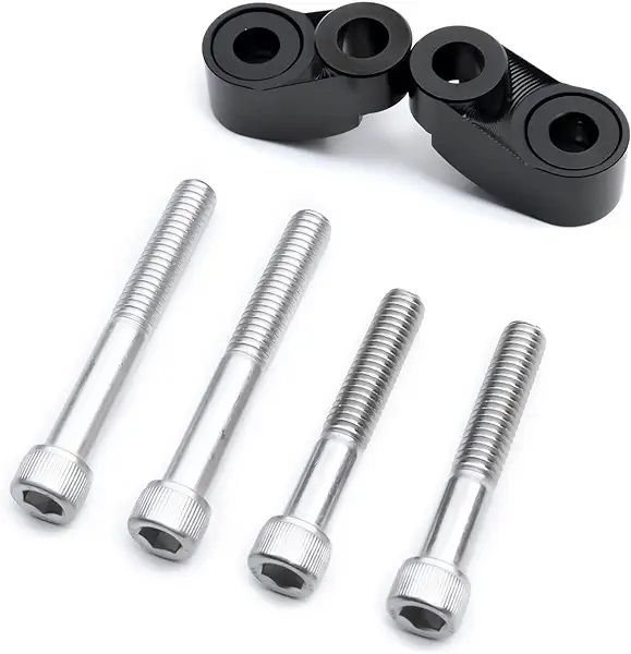

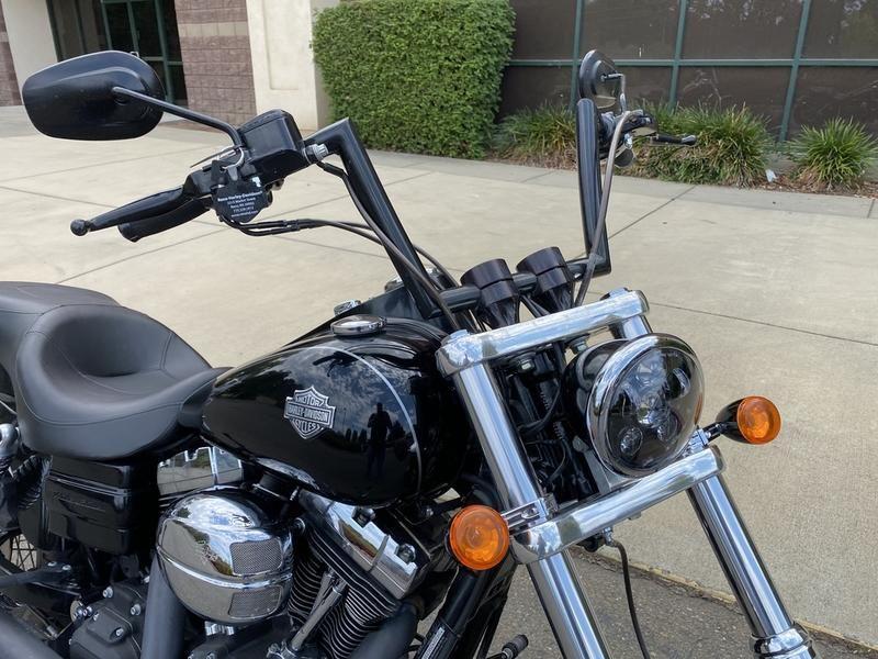

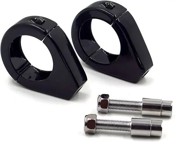

Amazon, eBay and many other aftermarket sellers have kits for relocating turn signals. There are generally two basic styles. One style mounts on the triple tree pinch bolts and the other clamps onto the fork tubes in various sizes. I use the clamp style in 49mm on my 2010 FXDWG. Your existing cables should reach. Mine did. You can see the turn signals on my bike in the picture. Good luck.
Pinch Bolt Style
Fork Tube Style.
