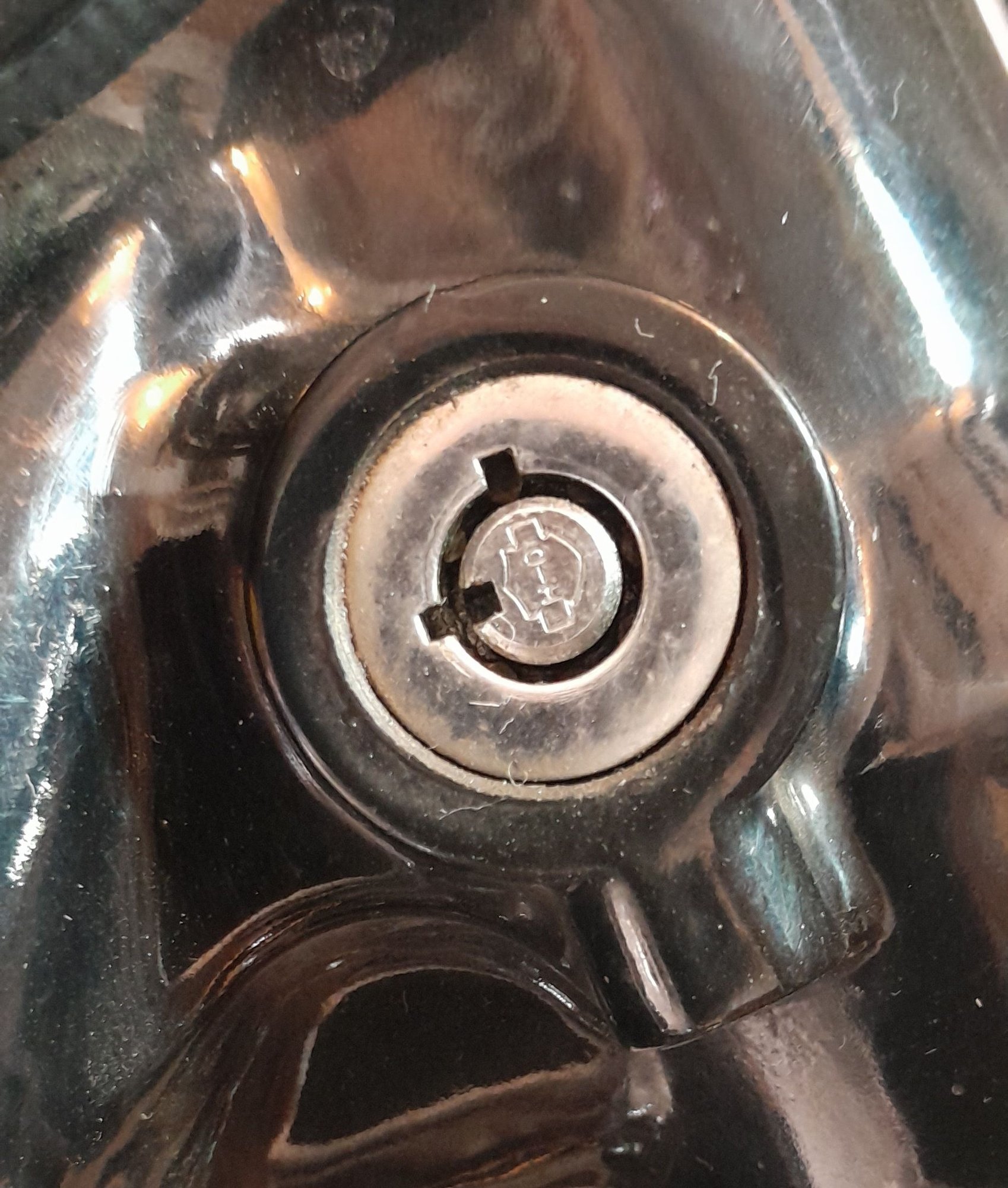

Are you sure you have the correct key for your bike?
I don't understand how the slots are not lined up.
On my 2000 model Dyna the top photo is the unlocked position (key turned counterclockwise).
Here's a suggestion: If you have two keys make sure they're both the same. File or grind off the little stud on the top of the key.
Shoot some WD-40 or similar lubricant into the lock. Let it sit overnight.
Next day, insert your key. Push it in and out a couple of times. You should feel a little bit of spring action in, and out (I feel that on my bike). Then try to rotate the key. If that doesn't work, take it to a locksmith.

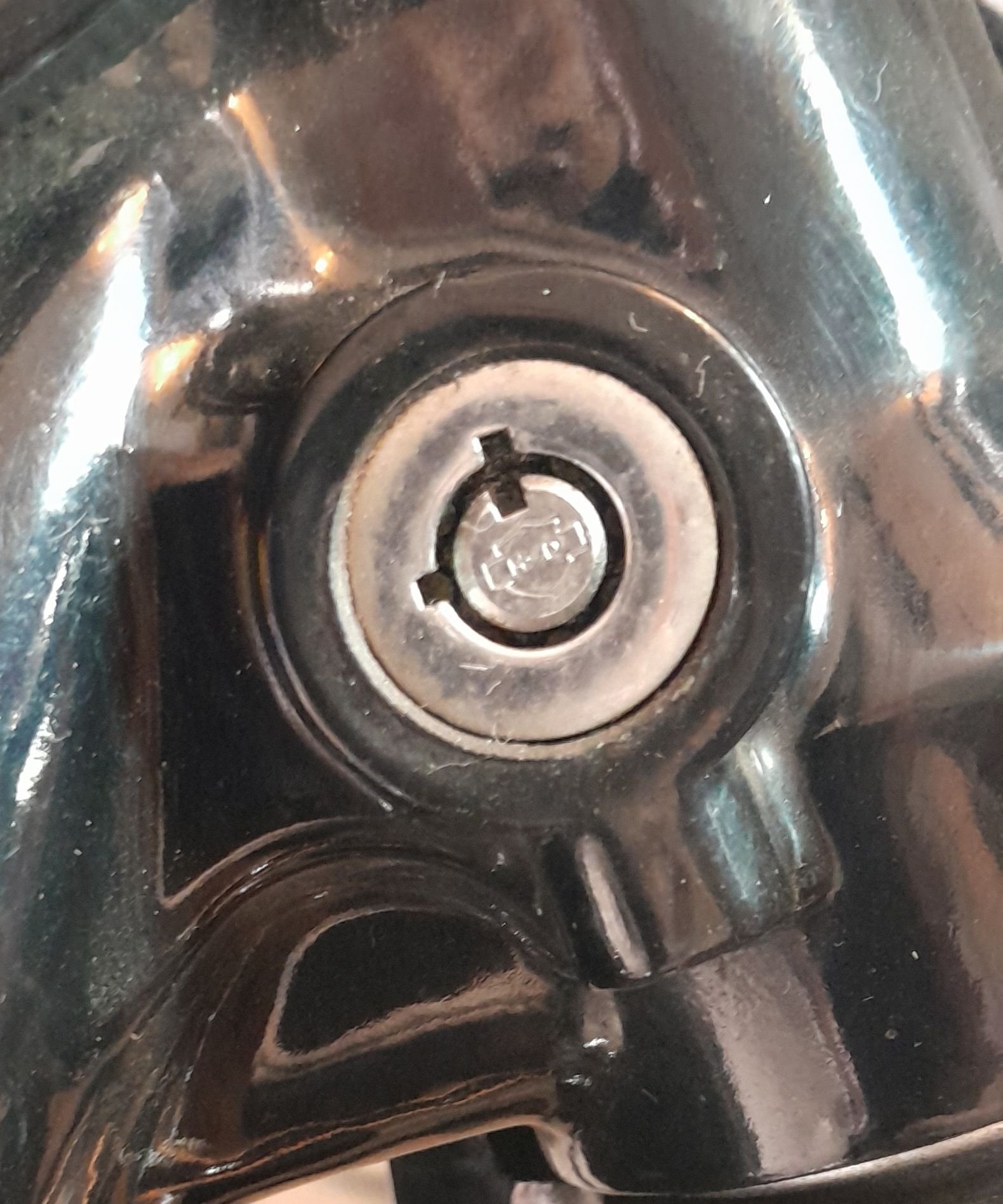

After rethinking my last post, I will restate:
A "tit-less" key as previously described is the way to go. The tit inside of the barrel key will still be there and will align with the slot in the inner cylinder of the lock (see my pics).
Insert the tit-less key and turn it to align the lock slots.
