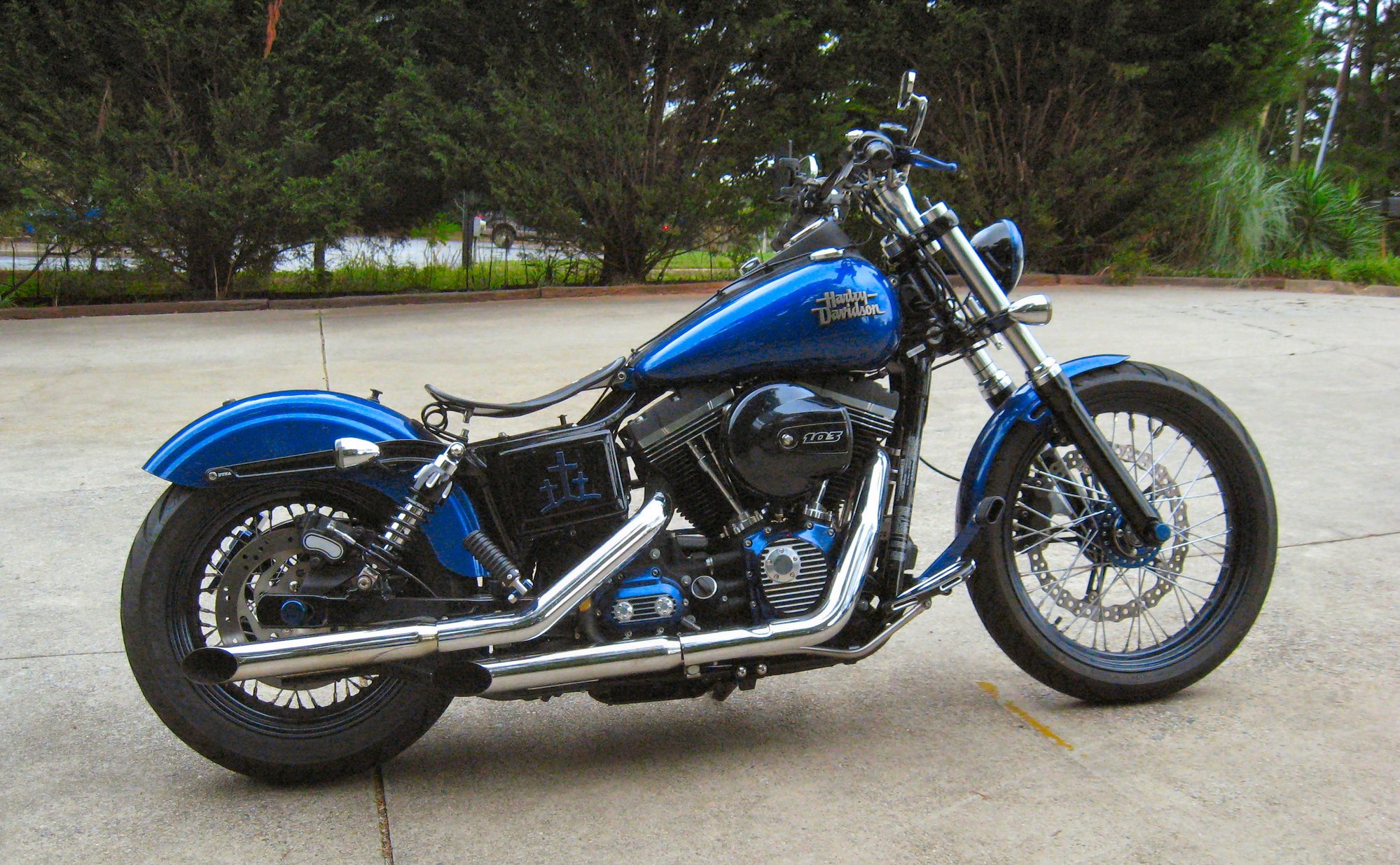

Another way to lower the rear without losing shock travel.
