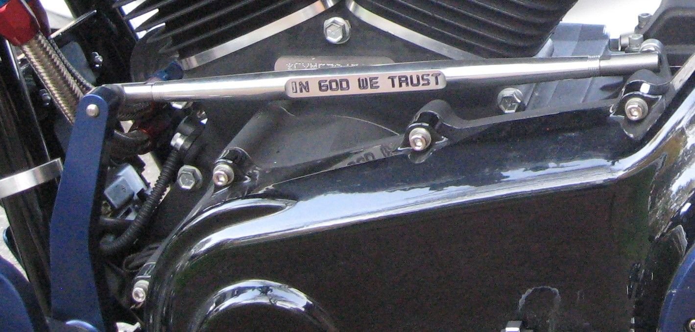

I made my own and looked at hundreds of rods before I started.
Great work friend, mine won't be nearly as pretty. But.........I have thought of using brass rod for something different.

I was gonna say Blue Bob has a good handle on metal stuff
Just curious....
Why did you keep the OEM style ball joints instead of switching to heim joints...?

Just curious....
The ball joint looks much cleaner and very easy to source and replace.

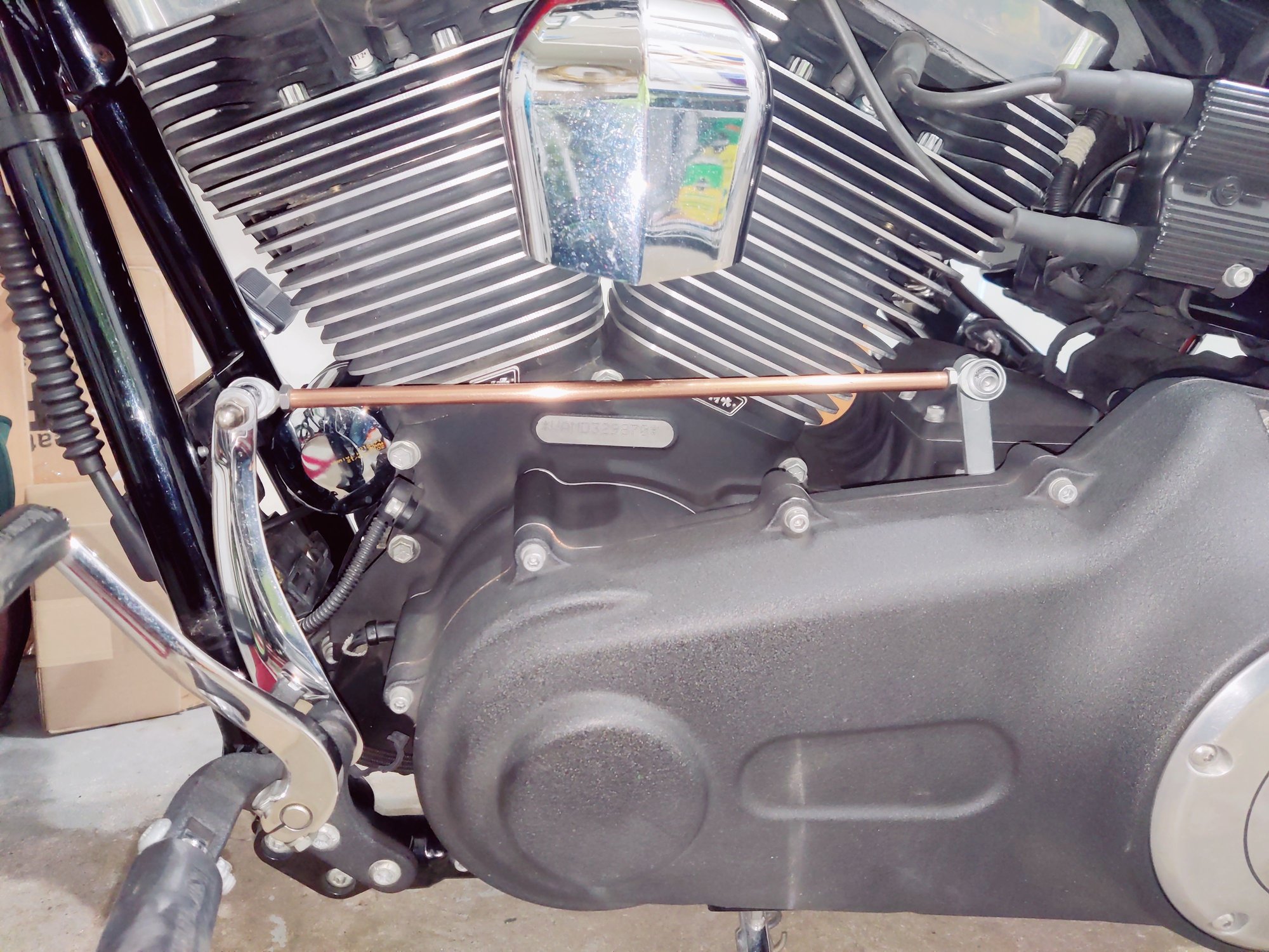

Yeah the moco linkage is crap.. It wears out way too quick.. I made mine with thick walled copper tubing and stainless heim joints.. It's a nice little added accent..
