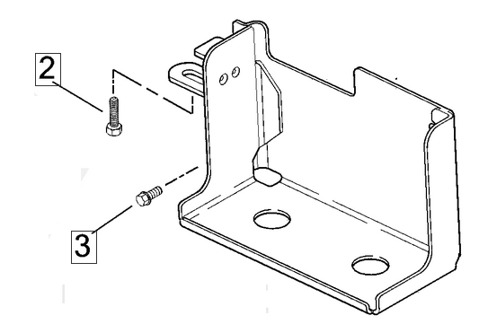

Does anyone know the size of the 2 bolts, that you need to remove, on the 2004 dyna wide glides battery box, when changing the battery
No room in the garage this year and
I took the battery out when it hit 15 degrees and snowing, and couldn’t find the bolts when they got bumped into the snow.
All my google searches keep giving me the battery terminal sizes.
I can’t think of anything else to call the the that attaches to the frame that holds the battery, other than a battery box or battery tray.
Thanks in advance for any help

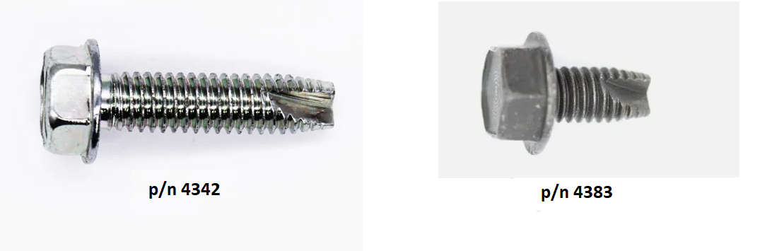

Here are the partnumbers and specs for the bolts that hold the battery tray to the frame (see image # 2 and 3)
Image # 2: p/n 4342 screw no. 16-18 X 1 1/4 hex washer HD
Image # 3: p/n 4383 screw 5/16-18 X 5/8 hex hd w/washer (grade2)
