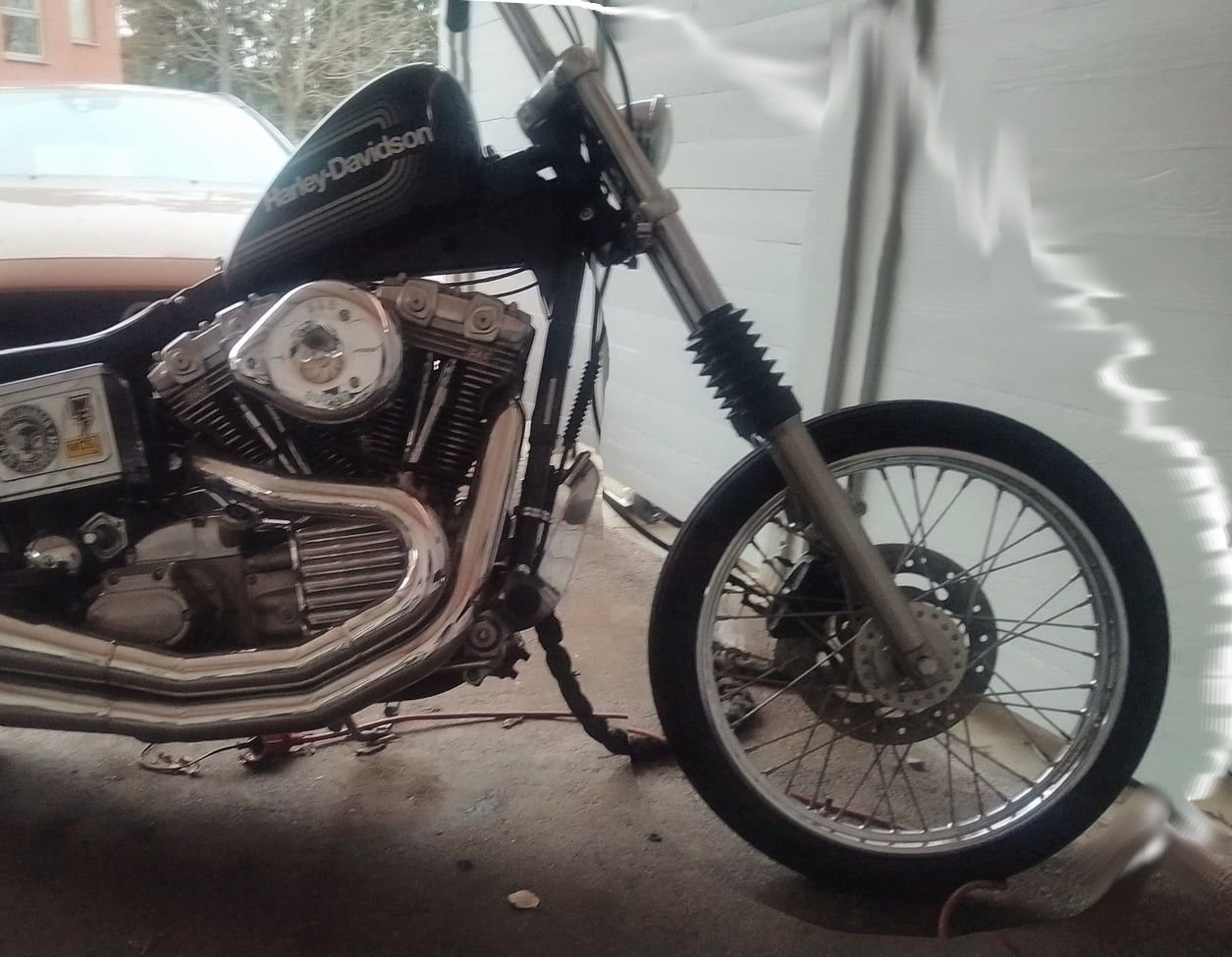

Photo of what it looks like now:

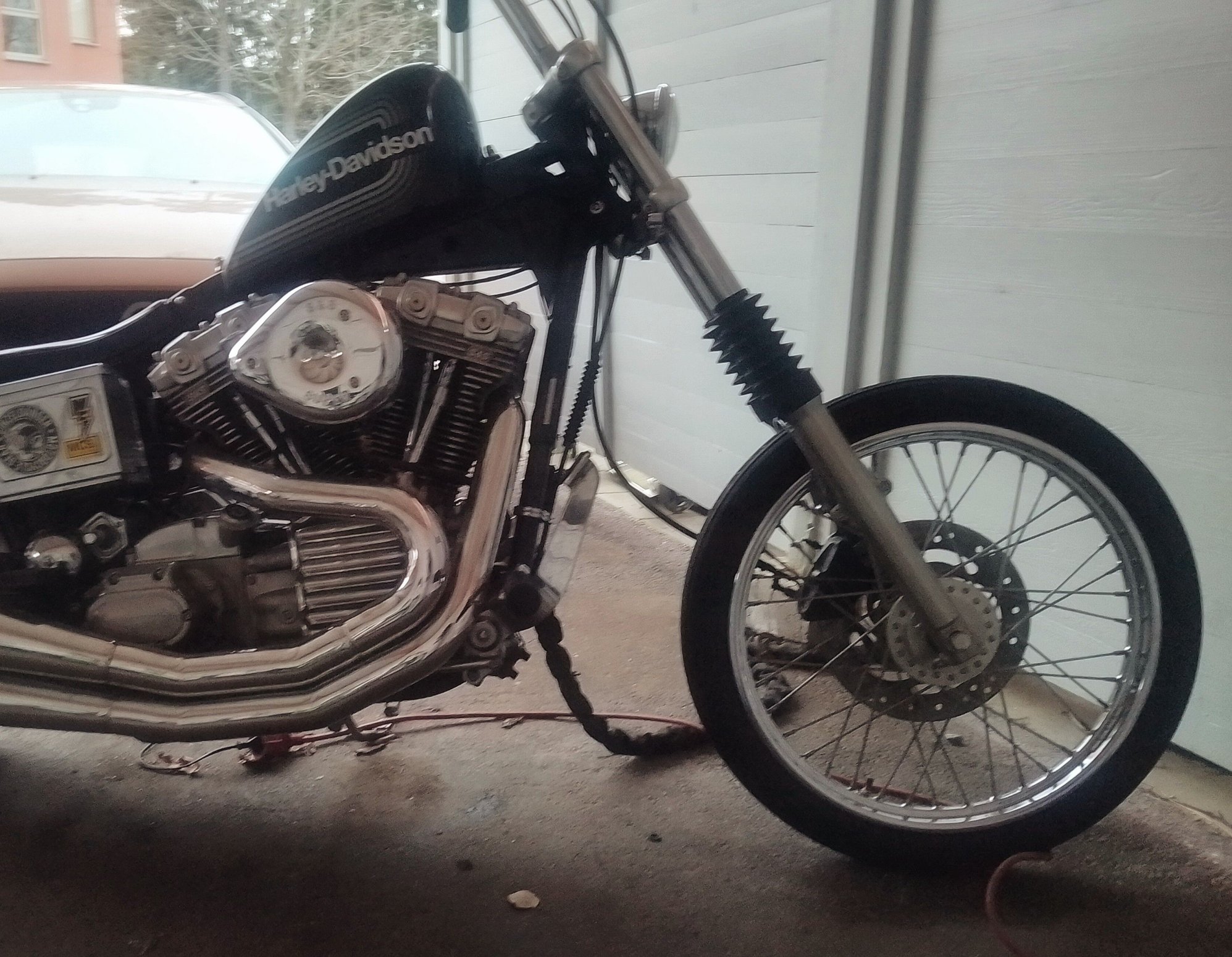

What it would look like with 3 degree less rake, please disregard my sub par photoshop skills
