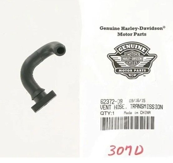

The transmission vent hose is a short pre-formed hose that exits the transmission top cover. It's not long enough to be routed below the transmission.

Unless someone changed it and put a longer tube in, that is not the trans vent.
Agreed. My FSM just calls it a vent line but i have determined that it is the same line that comes from under the fuel tank console and has the inline check valve at the steering neck.
That little tube is clean and intact right next to my starter. No sign of anything leaking out of it.
I have attached what I believe to be the answer. These both came from Yamaha sportbike websites, but i would imagine it applies here. They claim that water condenses inside the fuel tank vent tube and mixes with gas that has broken down due to heat and becomes a jelly-like substance that drips from the tube and makes people think its oil...
