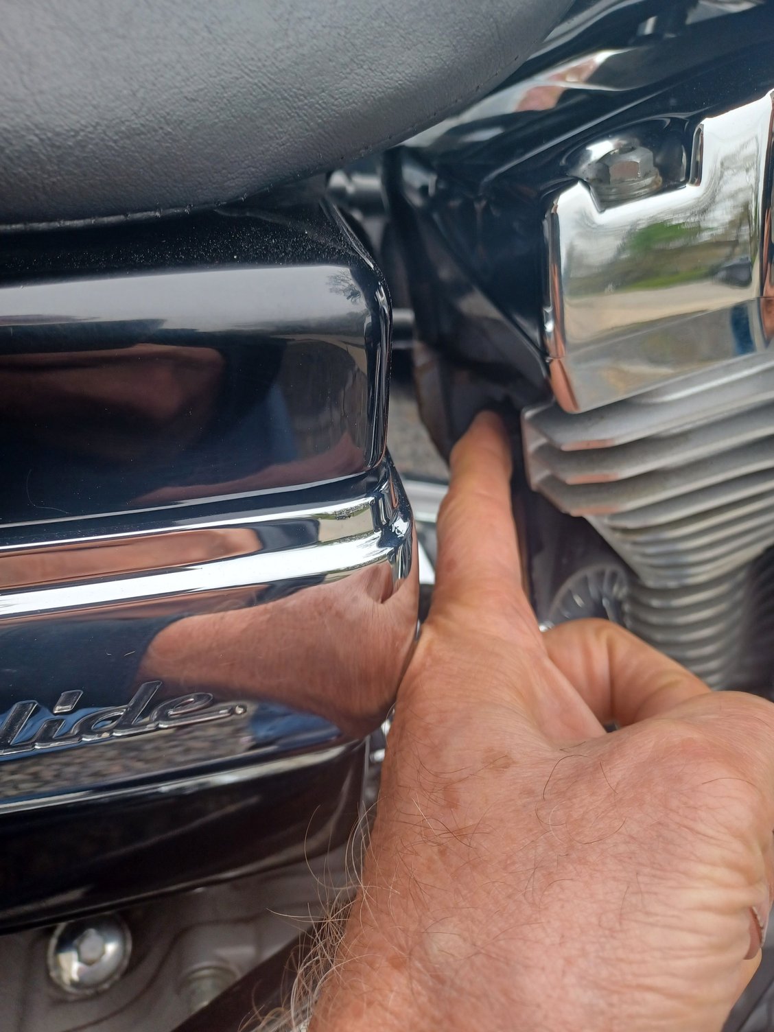

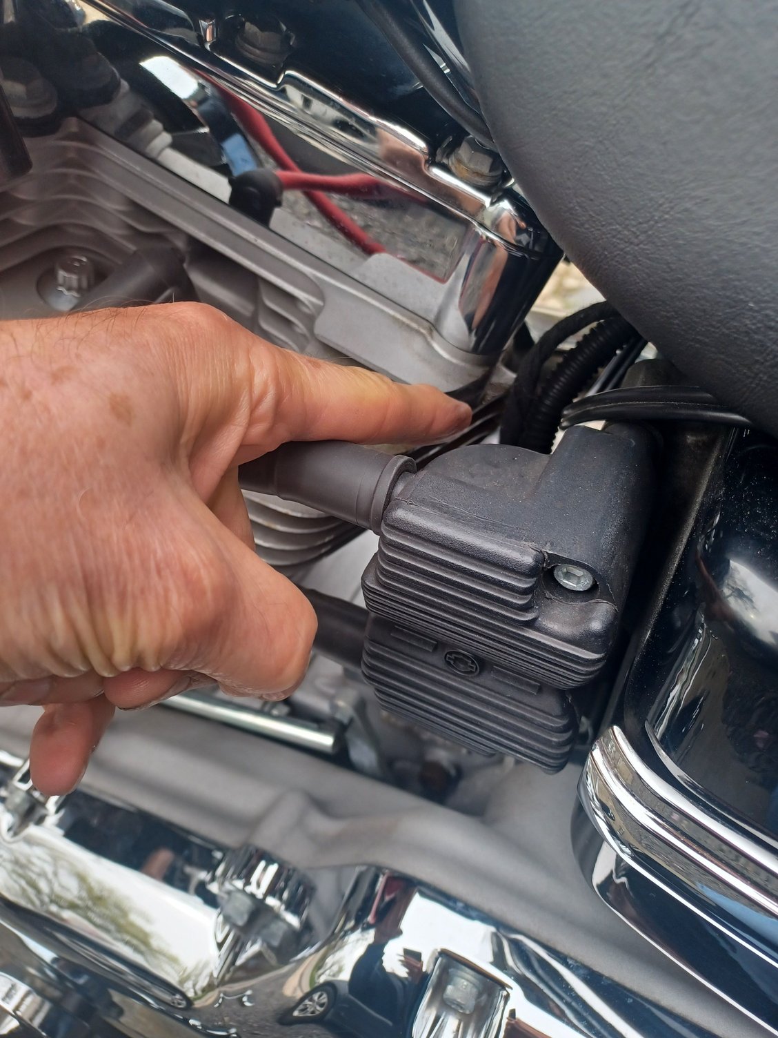

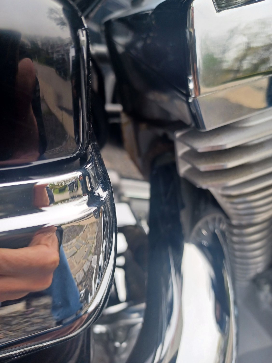

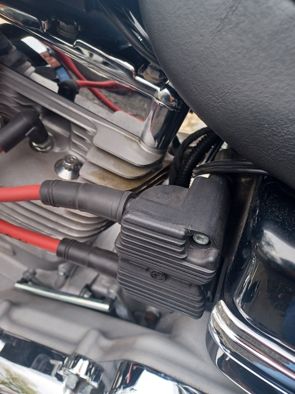

hi ok heres some pics. ssee oil on fins cant quite tell if its from cover or heads ill investigate later when i can and post update

Spray down with brake clean, go for ride. That may tell you where it is coming from, or make you not care.

Looks like a lower rocker box leak. I wouldn’t say 16k is barely broken in. Mine went at 20k on a sportster I had. As said earlier, clean the bike good. Then take it for a ride, you should be able to see where it’s coming from. Mine was on the same rear corner. That’s right where some hot oil would pool as it’s parked on the jiffy stand. Over time as the boxes expand and contract the gaskets get weepy there.

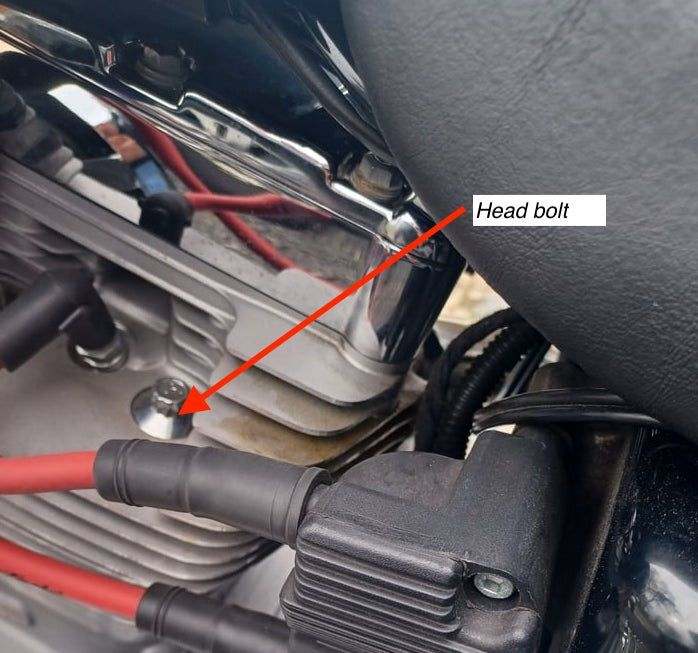

"hi ok heres some pics. ssee oil on fins cant quite tell if its from cover or heads ill investigate later when i can and post update"
Give it a close look over, but that leak is quite a bit above where the head and cylinders mate up with a head gasket.
I marked one of the head bolts in your pic. The head gasket is about 4 fins below that bolt.... Your leak seems to be well above that point. Oil doesn't usually leak UP. So I doubt it's a head gasket...
That looks like a Rocker gasket leak, possibly the the lower rocker base gasket...

Agree with others that it is NOT a head gasket leak. Head gasket leaks are lower. Just went through the head gaskets on mine.
Rocker gaskets much easier to replace. Hardest thing is removing the gas tank. Not a long repair either.
