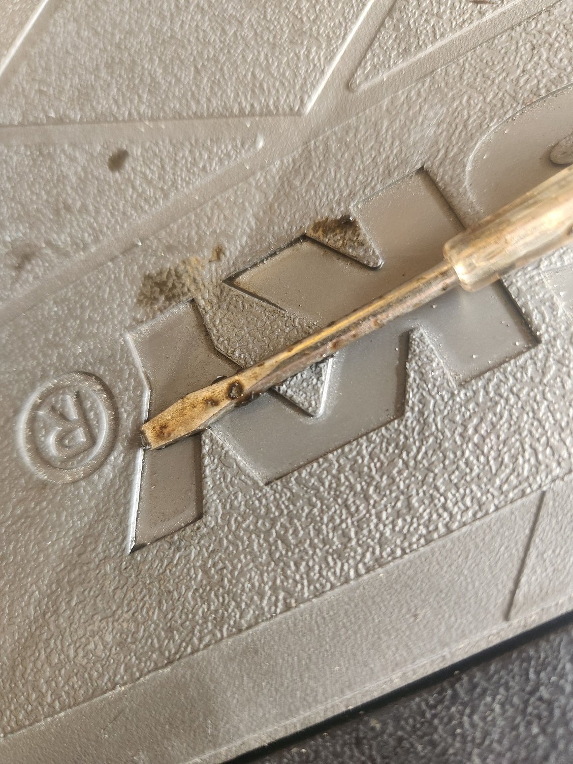

Cut open the filter. Very small to fine pieces. Not a lot though.
The only way out of the cam galley is thru roller bearings. Then one finial milling and rolling process of the return side of the oil pump.
Once in the oil pan under transmission, it's not going thru return side of pump to the filter unless it's floating in pan as it sinks to the bottom of the pan.
Surprised you didn't find some big hunks and it's pin in the cam galley bottom.
Probably ought to inspect pump dimensions and cam roller bearings.

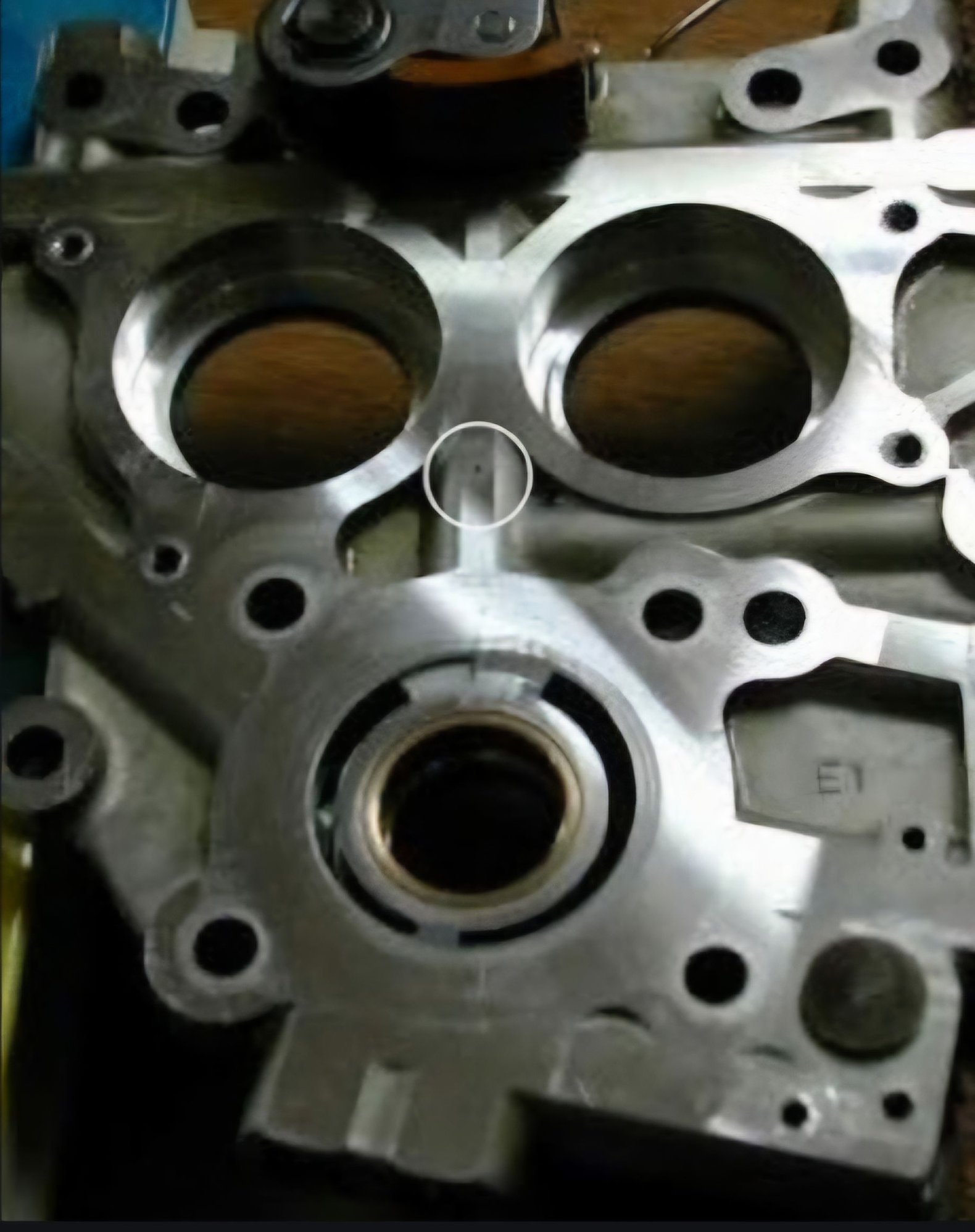

Maybe big enough to clog an oil passage. Look at the size of this oil passage in the camplate. That's a "mister" hole designed to keep the cams wet.
