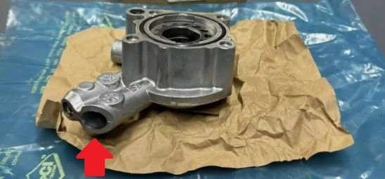

Dennis Kirk shows the Twin Power tensioners, but only has one of them in stock. When I checked about 5 years ago, Twin Power DID use Cyco tensioner pads in these replacements... But a lot can change in 5 years
Dennis Kirk also sells replacements from V-Factor, which based on my personal experience, don't look like Cyco pads...

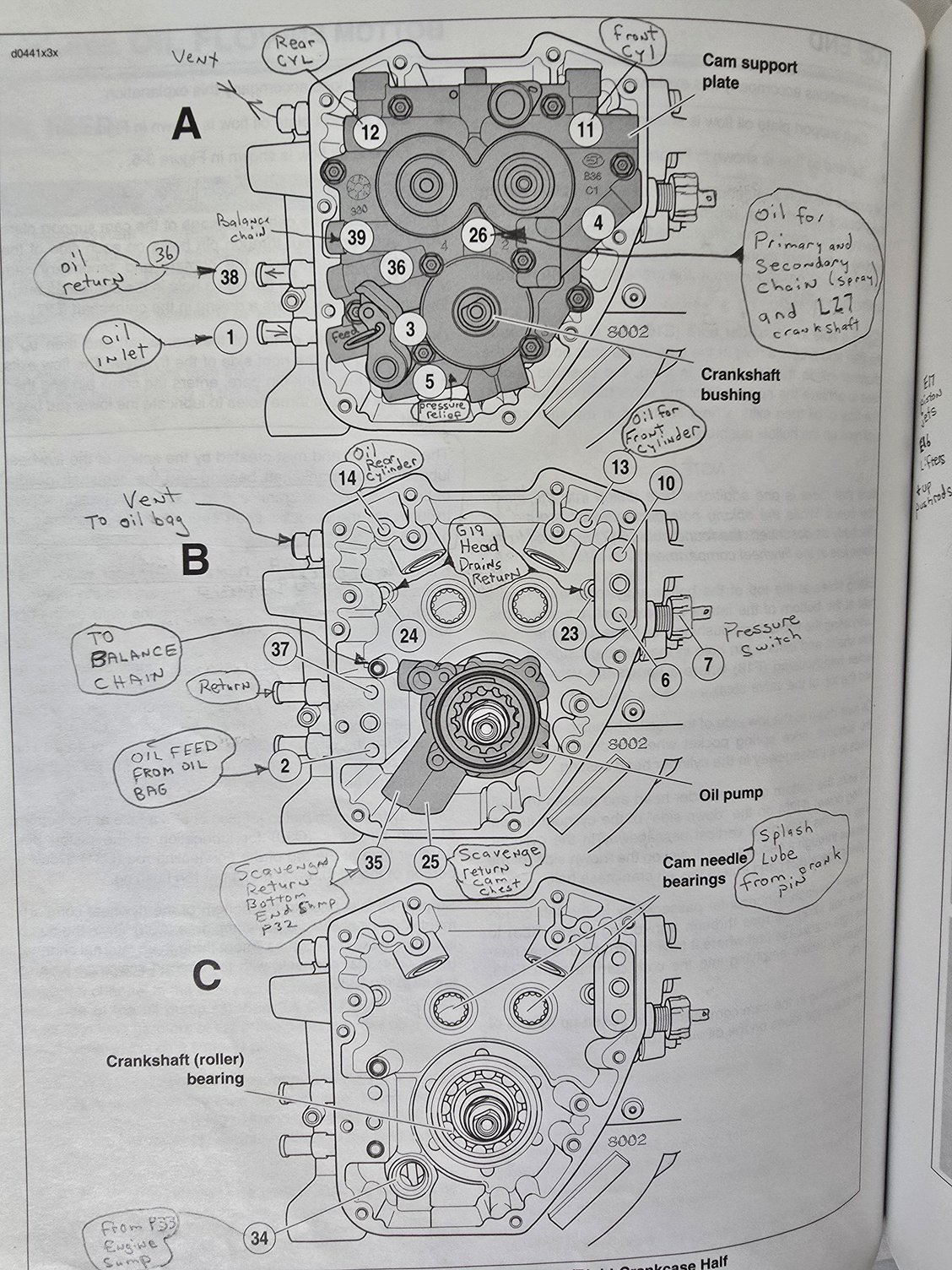

Originally Posted by Jackie Paper
The only way out of the cam galley is thru the crank roller bearing. Fine stuff small enough to float would have to go thru that bearing ,
So you are saying that for oil that accumulates in the cam chest, it must flood the camchest up to the engine roller bearing and find its way out?
Am I missing something here?
What about the scavenge tube on the pump, inside the cam galley?
You are correct. Thank you.
I have only been into 3. And as much oil dumps, I assumed that was were oil went out from the pressure relief spring.
My bad and I have updated my reference.
