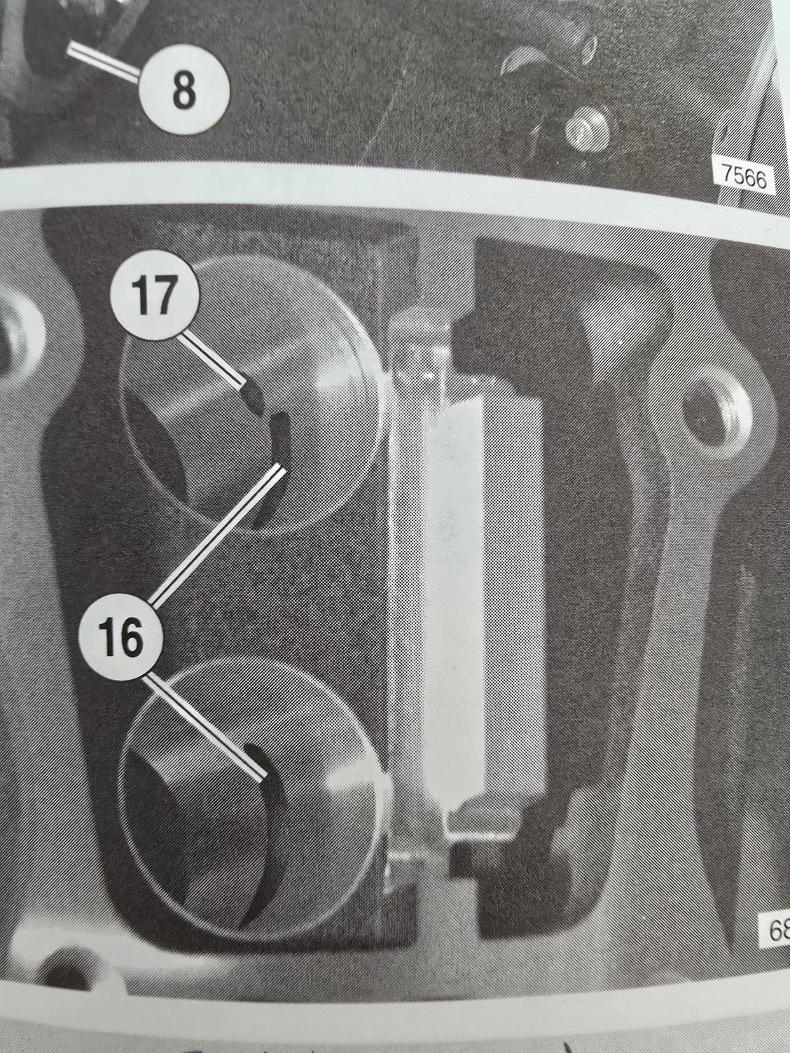

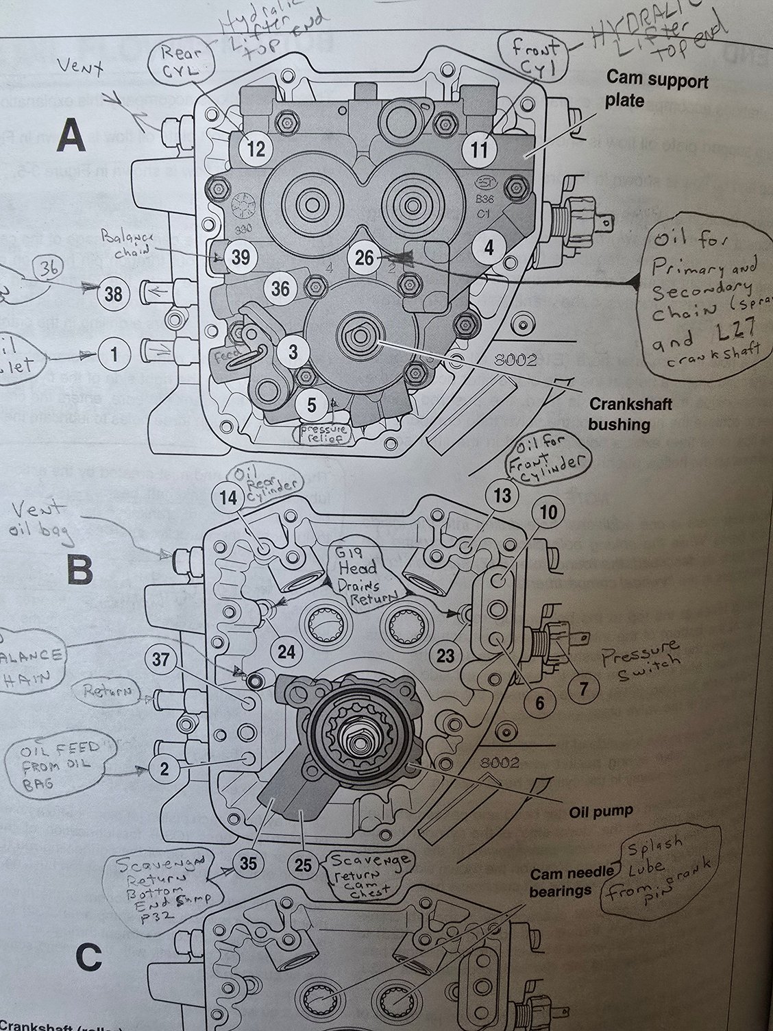

Update your reference to include oil to the lifters.
Thanks. Wasn't too clear. For those that may not know. That's not the actual piston cylinders. (There lubrication comes from splash and in a TC also injectors that work only above idle when the designed 9-12 lb oil pressure gets to 12-18psi.
​​​The following for reference.
In that sketch above, 11 and 12 of the cam plate supply oil to 13 and 14 in the case middle picture and oil enters lifter in this shot 16 and 17.
It keeps lifter at zero lash over rode by valve springs pressure. The excessive oil goes up the hollow pushrod and lubricates the rocker arm box area.

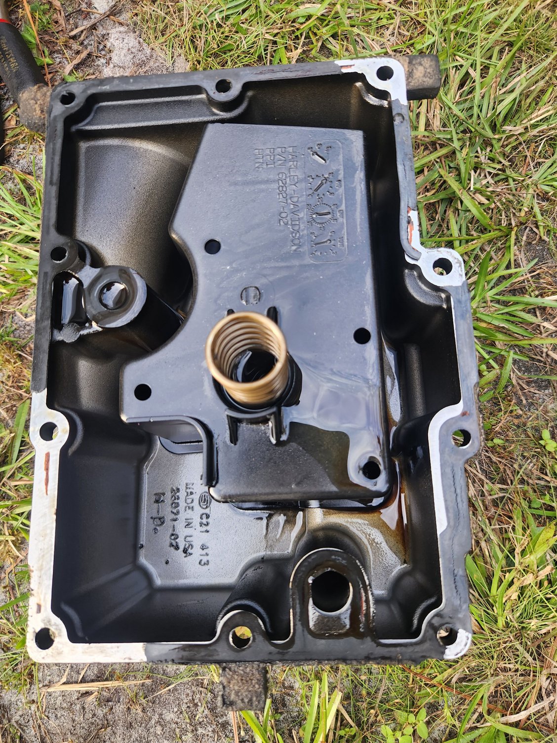

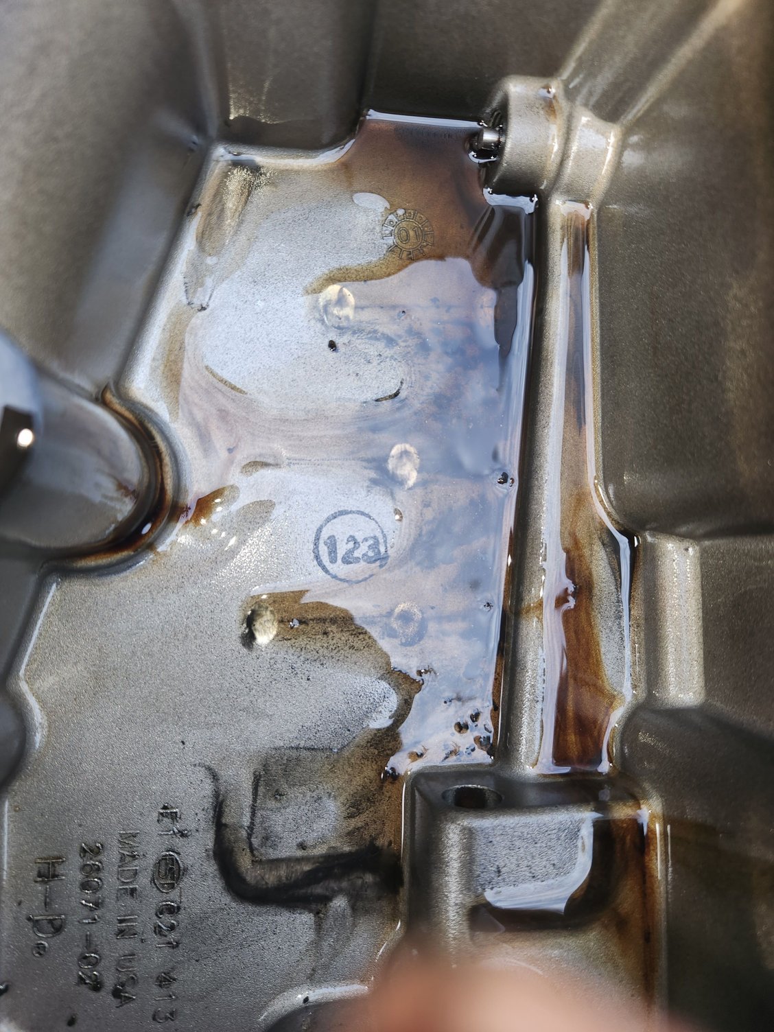

I ended up dropping the oil pan. Not too bad.
Could you use diesel instead of kerosene to flush through the plugs?
you could. People use diesel for stuff like that frequently. But diesel is a dirty fuel. Kerosene might do a better job.
