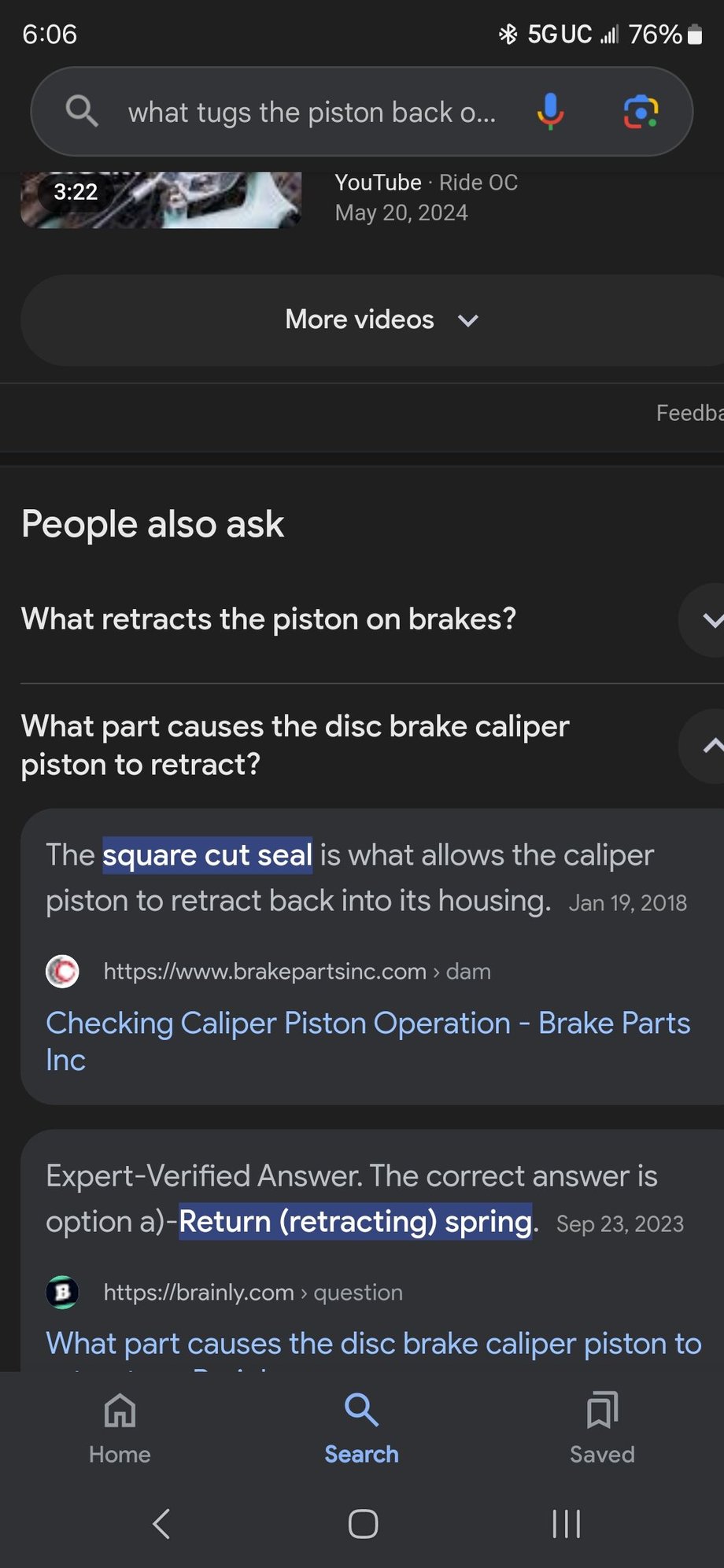

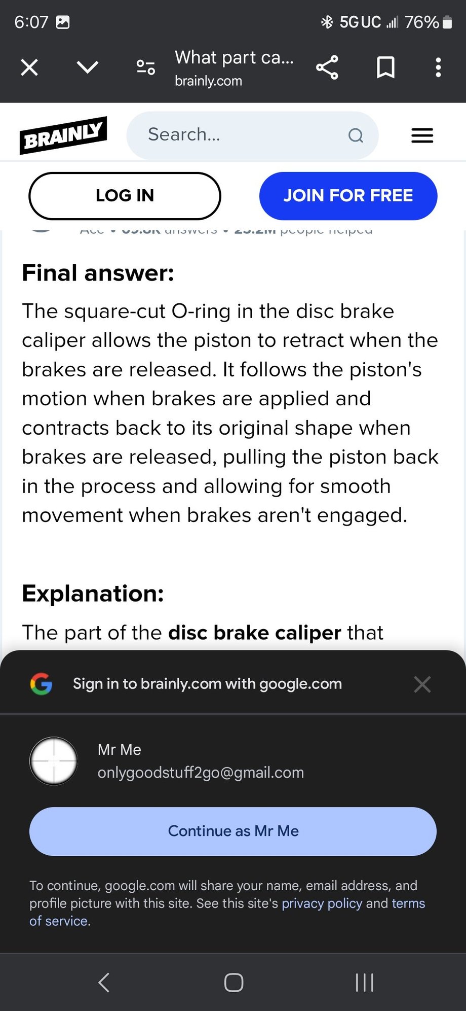

The square ring seal and some even have V indentation on the 4 sides is what tugs the piston in the caliper back off pad. Not far but it does take pressure off pad.
