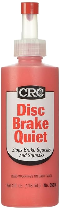

I used this stuff when I replaced my pads this spring,,,,,, "silence" !!
