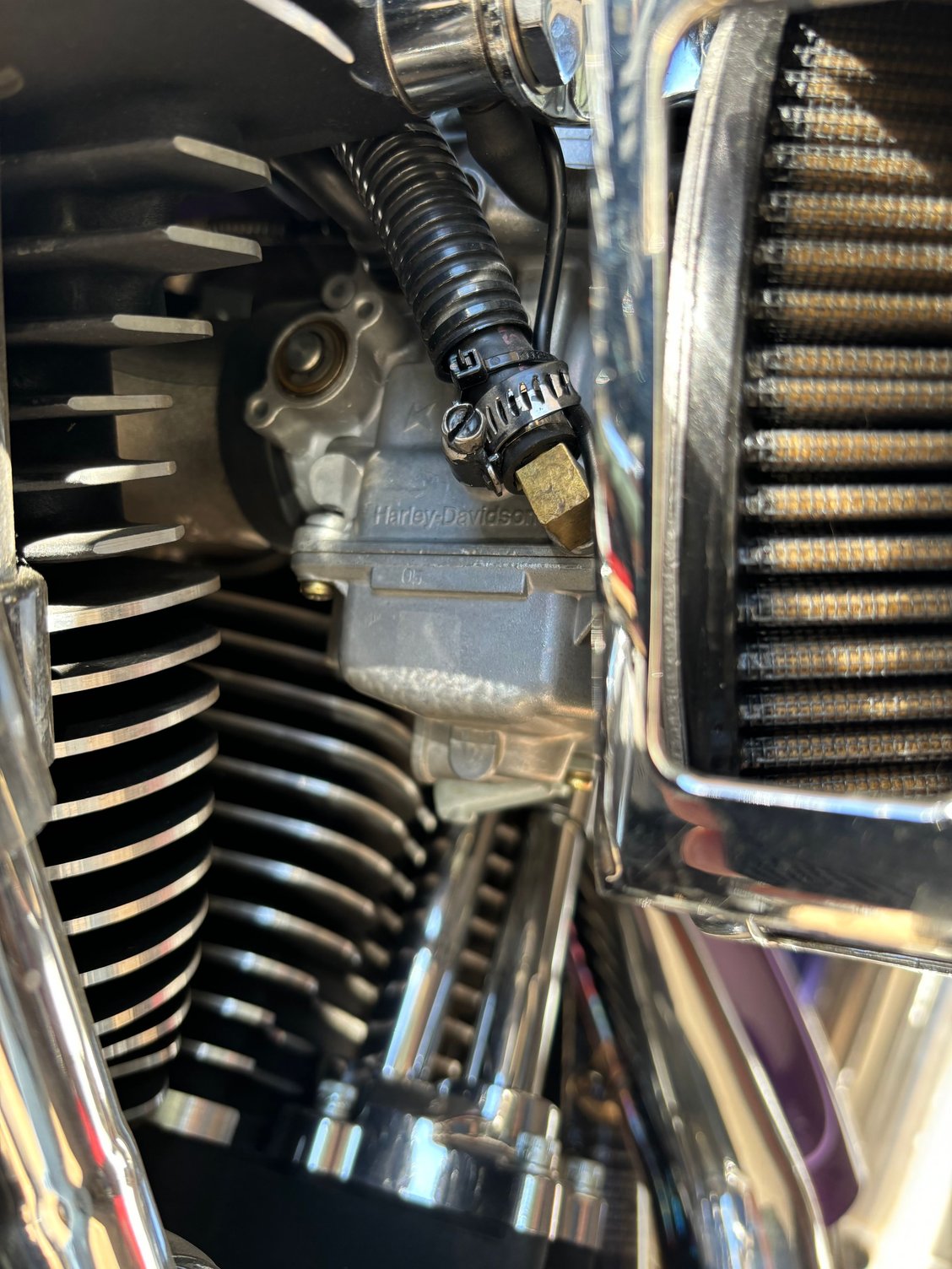

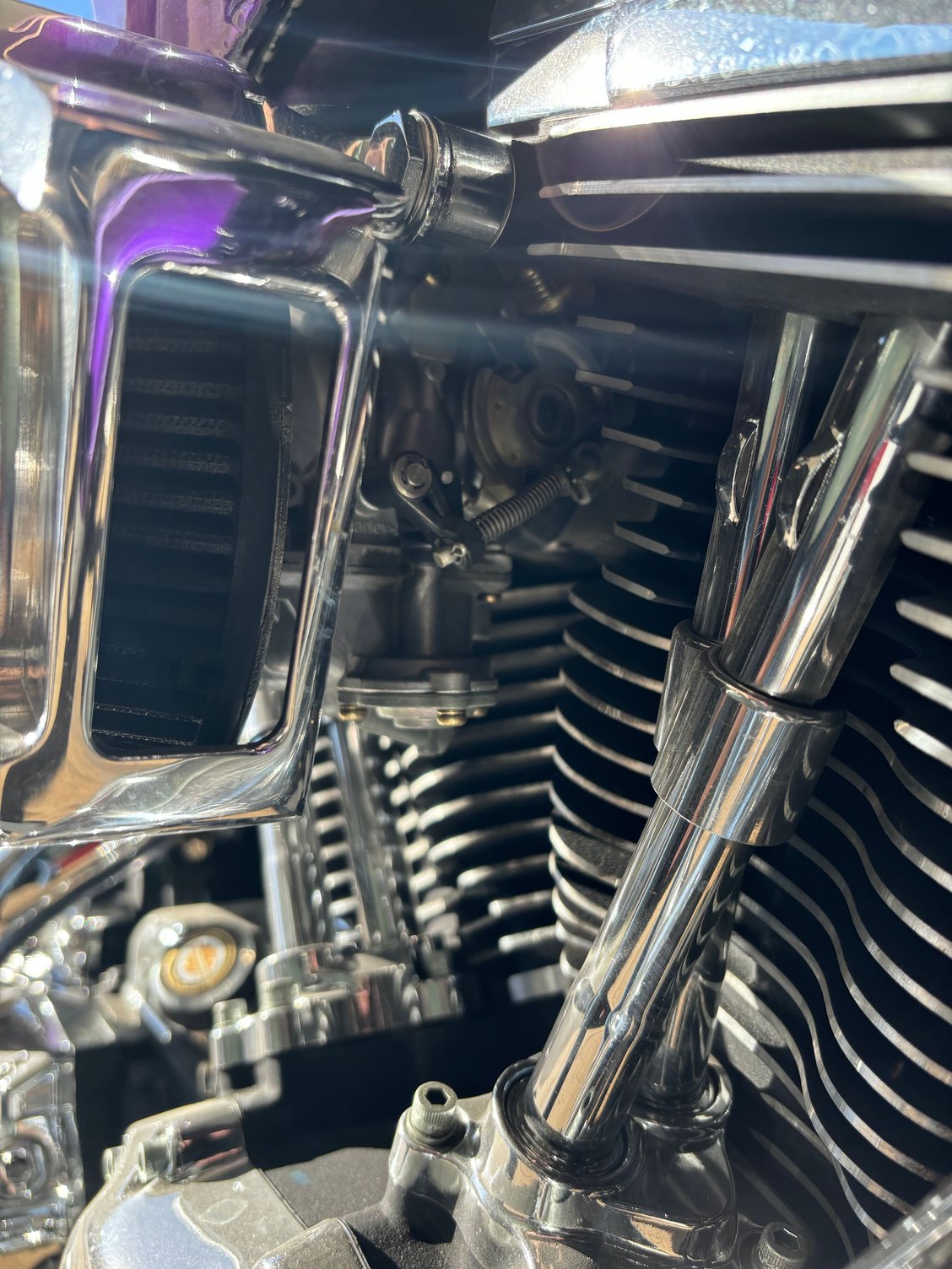

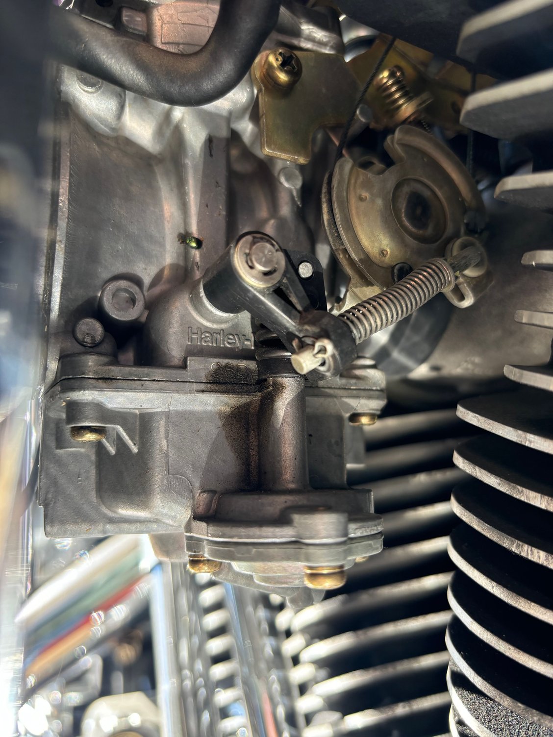

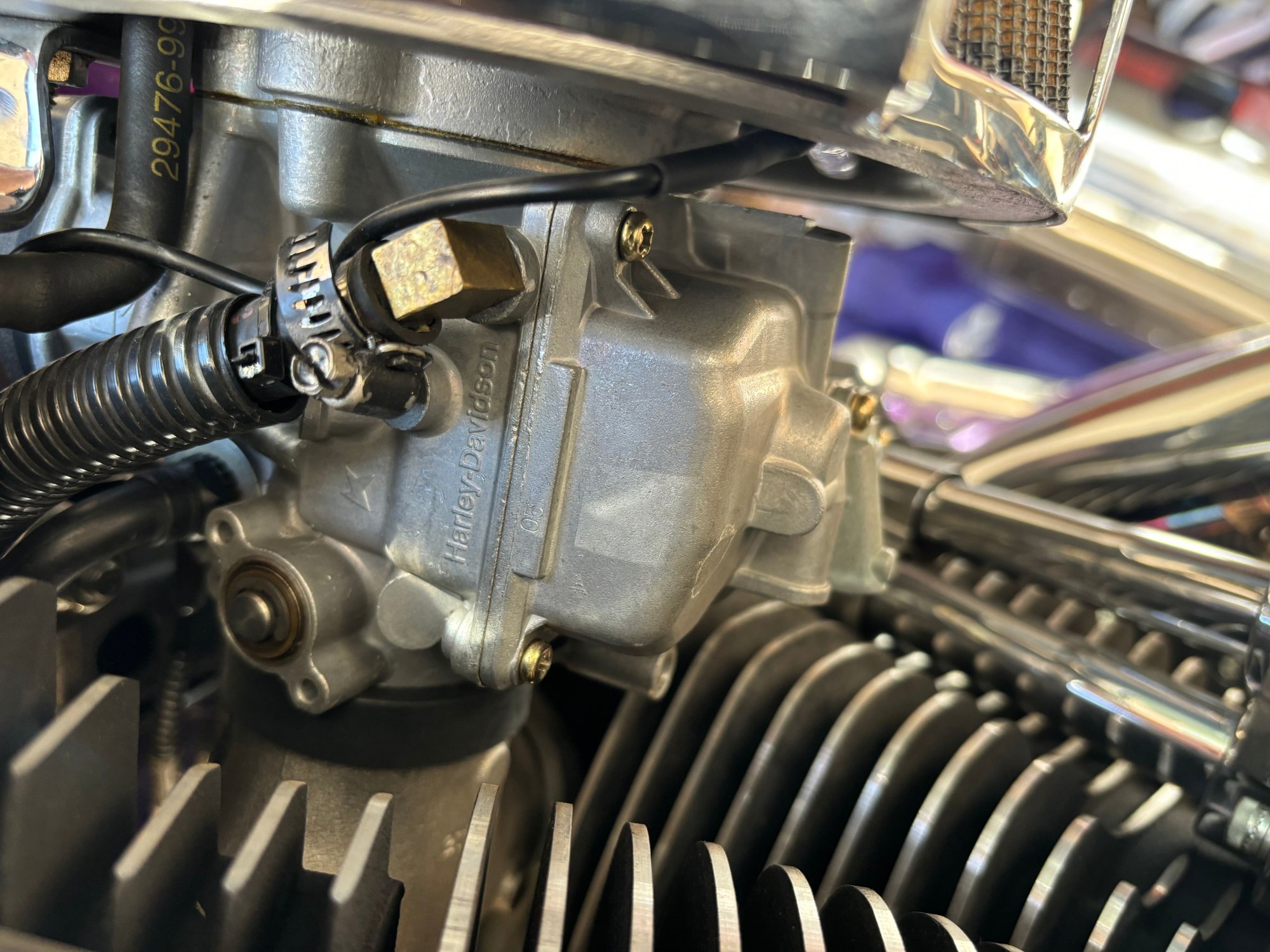

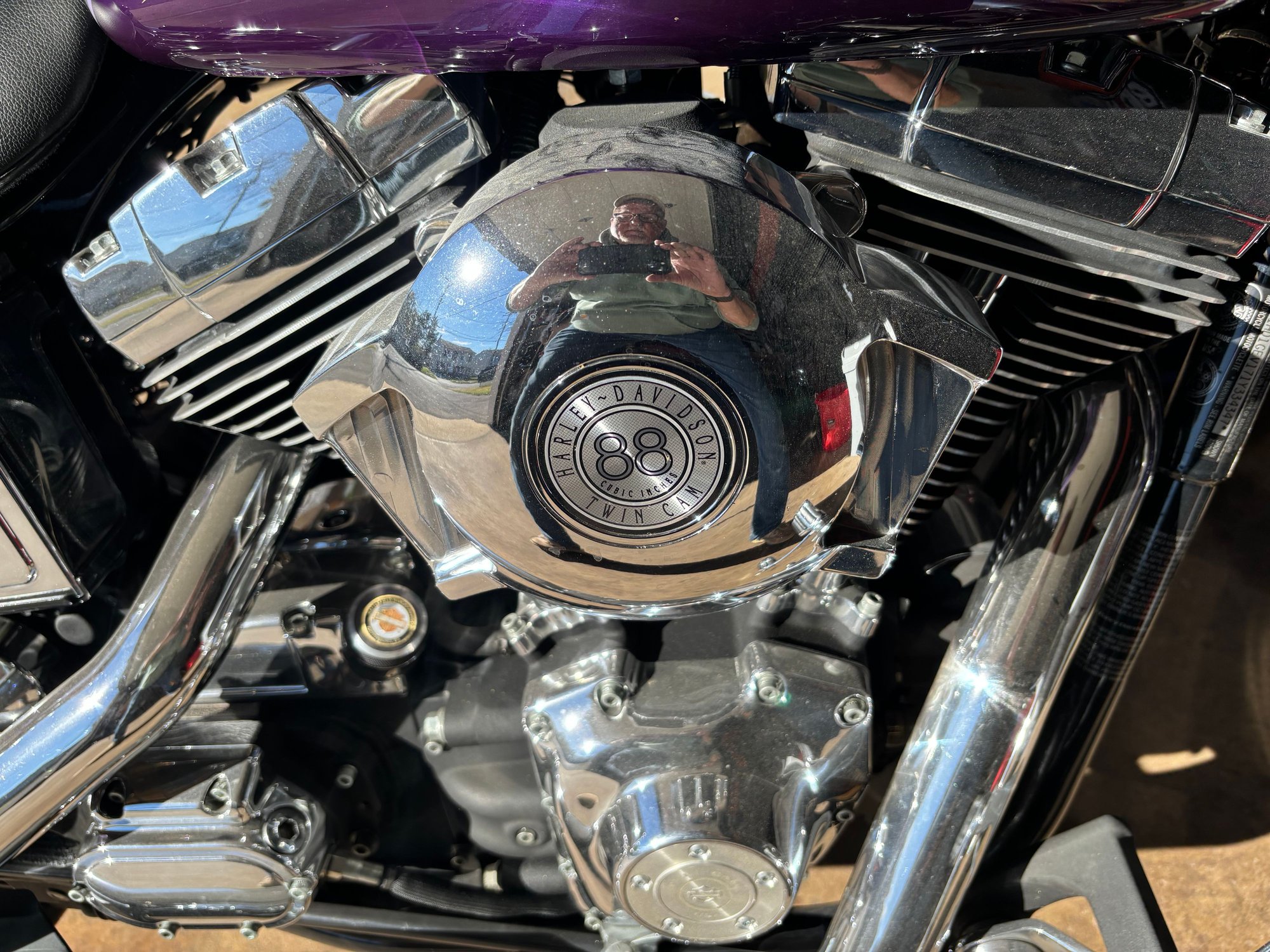

As requested, picked it up today. Runs well, shifts cleanly. Looks fantastic. I snapped a few pics of the carb and jugs best I could without tearing into it. It's a HD carb but I don't see anything SE about it. Wondering if this helps anyone identify what I have?
Old Nov 9, 2024 | 09:40 PM
scooper321's Avatar
scooper321
Joined: May 2012
Posts: 1,388
Likes: 132
From: Baltimore, MD
So I didn't post these pics earlier. And they may hold a key. To my novice eyes this does not look like the flatside carb kit on stage II and III TC88 builds. It DOES seem to resemble the SE 44mm CV carb (27934-99). And the bigger bore jugs and heads this is definitely a 95 build. You can hear there's a cam in there - the SE kit would be a SE257 but won't know for sure til I open it up. Hopefully I can see that when I do can chain tensioners. So I think what I have is a higher compression 95 build. Still a lot of unknowns, but a couple answers...
The stock CV40 and the CV44 look identical from the outside, but I think the 44 required a larger intake manifold, that will have "Screaming Eagle" written on top. Or you can simply remove the airbox cover and measure the throat diameter.
Good tip. I’ll make sure to do that.
Would someone keep the stock CV40 on a big bore (95) build? Would the 40 handle that upgrade?
Old Nov 10, 2024 | 09:18 AM
sharkey's Avatar
sharkey
Joined: May 2007
Posts: 3,870
Likes: 499
From: Alberta
DEFINATELY keep the 40CV on a 95" upgrade. A 44CV is nicer, but not necessary. I've used the 40CV on 95", a 44CV on a hot 1200 XL (100hp) and a 51CV on a hot 103. All stock carbs with appropriate factory jetting.
Your going to hear a lot of opinions, but friends and I have done a few 95" builds and you can achieve 100HP with an extremely durable engine (As mentioned before, FORGED crank and timken bearing)
I sincerely believe "upgraded" carbs are an upsell, especially from independents. I've challenged dealers to dyno JUST the carb change and had NO takers...but you'll get LOTS of "butt dyno" opinions about how much better the bike can run. Face it; not many would spend hundreds of dollars and ADMIT it made no significant difference.. Also avoid like the plague any aftermarket CV trickery. Stock carb with factory available jets is ALL you need. There are NO miracle $20 parts...JMO
Beautiful looking bike, BTW
Old Nov 10, 2024 | 09:21 AM
rigidthumper's Avatar
rigidthumper
Joined: Jul 2007
Posts: 3,741
Likes: 8,538
From: Bates County MO
The 40 is good for about 100 HP max, so back then, adequate for most mid-range builds.
I don't see any indication of SE heads, nor compression releases, so I'm thinking a BB with mild cam.
We used to do a ton of 95" BB kits with SE204 cams and rejetted stock carbs, which would almost always make 90+/90+ with excellent street manners and economy.
