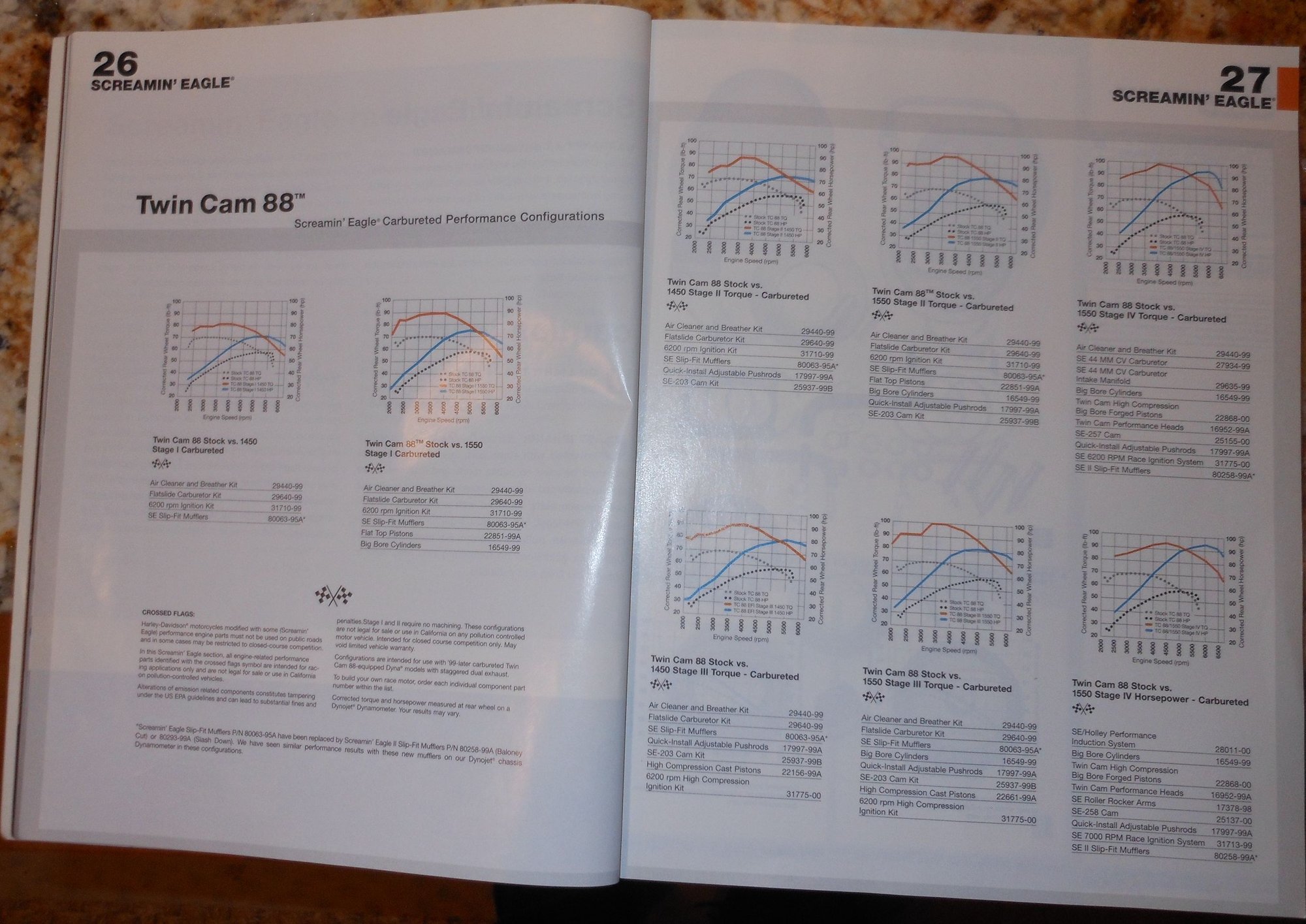

There are nine other various "Stage" kits from Stage II, Stage III, Stage IV and Stroker kits
Four of those Kits use SE204 cams. Edit: "Four of those Kits use SE203 cams."
Two of those Kits use SE257 cams.
One of those Kits uses SE211 cams
Both Stroker Kits, bumping the 88" to 103", use the SE260 cams

Originally Posted by Rounders
I wonder if you did harley catalogue 2001 pdfs if you could find any out there?
Do you mean the 2001 Parts & Accessory Catalog Stage kits offered....?
Per my 2001 Harley Parts & Accessory Catalog, there are :
Two Stage I kits, neither with new cams.
Note: One of the Stage I kits is actually a big bore kit (1550), but without new cams. So I guess that's why they call it a Stage I...
Two Stage II kits, both with SE203 cams
Two Stage III kits, both with SE203 cams
Two Stage IV kits, one with SE257 & the other with SE258 cams
There were no Stroker Kits in that catalog.
