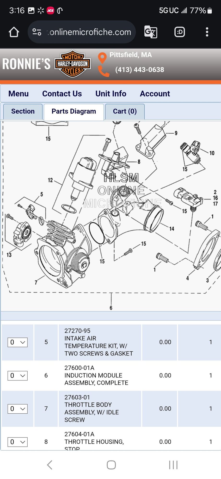

........DenaliDyna, does the mouth of your throttle body look like this last picture. .

........DenaliDyna, does the mouth of your throttle body look like this last picture. .[/QUOTE]
Everything is stock and my throttle body is the first picture on top
